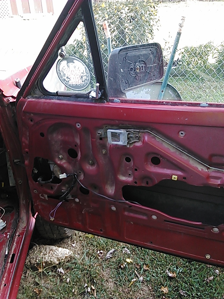

Well I have always been able to search long enough here to always fine my question until now (and it still my be here somewhere)... What determines a 4runner to have wing or solid glass door windows? I have a 85 with manual roll up and solid glass, 86 with wing windows manual roll up and a 88 with solid electric.... Did they ever make a wing window door with electric? Can I gut my wing door and put solid electric in it or would it be be better to just paint the solid glass door? Thanks in advance for your reply

Great! Thanks guy's for your replies, So it is possible to have wings with electric windows... I really like that... Having your cake and eating it to. Now to just fine them...
