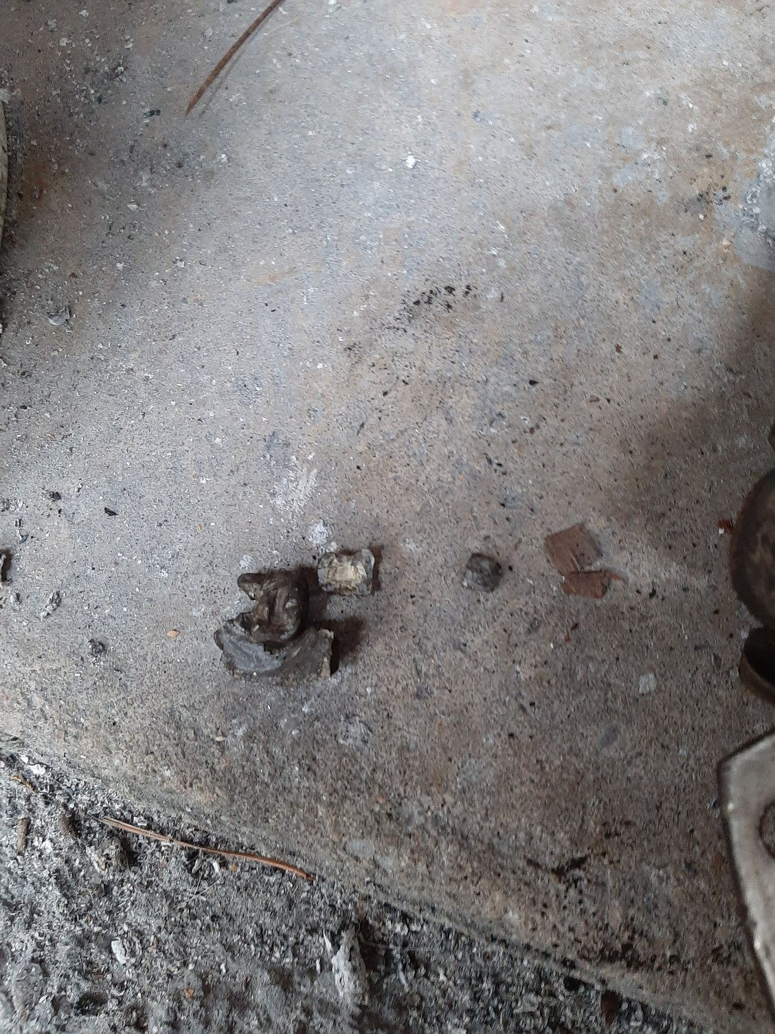

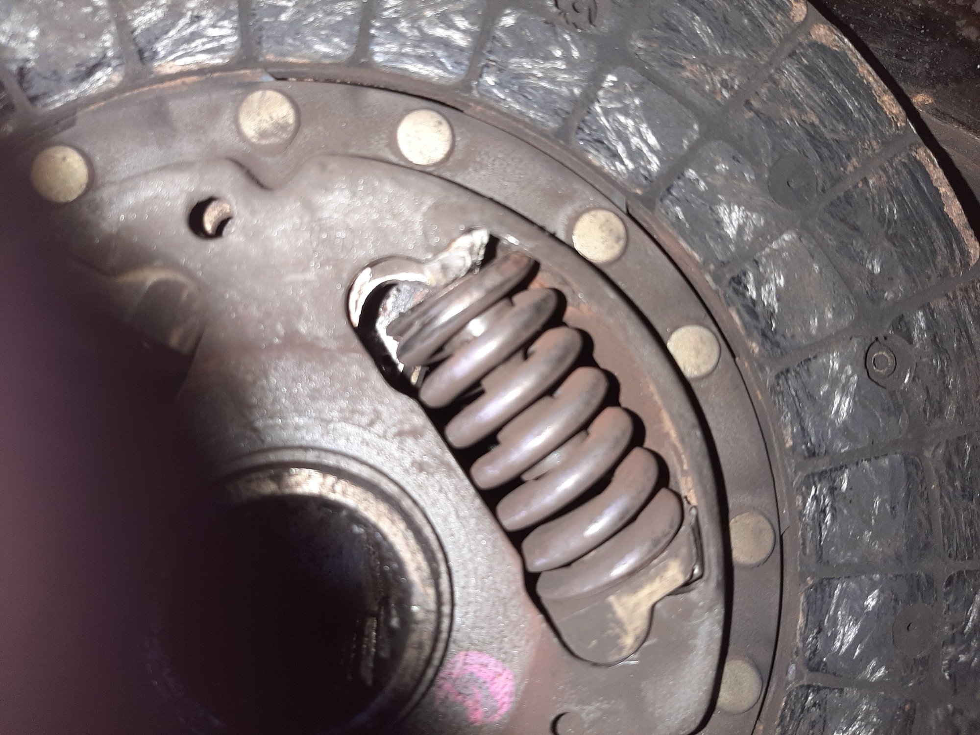

Had a similar issue a couple of years ago where I couldn't shift while the engine was running but fine when not running. Turned out to be that one of the springs in the clutch disc let loose, the mount gave out. Clutch had approx 150000 miles on it.

There is no way to be 100% certain until you tear into it and have a look, but I would bet it looks just like Andy A's picture when you get there and even if it doesn't there is no sense going that far without replacing the clutch, pilot bearing and throwout bearing.
