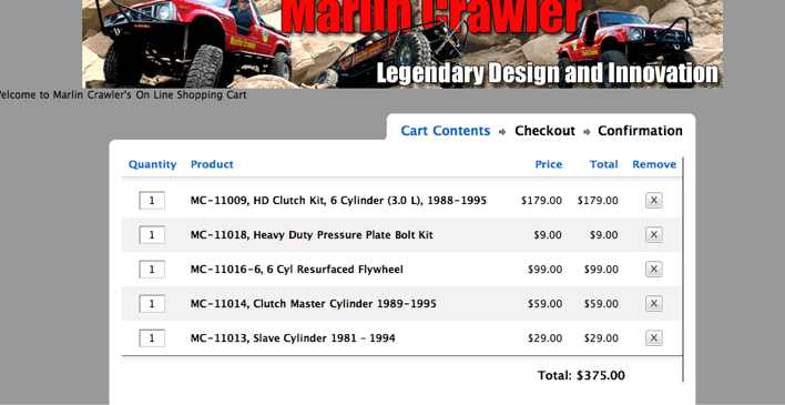

thanks Jay! yes I agree with the 1200lb marlin clutch, the 1600lb pressure plate would be overkill for me, and 1200 is still 300lb more than OEM! So that's the first thing in my shopping cart.
next is the HD pressure plate bolt kit for $9, cheap and 25% stronger than the OEM bolts. sounds like a good option.
as far as the marlin'd resurfaced flywheel it looks like I would have less downtime if I got that at the same time as the clutch, plus it looks like they are specially surfaced to get the best from these clutches...they cost 99 which might be kind of expensive if my current flywheel is fine. but after almost 250K it may be trashed I simply do not know
I am wondering whether it is a good idea to replace the master and slave cylinders at the same time if getting this job done, seems like marlin sells them all. is there any point to replacing them as far as performance goes? he is charging 59 for master and 29 for slave. his prices seem pretty reasonable so far

Does anyone happen to know any marlincrawler coupon codes? there's a place to enter them on his site, do we have one for yotatech or is there one floating around the web? it looks like my shopping cart is going to be $375 total for a complete clutch rebuild including new flywheel, master and slave cylinders and heavy duty bolt kit, not too shabby but would be even sweeter if I could snag a coupon code I love those things
