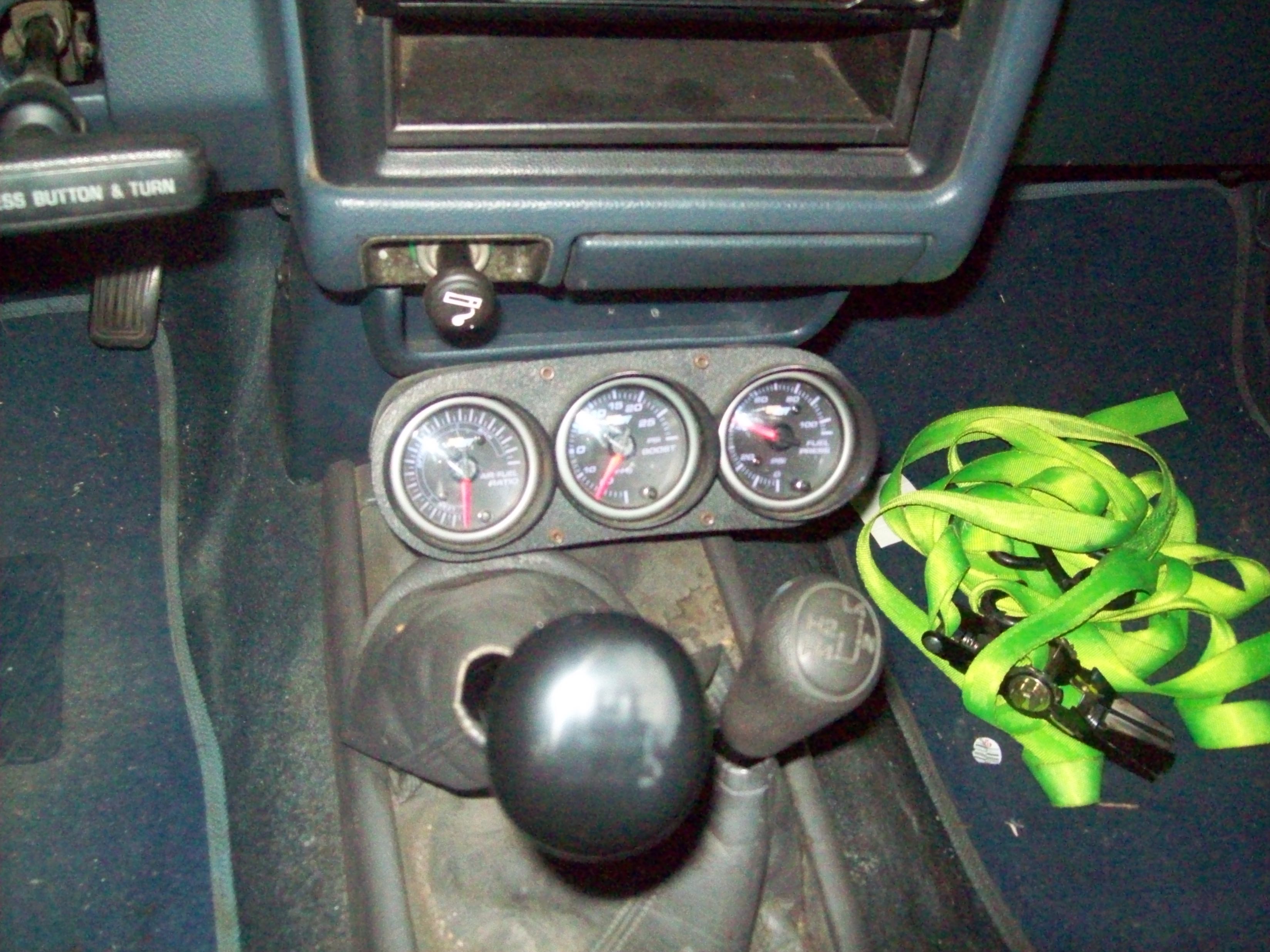

Ok So I just read this again. You have a needle Air Fuel Ratio Gauge? in use with a normal (narrow ) band o2 sensor?? where did you get it and how did you set it up? Just splice one of the o2 wires? pictures please
and thank you, because I think you just saved me a bunch of money
Old Dec 11, 2013 | 05:10 PM
  #68
Punchy's Avatar
Joined: May 2012
Posts: 591
From: 91765

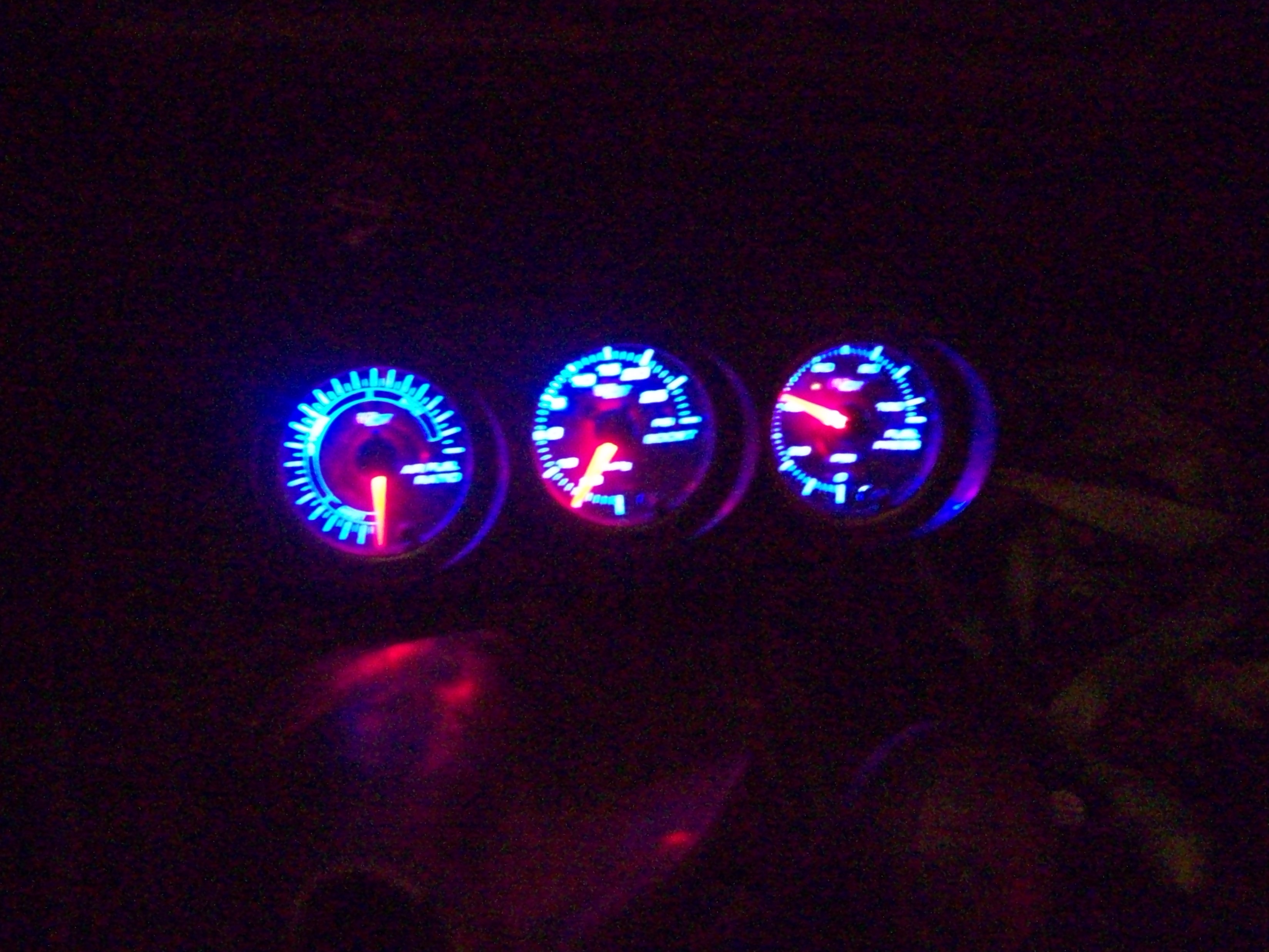

If you mount the gauge in cab you can run the gauge sensor wire through the firewall (drivers side or passenger side depending where you mount the gauge)
and run it to the test port near the battery and plug it into the OX1 tab.
If you accidently put that wire in any of the other tabs (other then OX2)you will toast the gauge instantly.
http://www.glowshiftdirect.com/black...tio-gauge.aspx
Cluster setup AF-Vac/boost-Fuel Pressure.
Attached Thumbnails Wideband o2 sensor?-100_0358.jpg   Wideband o2 sensor?-100_0359.jpg

you are running that into the diagnosis port box?
