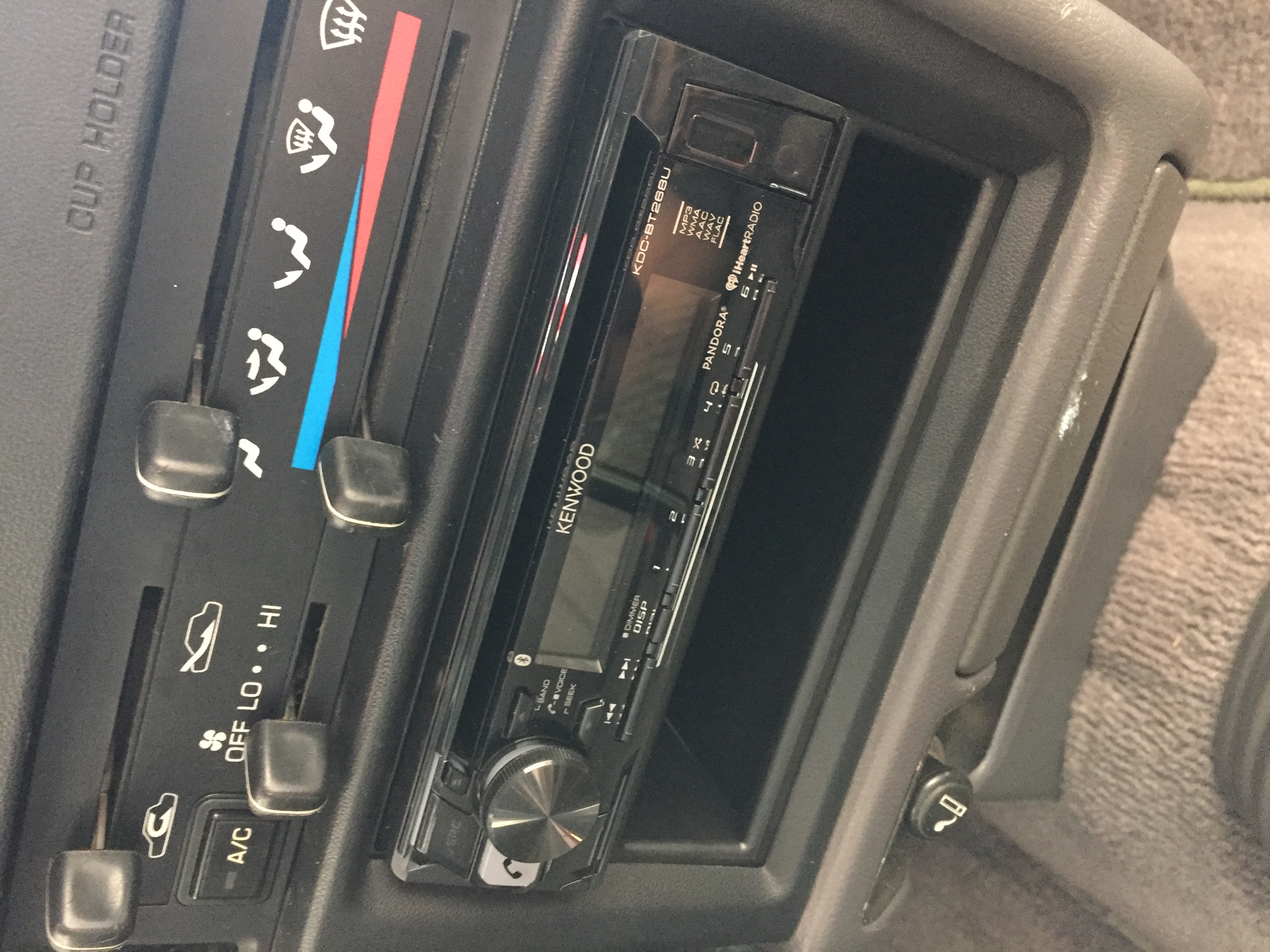

I did the same thing and bought a new kenwood single din head unit. I was just wondering what wire do I buy that would run from the Head unit to the speakers. Thanks

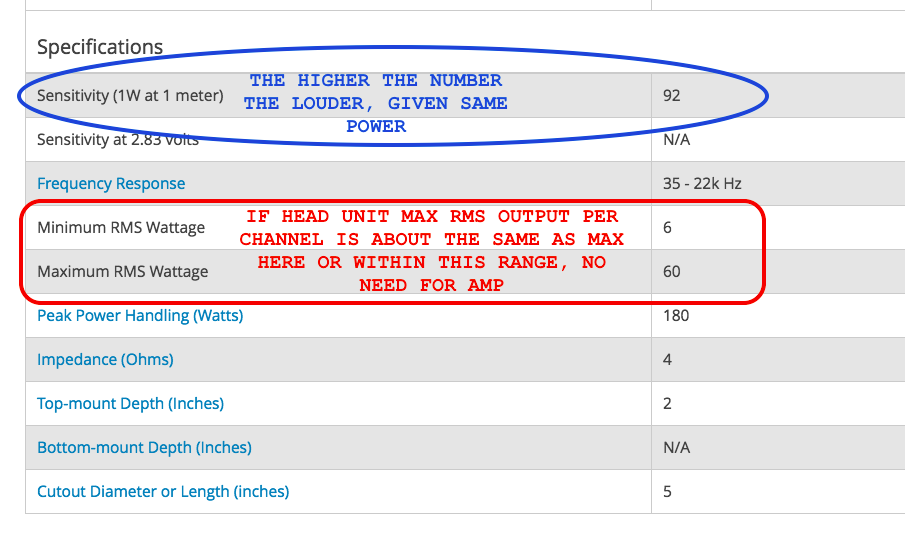

New head unit makes sense. Aside from freeing up space, you get added safety because you can link your smartphone to its bluetooth- instant hands-free calling over the speakers; automatic muting of music when you're on the bluetooth senses phone is being used. Simplifies playing music from your phone, too. No need to connect an auxiliary cord, although that remains an option.
Re: wire... AWG18 speaker wires will suffice. On mine, wires for the rear speakers run under the dash, to the kick panels, then under the door threshold, then into the rear panels.
Re: Amplifier... If you're not into a fancy system, just find speakers that more or less match the per channel output of your head unit and you should be good to go without an amplifier.

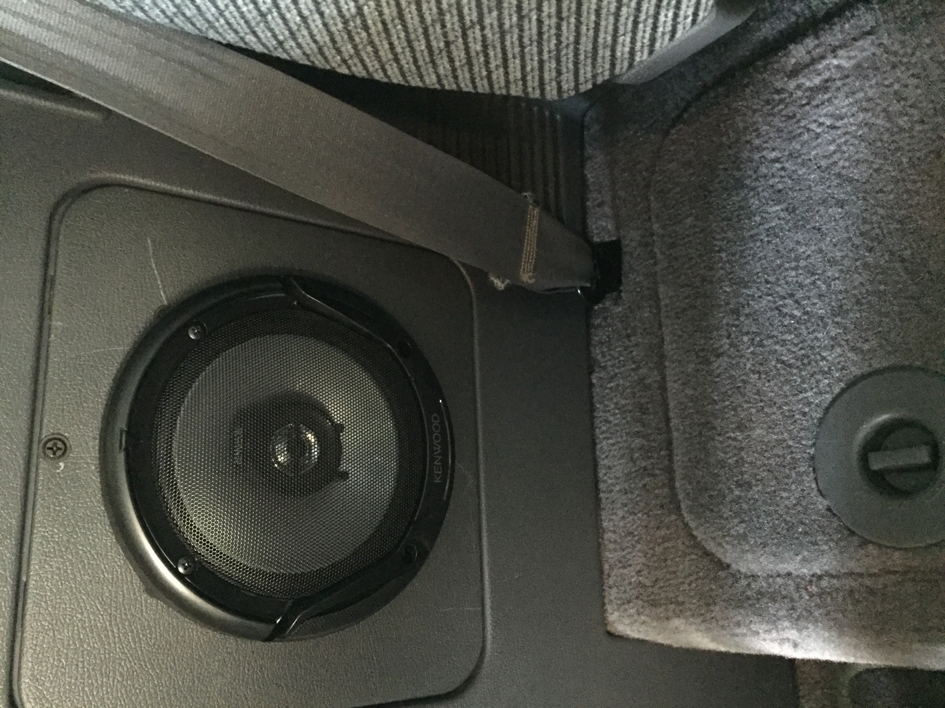

I just finished my setup. Kenwood single din head unit, 4 inch lightning audio fronts, and 6.5 inch Kenwoods in the rear. Sounds good for minimum money spent.

Originally Posted by N_Aviles
Rear speaker
That's nice, what did you use to cut the holes on the covers for the rear speakers?

Initially cut a 1 inch hole with a hole saw. Then progressively opened up the hole with a grinder.

Mine still has the latch. I placed the speaker high enough to cover it.

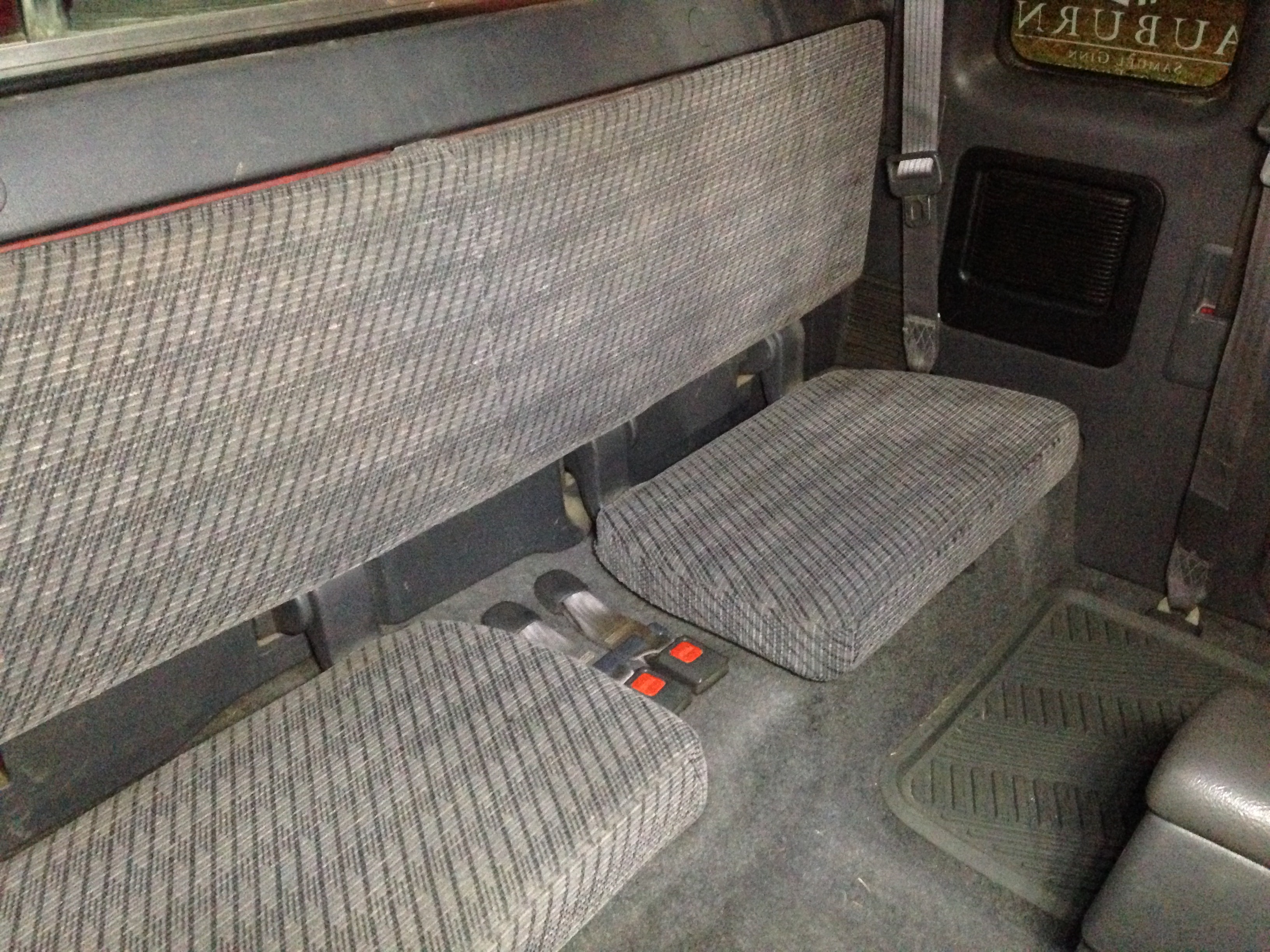

It's crazy that I've never seen another XtraCab in person that wasn't like my '94 DLX 4x4 22RE (5 speed) as far as the rear speakers go, cause my truck came with them. Kinda strange considering it had the lower spec gauge cluster that doesn't have a tachometer, oil pressure gauge, voltmeter, etc, whereas N_Aviles's truck appears to have been oppositely equipped (at least as far as the rear speakers and gauge cluster goes).
I swapped out all my blown stock speakers for new Kicker 4" and 6.5" models from Walmart right when they decided to stop selling them, so the remaining ones in store were marked like 75% off and I ended up getting them all for around $25 I think. I think one of the biggest improvements I made was the addition of SR5 front speaker enclosures/boxes that I got from a 4Runner in the junkyard . I've yet to see a 4Runner in the yard that didn't have these, since SR5 trim was far more common than on the pickups. They bolted right in and required no modification to use, which was nice.
Replaced the headunit with an extra Kenwood I had, and recently a nice JVC that was given to me. Added an extra 10" woofer and amp I had in the attic to the storage compartment under the rear seat. Never made a subwoofer box or anything before, but making this lid out of MDF was pretty easy, even with going the extra step to sink the woofer in flush so that the seat could still be folded down flat and be used just as well. Works perfectly since the amp is underneath, in that storage compartment, thereby keeping all that crap out of the way for hauling MX gear on the back seats. Always thought that a separate sub box looked like the most irritating space hog for a non-enormous vehicle's interior.
Do you know if your subwoofer is ported or sealed? I was thinking about putting a subwoofer under the seat

Originally Posted by kaleb2136
do you know if your subwoofer is ported or sealed? I was thinking about putting a subwoofer under the seat
I didn't know they ported some subwoofer speakers, if that's what you're saying, but this one is just a 10" Rockford Fosgate Prime R1 so I assume it's a pretty standard issue low-end woofer. As far as the lid goes, I made it with no port hole or anything. I keep the passenger side lid on all the time, and the 2 compartments are connected through narrow section underneath the front edge of the lower seat cushions (when they're folded down). I planned on working out some way of fastening the subwoofer lid down to the storage compartment -- preferably something quick and easy, but I never got around to it since testing the subwoofer to see what it sounded like sorta turned into just leaving it as-is haha. I love the way it sounds though, and it was certainly a radical improvement over how it was without a subwoofer.
