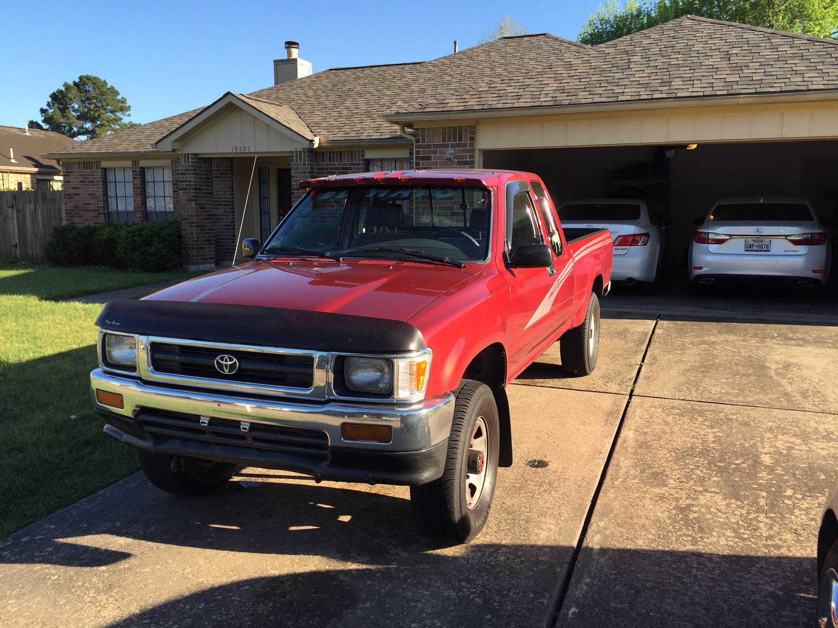

So I picked it up about 2 weeks ago. It was so cool to the the truck I grew up with for the first time in about 8 years. I had to drive it from Jacksonville to Houston, stopping overnight at a cousin's house in Mississippi. The drive back was uneventful, but I knew the truck was going to need some attention once I got it home. It was getting bad fuel economy (16-17mpg), check engine light was on, the brakes pulsated like crazy and it had a bunch of little things needing work.
OK so once I got it home, and a tech and I got a good look at it, we started wrenching. The list is as follows:
Full tune up
Cap, rotor, wires, plugs, fuel filter, air filter
Oxygen Sensor
EFI system cleaning
Windshield washer pump
LR Mudflap
LF seat recline handle
Shiftknobs
Wiper blades
AC evac and recharge
Balanced the tires
All new front brakes
4runner calipers, rotors,
new hoses
grease seals, repacked bearings
Brake system flush
Diffs, trans, and trans case fluid changed
engine oil changed
Power steering fluid flushed
Coolant flushed
New rear shoes and drums
new efi temp sensor
stuff needed
new tie rods and alignment
rear pinion seal
pass front axle seal
new shocks(I have some Rancho RS5000's, don't like them)
new tires to go with some wheels I got
Tint windows and some other misc stuff
I have a bunch of stuff in a box that I need to install one day
(timing chain setup, TRD cam, etc.)
I love this truck, for sentimental reasons. I hope to get the mechanicals done and start maybe restoring the body

Do any of these things address your CEL?

The CEL code was for the oxygen sensor. Yep, no more CEL

It is good condition considering the age and where it's been its whole life but it does have a lot of dents, dings and scratches. It also has been overloaded at some point and the drivers side bed wall is bent away from the tailgate a little. Also has a rust spot by the exhaust on the bed. I also want to get rid of the visor, and weird hearse handles my father installed years ago lol

Its lookin good. I like the sun visor for the windshield. Your neighbor looks like theyve got a couple yotas as well

If you pull the sun visor for the windshield, it's a Lund brand and it has the desirable lights in it. It has a fair value, somewhere around $200-250. If you don't want to deal with shipping a huge object like that, just the light caps have good value (out of production last I checked).
I've seen a few Toyota's with those cab grab handles, seems like it was fairly common on the 1 ton and camper models. Not sure if it was a factory/dealer option at the time, or just people just happening to install the same brand of part.
That O2 sensor would likely be the main cause of the poor MPG, hopefully you're seeing 20s+ now =).
I parted out a truck that looked exactly like yours except rotted out and passenger door was caved (broke the glass and all). I pulled up a pic of it, and the stripes are extremely similar but backwards lol. Pretty sure it was a 91.
Link to pic (so i'm not throwing this ugly thing on your thread ). https://i.gyazo.com/157592e7b2c299be...3e1723a8c3.jpg
Good luck with the restore!

I'm waiting to bite the bullet and get all the body work done. When I do that the handles and visor are coming off, as I have to fill the holes that would be left behind. Yep, same truck pretty much.
