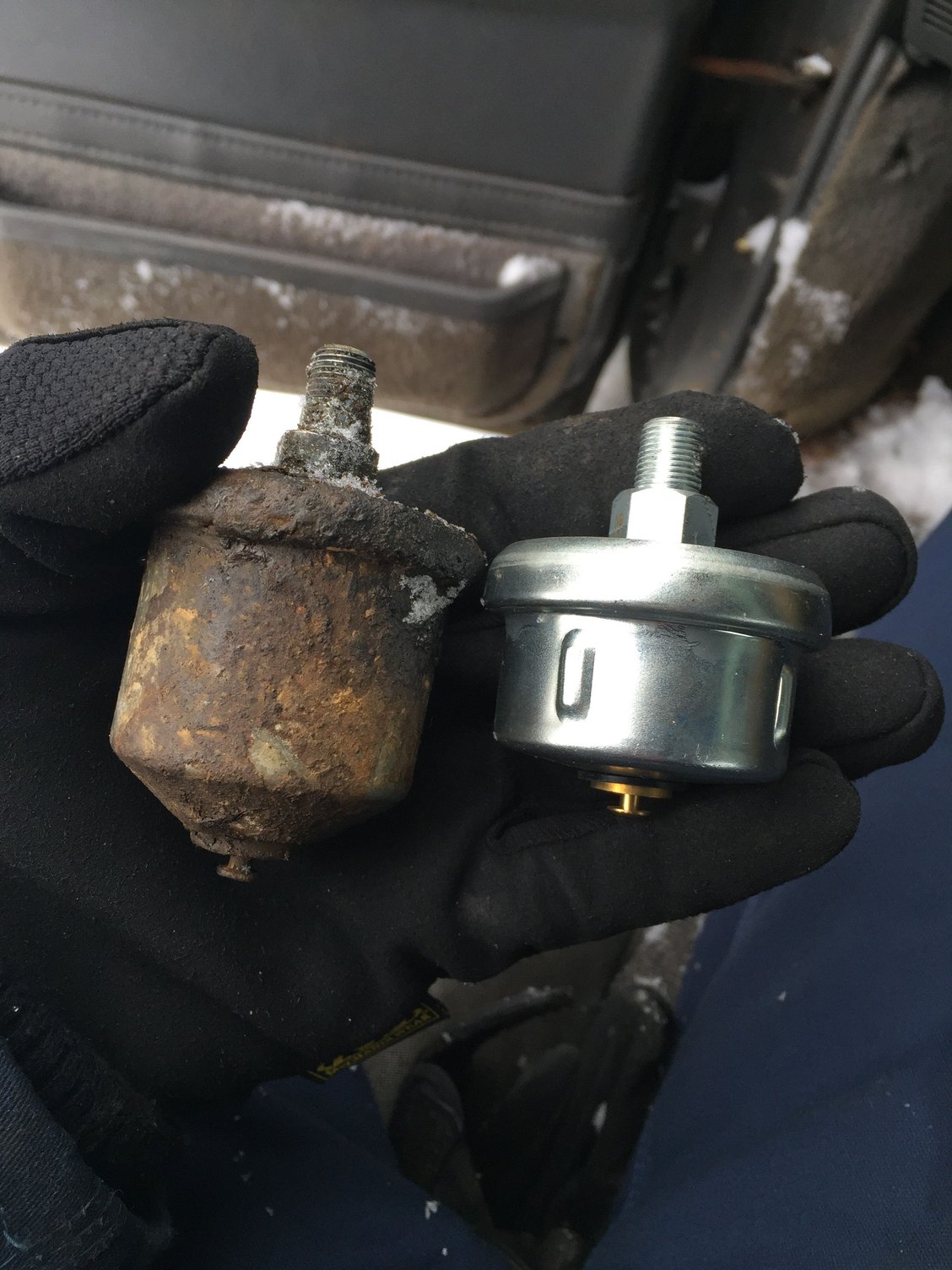

Here's a side by side. The threads are the same and the connectors are the size, they're just different sizes.
Old Jan 23, 2016 | 07:51 AM
FinallyOffRoad's Avatar
Joined: Jan 2016
Posts: 94
From: Southwest VA
Nope. The sensor is too short and the plug can't reach it. Oh well. I don't even know if the old one is bad.

You think it's okay that the new one is much shorter than the old one? It won't send wrong pressures or anything? Even to the old sensor, the wire is pretty tight, so I wouldn't mind lengthening the wire regardless.

Originally Posted by MudHippy
It looks pretty bad. ....
Oh, I don't know ...
Originally Posted by scope103
... Do you have a gauge or light? ...
Which is it? If you have a gauge and use the sender for the light, it will wreck the gauge.
Beck Arnley says 201-1649 for the gauge, 201-1798 for the gauge (I used 1994; I don't know your year and it might make a difference on the plug.) Beck Arnley says "nope" to KG-1102. http://www.beckcatalog.com/
If you have, oh, an '88, RockAuto calls out a Beck Arnley 201-1130 (for '92 and earlier) IF you have the light.
