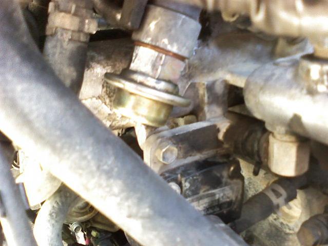

i have a fuel leak and its an excessive drip while the engine is on, and its comin from this thing, and i took it off and it has a crush washer on it, i think its copper, not sure, but ive been to 3 hardware stores and 2 auto stores and nobody has any washers like it, so hopefully someopne here knows what it is so i can get the washer from the dealer, i cant identify what the part is called though, ive looked through the fsm but i havent been able to find it.. its right in the middle of the picture, its attached to the fuel rail and right below the throttle body.. its an 86 4runner 22re..

can't tell for sure but it looks like a fuel pressure regulator. The copper washers usually go to the fuel fitting and are not recommended for reuse. Time to get new ones. I'd hit the dealer for that one.

thats what i originally thought it prolly was but unless they changed the design of it from 86 to 93, it isnt.. according to the fsm it should look like this.. http://personal.utulsa.edu/~nathan-b...30fuelpres.pdf i just need to know the exact part name so i dont just order the wrong washer..

That`s the fuel pulse damper.

On my '94 6cyl, the crush washers are aluminum. You can buy copper crush washers (e.g., Harbor Freight), but they're for brake lines. Whether copper or aluminum, they are definitely one-time-use (yes, even I have re-used one, but I know I'm just asking for it). The are not expensive from the dealer.
I'm pretty sure (as well) that you're looking at the pulsation damper. Why don't you just take it into the dealer; they may have the washers in stock and you can see right there if they fit?

I reuse the pressure damper washer all the time. It must be damaged/gouged if its leaking.

thanks.. hopefully the dealer has some in stock, got a two and a half hour drive to san diego tomorrow.. and its pretty much shot, i tried flippin it over a week ago and it helped drop it to about a couple drops a minute but its started back into a near stream and its killin my gas mileage and i would prefer to not have flames shootin out from my hood..

i just replaced my damper because the set screw at the end had fallen out and fuel was leaking out of it. i could not find a gasket for it anywhere that would fit so had to order it from the dealer and wait a week for it. it cost 1.25. i would have reused it but i tried to use a napa damper and the original gasket did not fit it the same way and i damaged it. ended up having to get the toyota damper.

actually, suprsingly, i do live ten mins away from the dealer.. ' and my dad taught me that trick years ago, problem is that i recently moved out and my dads got all the cool toys, i just have my big craftsman set.. but luckily the dealer had one in stock, $1.75.. peace of mind at last.. When I get back ill order another one cuz im sure this problem will arise in the future..

and its still leakin.. im thinkin it might be the washer up above that one after lookin at the diagram, but seein as i dont have time right now to take it apart and take a look, itll jus have to wait till tommorrow..
