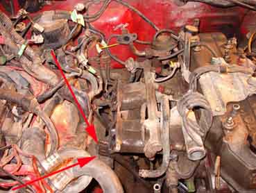

what does this pipe attach to?

pic is real low quality and hard to tell, but it looks like it might be the intake runner support that runs from the runner to the block.....

bolts to the bottom of the intake chamber. i'll post some pics if you need.

mine must be really bent or something... i could not see how it would attached to the intake chamber... but I thought it should... thanks for the confirmation...

IIFC, the piece it attaches to isnt in your photo, its the piece that goes on next.

you might have to push the bar a bit to get it lined up with the hole.
