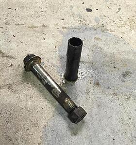

I had the bolt sieze, and had to completely mangle it to get it out of the spring hanger. The bolt is not coming out of the sleeve, ever. They are one.
I've tried ordering the part from the dealer, which was a completely different thing. I'd like to get this as a greasable, if possible. Otherwise, anything would do. Does anyone know where I can find such a thing? (I've attached an image of the one that I was able to get out below)

To further clarify, the part goes here:

Turns out they changed the manuals, and the dealer has a different idea of what "stock" is, from what it really is now.
I believe that I've found the part I needed, and it is on its way.

You did quite good to get that out that easy.
Every time I remove one I need to cut the head off remove the nut cut the bolt flush with the hanger.
Spread the hanger pry the spring out..
Burn the bushing out or just throw every thing in the scrap pile.
I have seen the hardware with grease fittings I hope you were able to find it.

A little late, but all pro sells a greaseable bolt that fits the stock space. You run the bushings without the sleeve. lastly, have to drill out the hole to the correct size. (18mm)
