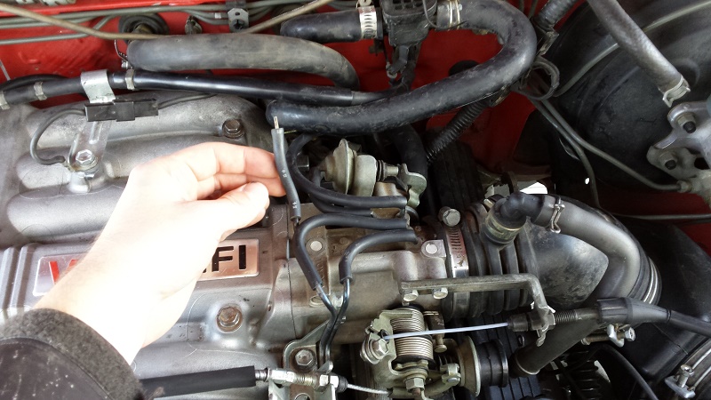

What do these vacuum lines connect to?
I just bought this 1992 pickup at an auction in November. The motor is a salvaged 3vz-e. I am new to all of this and can't find a diagram or pictures with these vacuum lines. Who ever put the salvaged motor just capped the lines with screws. I am having issues with it losing power in higher gears and want to get these lines figured out before i crack into what i think are the causes.

#1 and #2 (same line) is supposed to be capped. It is NOT connected to anything.
#3 is the vacuum line to the AC idle-up VSV. http://personal.utulsa.edu/~nathan-b...23vacuumho.pdf
If capped, neither of them will cause you to lose power. In any gear.

Perfect. That solved it for me. I can move on to the other issues now. Thanks.

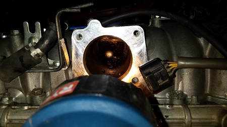

So unrelated to my original post, but my truck just died on Sunday. Finally got around to taking a look at it and took the throttle body off to find a bunch of ground up metal pieces... not my lucky day. What does this mean?
I'm no expert on engines, but i am not a total armature either...but this...I dont know what's going on here...My best guess, you had detonation in the cylinder and it blew chunks back into the intake...The picture is kind of low res so i cant get a good look at it but it doesnt look good.
