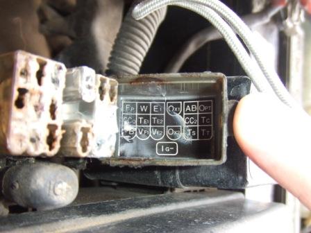

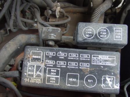

Ok, sorry for confusion on my part. I have never run without it simply unhooked, I have bypassed it at the circuit.
You can try it.. if your up for it.
Im posting pictures to help, but if you go to your dignostic box located on the pass side of your engine bay by your fuse box.. and connect fp+ to +b and see if it runs and drives.
2 pictures. The diagnostic box is the little grey guy.
Just to let you know, my situation was it would not start up or would for about a 1second and die. I eventually narrowed it down to the MAF, tested it with a multimeter and then found a way to bypass it. Not exactly the same, but I hope my test will help you.
I eventually replaced the whole maf, but did drive it for about a month with it bypassed. Had to track one down from a boneyard took awhile where I lived at the time. New ones are hella expensive.
