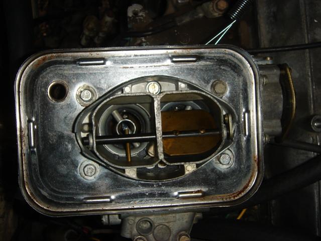

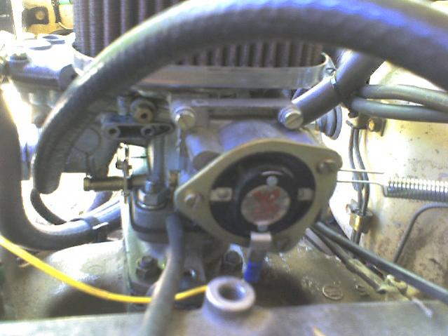

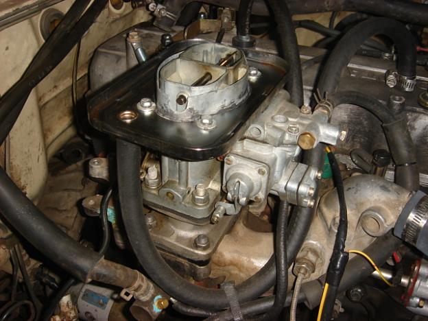

Newer to Yota's (less than a few years), and trying to get drivability issue figured out with my '87 bobbed Yota--your assistance and time are GREATLY appreciated!
Picked up this carb (was told it was a 32/36 Weber) from a fellow Yota wheeler on a run down around Dallas somewhere last year. Had the feeling it was a Weber rip off (China?), but not sure. Installed it, but having some issues with a midrange issue--truck will pull through 1st, 2nd, and 3rd gears great, but when it comes to 4th, it starts to bog bad as you press down on the gas. IF you slam it to the floor, it will come out of it and do fine, but otherwise will stutter and stumble til it nearly dies (at which point I let off!). Also seems to have a lack of power when going up hills on the road.
Been fighting ignition issues as you can see from my other post, but I am doing my best to find a manual for my carb so that I can continue to trouble shoot these issues...still not sure if it's fueling or timing. If any Yota vets have any suggestions on the model of this carb (I will try to get better photos if needed), Pleaseeee let me know so I can find a manual! THANKS~!!

can you take the air cleaner off and take a pic so I can see the choke plates?

to me this looks like a 34/34 progressive carb which is a solex carb, china made I believe, not realy a true weber. Notice the tee shaped fuel inlets where the real webers are a v shape. And also the difference in the chokes.

I think you're right!!! Too dark tonight, but I'll get a photo of the choke plates tomorrow to confirm what you're thinking....
I'll have to do some digging on google for Solex...not familiar with the name/brand at all, but by appearance it seems you're right on! I've always wondered why my "Weber" (it even has Weber stickers similar to the ones shown in the post above on the true Weber) had a Tee fuel inlet and the others were wyes.... Man..China even ripped off Weber's stickers...crazy!
Anyways, anyone having any luck running these China carbs or should it be ditched for a true Weber to avoid future problems? I don't have anything against mine yet, just need someone in the North Texas area to school me on how to tune it!! Thanks!
