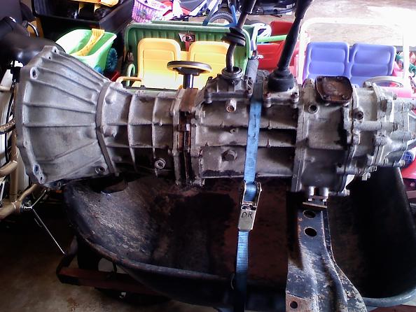

I got an 85 transmission & T-case that I bought. But it’s not the same as my 88 and i do not want to butcher the interior. Want to trade?
Old 10-19-2009, 08:26 AM
jaxrunner's Avatar
Join Date: Dec 2008
Location: Fleming Island, FL
Posts: 21
Received 0 Likes on 0 Posts
pics
here are pics of the tranny
Attached Thumbnails W-56 transmission compatibility-trans-1.jpg   W-56 transmission compatibility-trans-2.jpg   W-56 transmission compatibility-trans-3.jpg
so long shot but what happened to it
