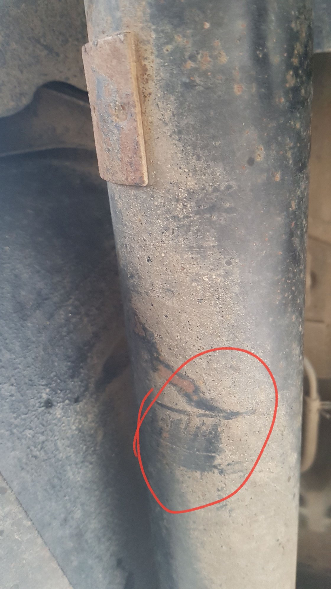

I drove the truck today around town and I shakes pretty heavy even around 35-40 mph, I feel it through the steering wheel and the gear stick, is this related to the u joint problem?
Can this highlighted area be a fallen balance weight?
Old Feb 13, 2019 | 09:10 AM
beef tits's Avatar
Joined: Feb 2019
Posts: 52
Likes: 6
Either way, you should get it rebalanced after replacing the U-Joints. I would just have a shop rebuild the whole thing with a warranty. Be sure they use fittings with zircs so you can grease the joints.
