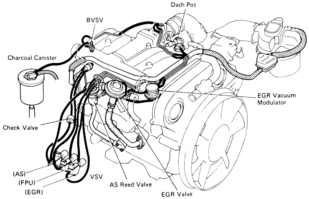

i dtermined that its def not timing and that my gaskets are all good. so i began trying different arrangements of the vac hoses that spagetti the pass. side of the plenum. i managed to clear up the gurgling sound but its still not running quite right.
anyone have a diagram of the vac hose arangement?

I'm betting the PAIR system is leaking

a Simple search yielded so:
http://images.google.com/imgres?imgu...%3Den%26sa%3DG
Old Apr 3, 2009 | 09:15 PM
abecedarian's Avatar
Joined: Mar 2008
Posts: 12,723
Likes: 6
From: Temecula Valley, CA
Old Apr 3, 2009 | 10:04 PM

hm. Thats funny lol. Better look at the vacuum diagram. I would have posted the picture myself, but for some reason I can't access my Photobucket page

my apologies. turns out i forgot to connect the main vacuum line to the pair reed valve and thats what was causing the noise. i'll tell you one thing, its a lot easier to connect when the plenum isn't bolted down.
cheers for all the trouble shooting help boys!
