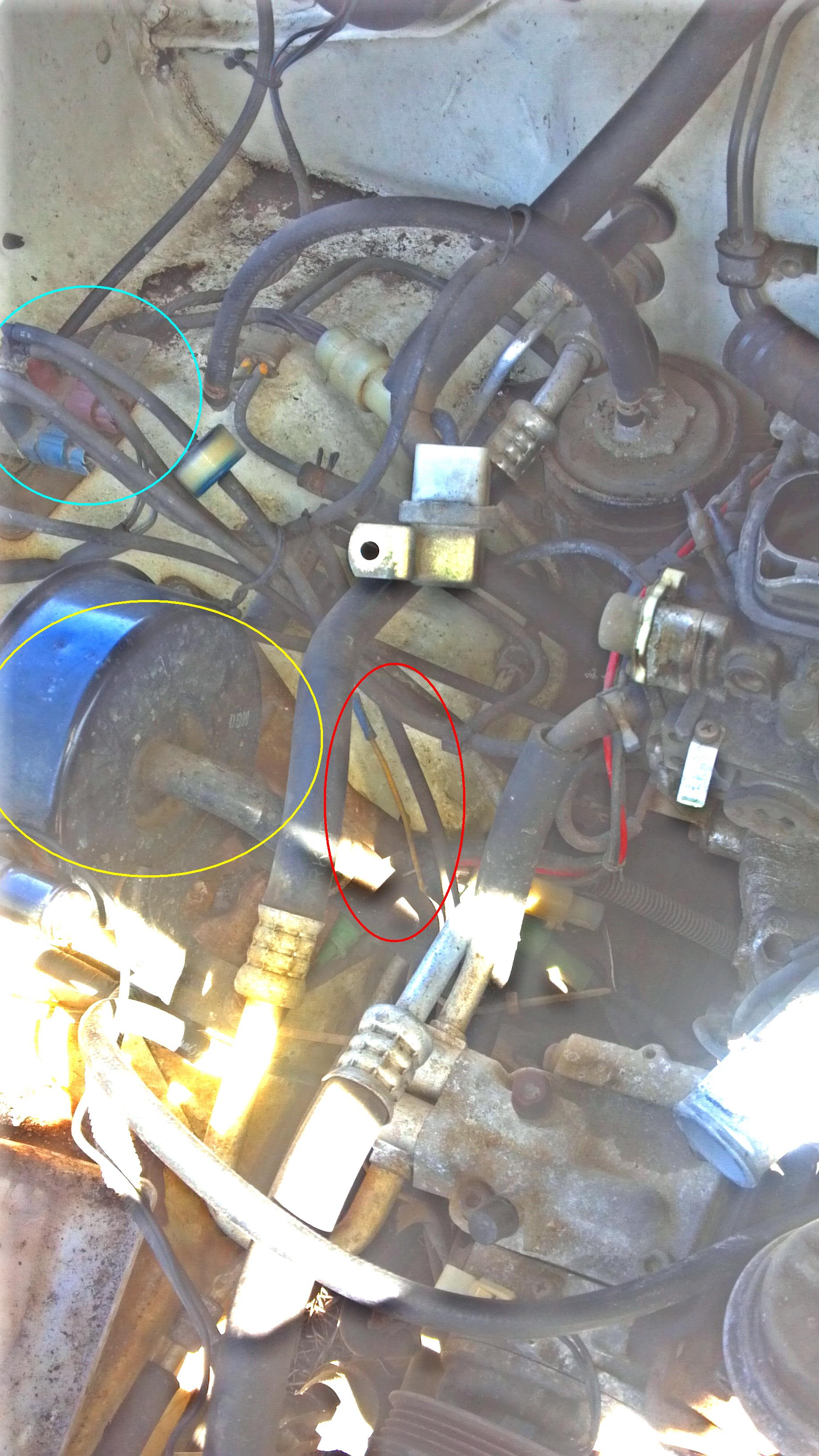

The first picture is the diagram that the Toyota dealership printed for me (based on using my vin) and everything is hooked up exactly like it says. The second hose coming out of the four way isn't hooked up to anything but tries to suck (or pull air) when I try and start the truck. The two hookups in the middle, not leading anywhere, are shown in another diagram. The left leads to the charcoal canisters and the right one is shown leading to the carburetor.

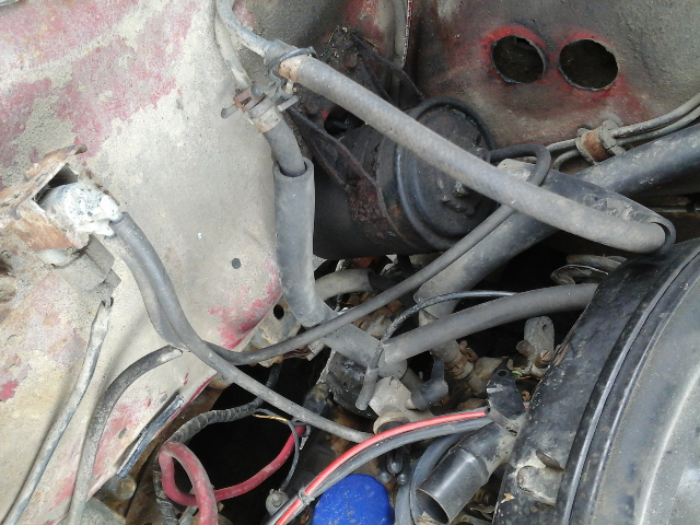

But it still doesn't run. The second picture, which I ran through some image filters to try and lighten up to show the lines a little better shows pieces that apparently were thrown away, stolen, or dragged off by the dogs.
The circle in the top left shows a bracket with two VCV(?)s with four hoses attached to it. Three hoses are still attached. The fourth is missing. Also, the wiring harness to power this piece (There's a large blue, large red, and small green wire that is missing, but once powered the piece). I have the piece and bracket (the dealership couldn't identify it) but nothing that hooks up to it.
Right of the teal circle, slightly above the yellow circle, uncircled, is a vacuum type piece with two places for vacuum lines and a place to plug it up to power. This, and the similar piece on the opposite site of the black canister (circled in yellow) do not have anything to hook up to.
What is the black canister's purpose, what's it called, where can I get another one, or how can I bypass it?
Also, circled in red, is a yellow line with a blue ending. I have that. But it's not attached to anything. The end of the yellow line possesses only exposed wires, with nothing to attach to. Above the blue piece that runs behind the downward running hose is a male ended adapter which probably plugs into the vacuum piece I was talking about a minute ago, and both of these run into an insulated sleeve, leading into a female adapter, which also has no where to plug into.

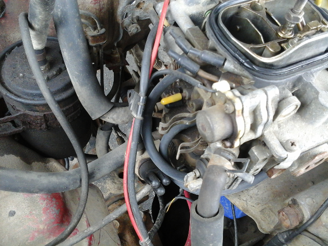

The third picture shows the new engine before it was installed. Circled in lime is a piece I can't find on any diagram. What hooks into the circled piece? And what is it?
Please help me get my Yota running, guys, before everyone here slap gives up.

man... your in deep with vacuum lines... although im not familiar with toyota's vacuum line craziness and all these extra switches and sensors ran off vacuum, i can see a bunch of open ports that would probably prevent your motor from starting. i would plug the ones you can't figure out, dont connect them to anything just terminate them with some sort of plug. then see it if starts. from there if it still dont start try plugging one item into random vacuum ports and see if it starts. that diagram they gave you kinda helps out but kinda sucks. good luck man. hopefully someone else has more experience with your vacuum line problem.

Do you live somewhere that does smog or emission testing? If not you can bypass almost all of those vaccum lines, I have a 87 that has only 4 vaccum lines. I removed all the emissions items

No. None. The engine was one of those California ones, so I had to remove and swap a few things to make it match my old one. It matches perfectly now. But all I have all those diagrams and a few pictures I took that were supposed to show hookups but failed to show anything at all. Now I'm missing the harness and canister and only one vsv is hooked up.
Can you post pictures of your setup so that I can and mimic yours? Anything to get her to run again!
