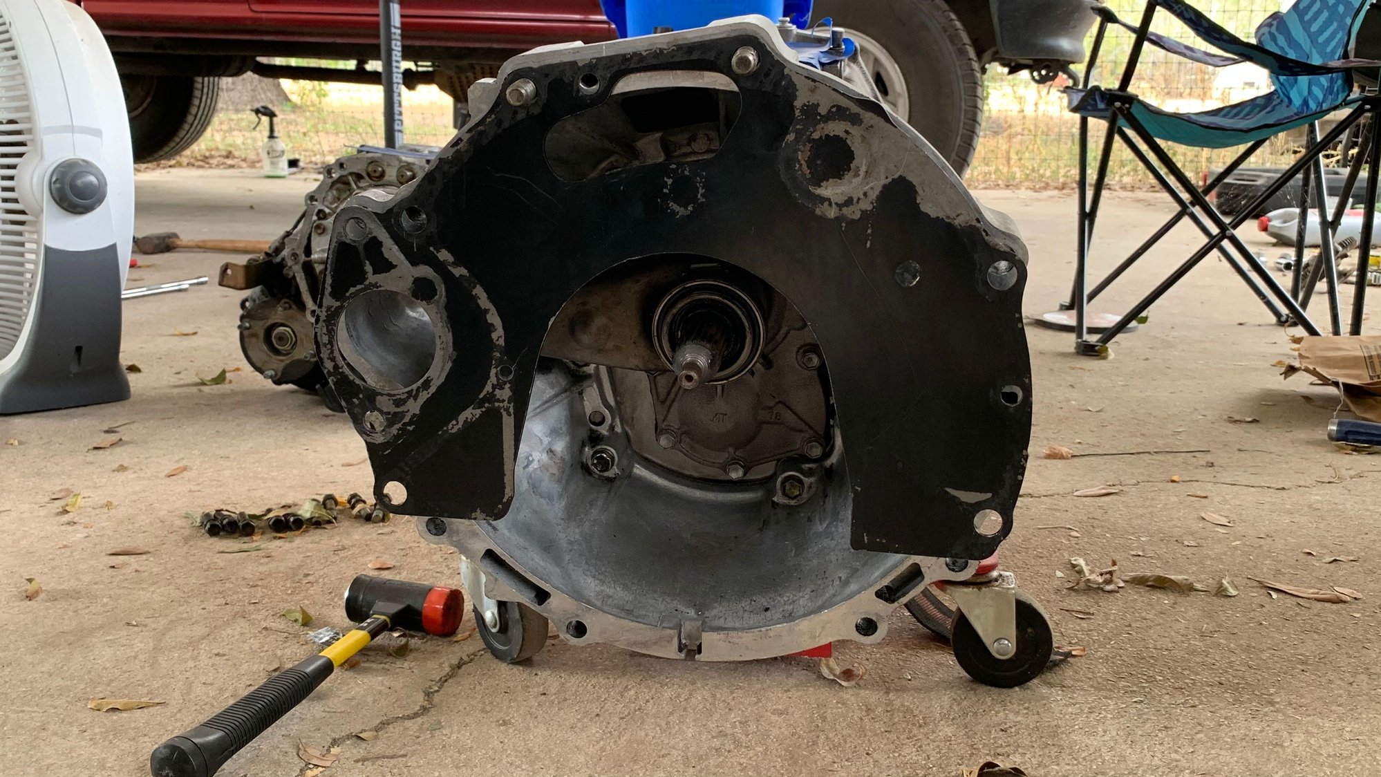

I got my truck back from the mechanic several months ago and it was missing a lot of parts. He swapped the transmission and engine, but almost all of the brackets, dust covers, heat shields, nuts and bolts were lost in the process. I’ve been trying to replace them all little by little through picknpull, eBay and Yotashop. Yesterday I finally found the piece that goes between the transmission and the engine. I’ve taken it off before, and I remember that it was a U shape. What I can’t remember, is whether or not there was another piece that covers the bottom. I’ve attached a picture of what I have right now.

I did a swap out of an automatic to a 5 speed in my 1995 4Runner.
The donor was a 1995 also, so I had all of the small parts and bracketry at hand.
If I remember correctly (real old guy), the plate extended all the way down to the bottom of the bell.
I went out to the carport and looked under the Runner at the join between the bell, and the engine plate, and can't really tell if it is one, or two pieces.
But, the opening is definitely covered.
Hope this is helpful to you.
Good Luck
Art.

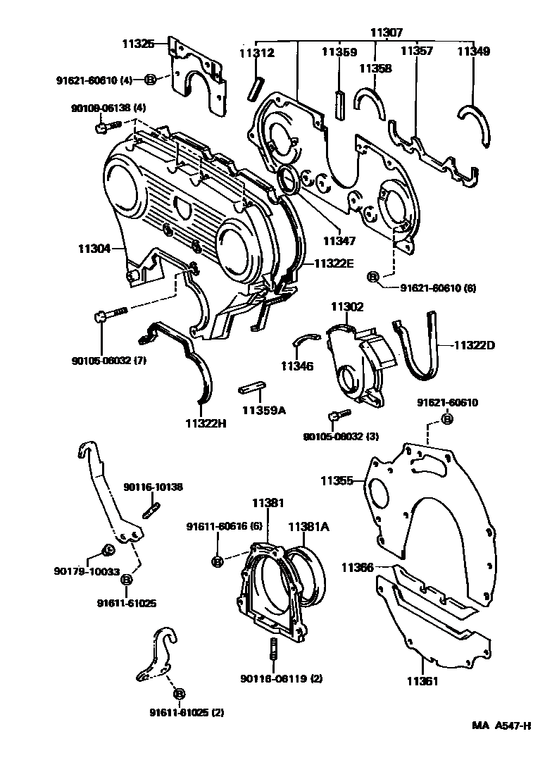

This may help?

yeah - that helps a lot actually. I’m missing 11361. I don’t know what 11366 is. I don’t remember ever having that one. But as soon as I saw 11361 I remembered that from previous times I’ve worked on the transmission. Looks like 11366 fits into 11361. Hmm. Thanks

Originally Posted by ZARTT
Hi:
Good Luck
Art.
I’ve seen several full size plates as well. I kind of wonder if some years/configurations came with those. Thanks for checking.
