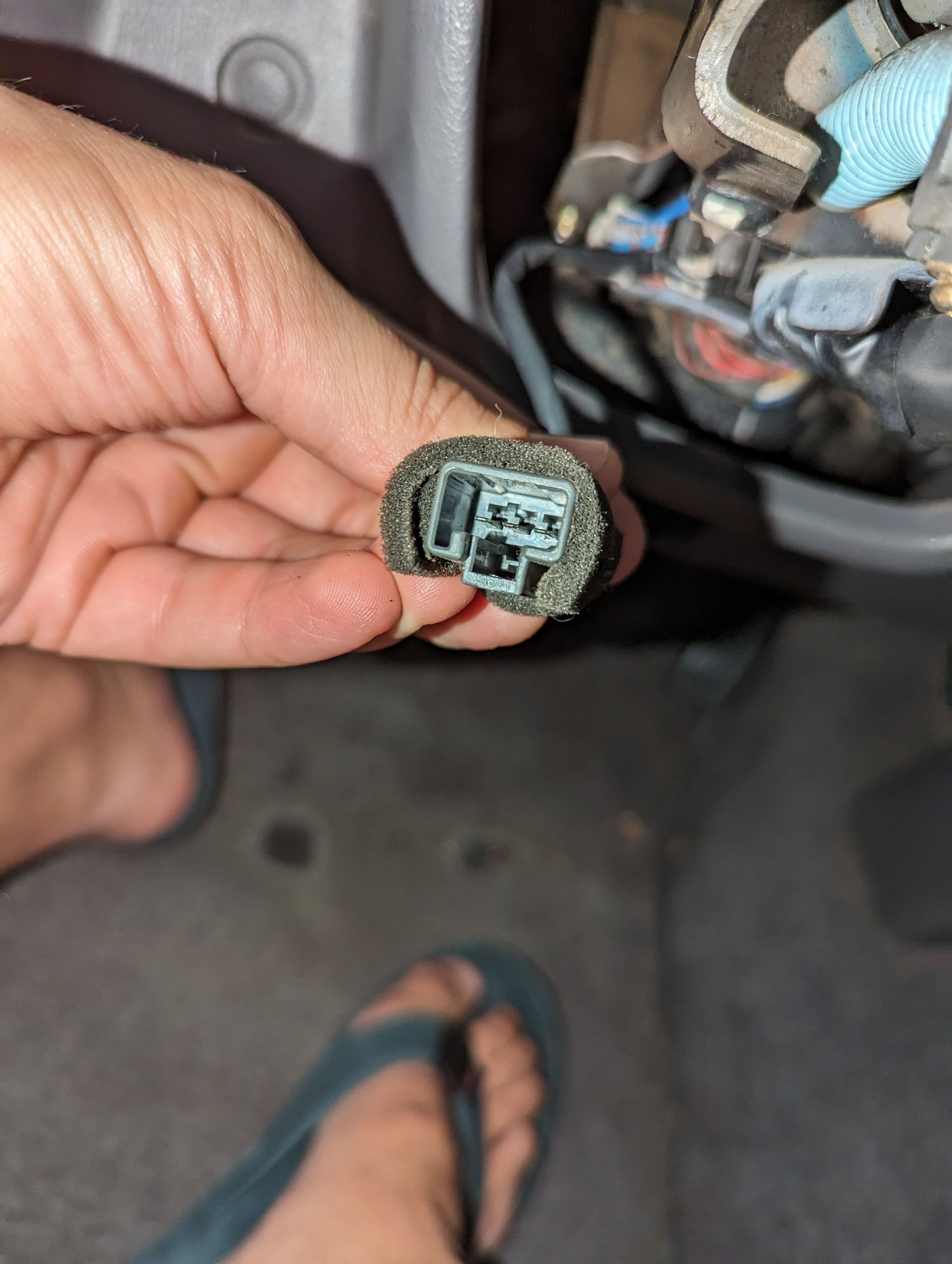

First time poster. My apologies if I'm posting improperly. I've searched through the forums for this, but haven't been able to figure it out. I recently worked my way through a tilt steering swap from a 1995 automatic 4runner into a 1991 manual pickup. I had to swap my old lock cylinder into the new column after drilling out the donor cylinder since I didn't have the key. Of course there is an ignition lockout module on the cylinder that I've left attached, but is not being used in any way. Intermittent wipers work perfectly. I also now have useless cruise control buttons. Haha
The one connector I'm unsure of is a gray 3 pronged connector from the swapped column that has no place to attach to the truck wiring with purple, brown, and gray wires coming out of it. Any ideas?

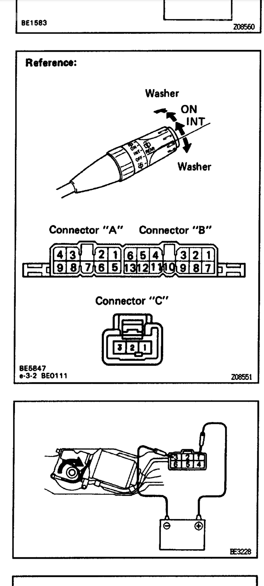

It's possible it may be an extra connector for the rear wiper assembly which the truck obviously doesn't have, but the wire colors don't seem to match up in the 95 4runner FSM. If that is the connector, I think it's labeled C17a, but I could be totally off.

Cruise control plug??

Yeah...maybe cruise control. I guess if everything is working as it should, I should just not worry about it. I'll dig into the FSM again to try to see what the cruise control situation looks like. I recall it being a resistor ladder, but for some reason remember the wire colors and connector being different. You're most likely right though.

Thanks for the suggestions. Just follow up on my original question as well, it is indeed an accessory plug for the rear wiper assembly in 4runners that pickups would not have. Maybe I'll find some way to repurpose the switch. Happy to hear suggestions... Haha
Thanks again guys. Attached pic
is the C connector from the 95 runner FSM.
