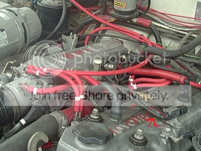

btw anybody have an idea what this is for? mines broken
is it even important or can i just block it off and forget about it?
I'm fairly certain that's the VSV for the PAIR. Important? Depends, do you need to have the emissions checked by DEQ to register the vehicle legally? If not then no. Go ahead and block it off.
http://personal.utulsa.edu/~nathan-b...20pulsedse.pdf
