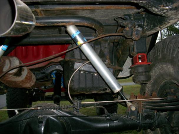

Angling them inward will destabilize your rig on the road. I'd reccomend against doing that unless this is a trail rig. Angling them inward seriously reduces the shocks effectiveness. FYI
You can mount the shocks ontop or on the side of the axle tube and connect the uppers to the stock locations (thats the best way IMO)
Like this:

Seems like you can mount your existing shocks the same way as the blue shocks in the above pic. The coils will yield about a 2.5" lift with your new set-up so moving your existing shocks from the lower plate to the axle tube will be just about the same 2.5 inch offset. It does mean that some MIG welding needs to be done for the shock mounts.
ZUK

The set up above is very similar to the stock set up....
The way there is one shock in front and one behind helps a lot with axle wrap...something else to think about
