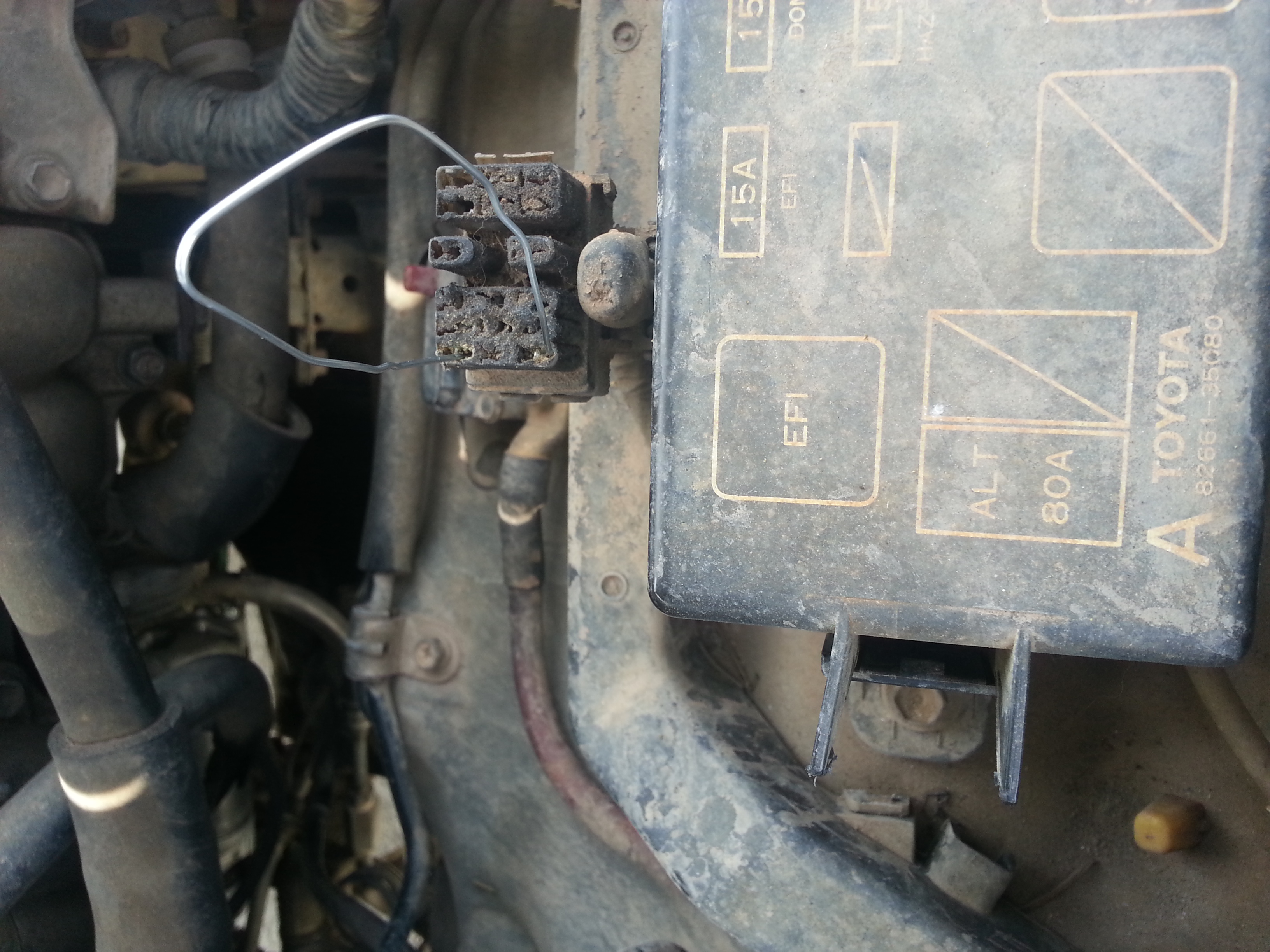

i don't hear my pump running nor did the car start so what should i do next?

Got a multimeter? No? No excuse for that! http://www.harborfreight.com/7-funct...ter-98025.html
Start by checking that you have 12v to ground (key-on) at the B+ terminal (if not, it could be the EFI fuse, EFI Main relay, or somewhere in between). Next, check for "low" resistance to ground at the FP terminal. If more than, oh, 25 ohms you 've got a problem in the wiring to the fuel pump (or a dead pump, but you say it's new).
Good luck!

i checked the B+ terminal to ground its at 6v and FP is under 25 ohms but my truck been sitting for awhile so i just charged the battery and will retest again just to make sure.
