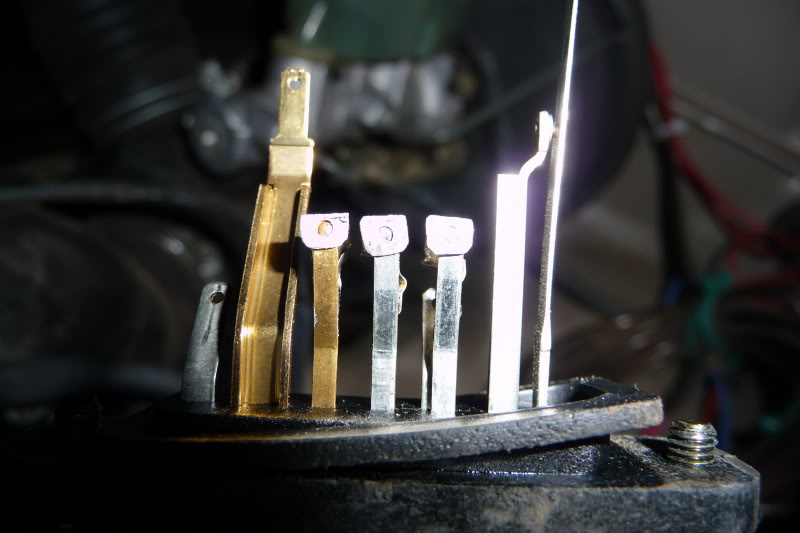

I couldn't find the thread with the person who fixed the fuel pump switch but here's a post with pics showing the inside of the meter. In this post, a different terminal is broken, not the fuel pump switch. But you can see the two tabs of the FP switch on the left side of this pic (not the red circled part):
And you can see the two tabs better on the right side of this pic (BTW do NOT remove the terminal like this poster did):
You can see a metal bar attached to the black plastic in the top photo - that bar pushes against the longer tab of the switch, keeping it away from the shorter side. When the vane of the meter is opened by the air being sucked into the motor, the long arm pulls away from the long tab and it springs toward the short tab, making contact and closing the ground, completing the circuit between the FC lead from the circuit opening relay and E1, which is a ground. So if there are no vacuum leaks in your air hose, then maybe the long tab has lost its spring.
