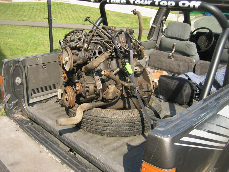

I second the motion to use an old tire. That's how I transported a 22RE in the back of my first gen. With the help of 2 ratchet straps it worked perfect. You can see it's really not too tall so you shouldn't have to pull the head. We lifted it into the Runner with the same crane he used to lift it out of his Pickup.

Also, I should add, make sure you leave it vertical, especially if you do pull the head. It doesn't matter how well you think you've drained the fluids, it will leak and make a mess of the inside of your Runner.
