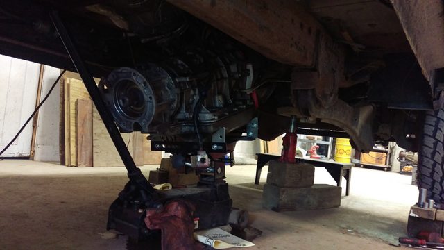

Two people can absolutely pull a trans, ya pansies. Its the transfer case hanging off the back that makes it so heavy. If you split the two and take it down in sections, its much more manageable. However, a jack would be way faster.
I have one of these, it works alright for a super budget jack. But Ive done many Toyota trans/cases and two super duty transmissions with it and it works awesome. Its tall and a littly chunky to use, but worth every penny.
https://www.amazon.com/ATE-Pro-USA-8.../dp/B00080QGYG < I think I got it off Northern Tool, but theres an amazon link
Is that an adapter on a jack, of course I didn't look at the link I'm old and lazy the same reason I'm not trying to chest press parts under a 4x4!
The better trans jacks have swiveling casters on all four corners to help with positioning.
Old Sep 24, 2019 | 10:59 AM
5 Fists's Avatar
Posts: 531
Likes: 168
From: British Columbia
Yes that looks to be an adapter for a floor jack, cool idea. Will be putting that on my tool wishlist.

Yeah, just an adapter for a floor jack. It only pivots one direction vs a normal trans jack.. but for only 60 bucks.. you cant expect too much and it gets the job done. Plus, not storing a whole jack, just the top piece.
