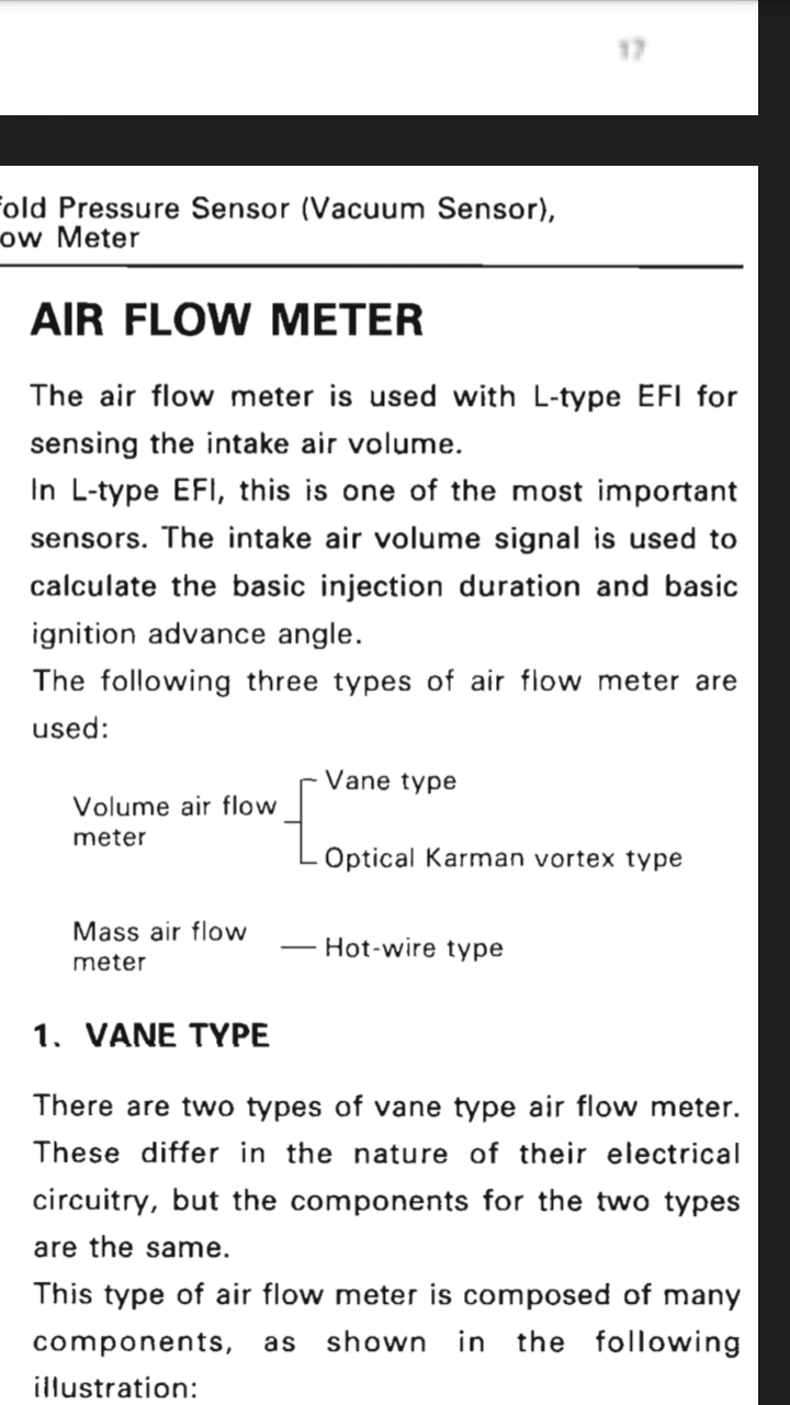

Originally Posted by old87yota
Check the rubber intake boot for cracks and splits. If there is a crack letting in quite a bit of air, it will mess with the fuel calculations.
Yes the most important calculation being do I turn on/off the fuel pump
It's not the AFR that is the major issue it's the fuel pump cutoff in the VAFM in the case of a leak between the VAFM and throttlebody.
FYI..
The important bit is the ignition timing. The vafm works primarily as a load sensor. When you go from part throttle to open throttle the vane opens fully briefly this triggers the ignition to retard momentarily and allows the crankshaft to speed up with out hammering the bearings flat or outpacing the cam, the vane then stabilizes somewhere between where it was and fully open. (It has auxiliary functionality that help in the AFR calculations, and functions as a back up to the tps THA signal)
This load sensing is what triggers the failsafe (over boost cutoff) in the RTE.
You'll notice similar effects on all of these L-VAFM engines. When people talk about "engine lagging from 2000 till after 3200 rpm" that's the load sensing in most cases. If you slowly open the throttle and allow the crankshaft to gently accelerate there is no ignition retard and it glides right up, but if you hammer the throttle in 5th gear you instantly loose a lot of HP..
It's even more exacerbated by the automatic trans down shifting out of O/D since there is a huge surge of airflow across the vane. (Again a big cause of the RTE triggering over boost cut off)
(Yes to much free time today, I got wordy!)
