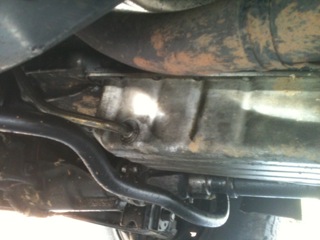

Long story short, I could use a pic of this too because someone who worked on my truck at some point didn't reattach the tranny dipstick to anything. It's just wobbling around in there.

Is the transmission dipstick tube suppose to be horizontal when it enters the pan?
Here's my real issue: My transmission (A340H) is slow to engage the first gear when starting from a dead stop, but this isn't a problem if you manually move it into L, get the truck going, then shift to D when you hit like 10-15 MPH. I checked the fluid level and it looks like it's way too full (it goes up past the hot mark when it's cold). So I messed around with draining out some fluid, but that didn't help. I did some searching on here and found that a common issue with these trannys is that the dipstick tube is in 2 pieces and sometimes they aren't put back together correctly, which will show an incorrect level on the dipstick. I looked into this and noticed that the dipstick tube is horizontal for the last 4-6 inches before it enters the transmission pan (see pic). Additionally, the top section of tube isn't bolted to anything, which from what I read on here, it's suppose to be bolted to something. Is this normal? It seems like it would need to be vertical at the bottom in order to get a good reading of the fluid level, but who knows? It wouldn't be the weirdest thing about this transmission if it's suppose to be like that. Any thoughts? Can someone with an 86-95 pickup or 4runner with a V6 and automatic go take a look at how their dipstick enters their tranny pan?
Mine looks the same. I just can't get the top tube into the tube coming out of the pan.
