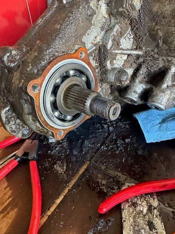

Im currently tearing down my t case out of a 1988 4Runner. It's attached to a W56 5-Speed transmission. Im trying to remove the front drive output gear and Im it's stuck. It moves out just enough to accommodate the snap ring, but it wont go in all the way to be removed. I know the cases are aluminum so I don't know if its safe to heat up..Thanks for your help.

My recollection is that it does not come out the front.
Remove the snap ring, support the front half of the case, and use a brass or aluminum hammer, or drift, to drive the bearing and gear out the back.
You should not need to use heat.
The bearing is usually fairly tightly pressed to the output shaft though, and you might need a bearing seperator plate and a press
if you need to remove that bearing from the output shaft.
That bearing is not so easy to lay hands on, and they're a bit pricy.
That bearing is often bad in cases that have laid with any water in them because the water settles there at the lowest part of the case.

right on..I've whacked it a few times but its seems like the bearing is just a tad too big to fit through the case. I might have a bad angle..Im definitely going to replace that bearing. It's not very smooth..
Should I just level the case as best I can and give it another go? Or is there some kind of puller I can get to pull it through the other end?

It should come out if you whack it square. A hammer with some mass helps.
Make sure you use a soft hammer, or punch, and a wood cushion on the case, so as not to mar the sealing face.

Finally got that shaft out. Just needed a little motivation from the dead blow..😂. I was being too gentle..
Gonna get everything cleaned up..Then replace all seals, gaskets and bearings. This was a pretty easy teardown..Marlin Crawler has a really good step by step and there's a video on YT that follows the guide and shows you what youre getting yourself into. Good stuff...
