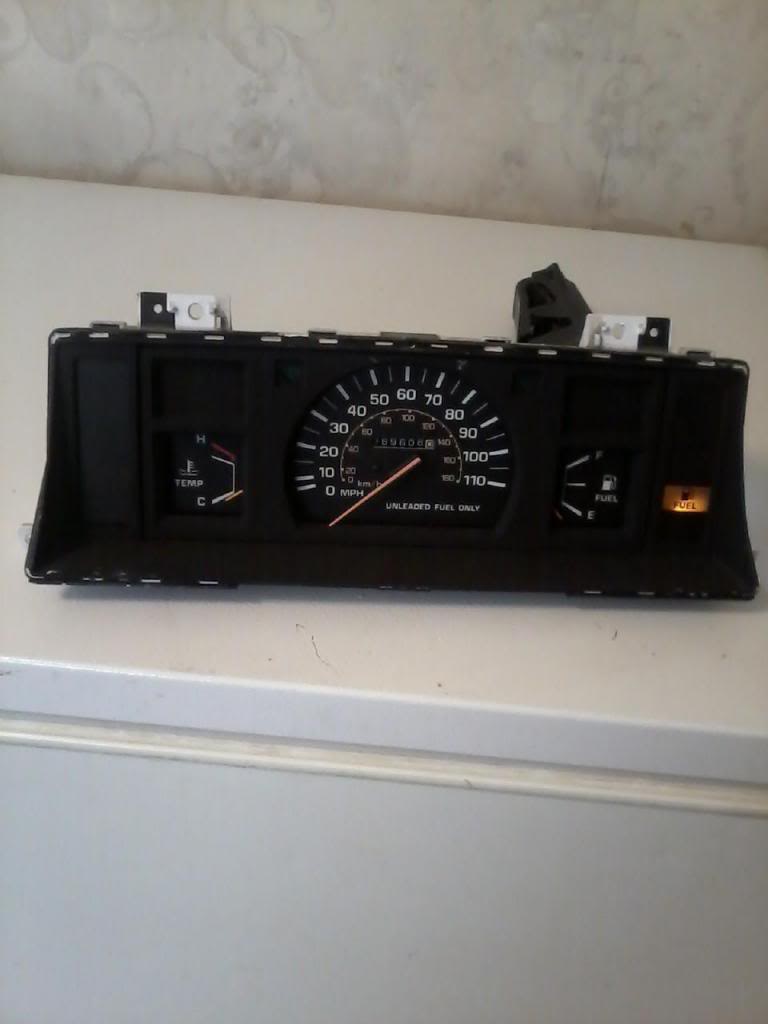

Thought this was myth of some sort. Heard buddy of mine oh yeah we have gas light. For when to warm you to fill up soon. Thought he was joking I've ran out of gas once and never say an orange light. Long behold wiped my gauge to get dust off last night. Sun happen to hit the right spot and I see a little box amber casing light. Anyone ever replace this..? Bulb burnt I wanna get it working again rather than me going by miles every tank.
If it matters 93 pickup ex 3.slow

If you have done the sr5 swap you won't have a working fuel light, originally trucks that had the sr5 had an a extra wire to the fuel sending unit to trip the low fuel light.

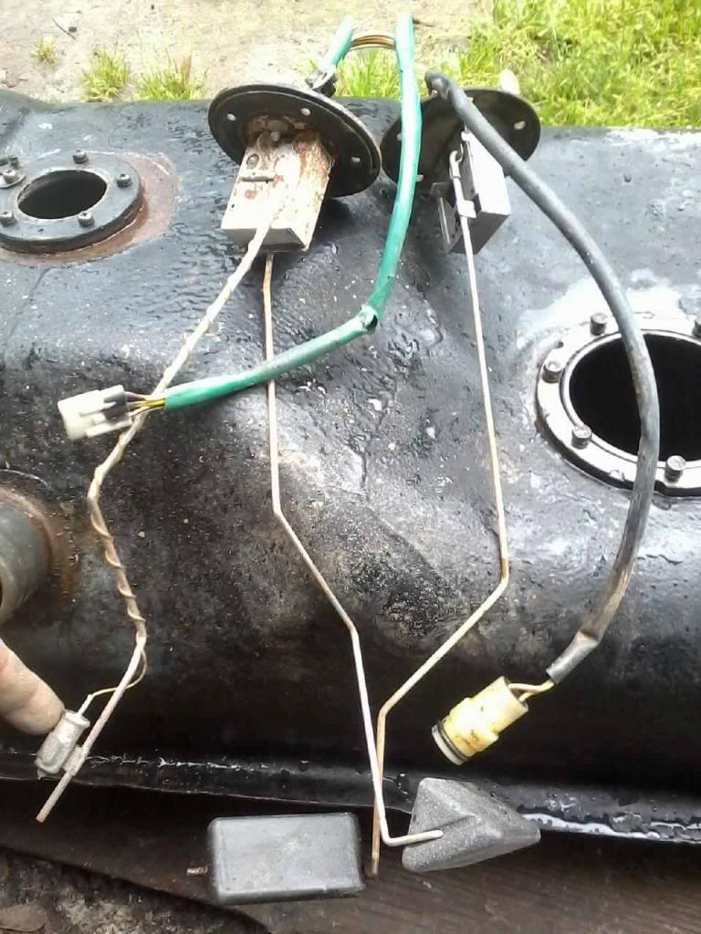

On the 84-88 both guages have the Gas Light. You at least need the 3 wire float assembly and add a bulb to get it to operate. Not sure what else is needed to get it to work. I would guess the next generation has the same option but wont say for sure. Fuel keeps the pump cool so I stay above a 1/4 tank.
Non SR5
SR5
Here is the different float assemblies. I am sure the one that my finger is on is what triggers the light. The plugs are different just because one is an 86 and the other is an 88 but everything else is the same. 2/3 wire.

Well I have the sr5 cluster extended cab.. Never swapped. Just wondering because it won't come on after the last line. Didnt know if it was possible just replace bulb
