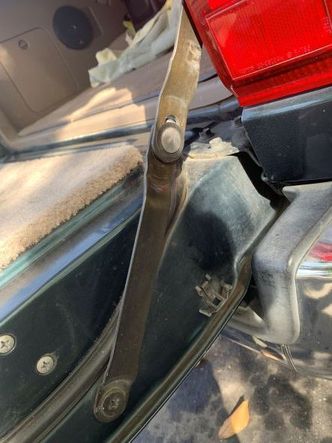

FWIW, the circled part (and it's mating part on the tailgate) is what is intended to prevent rattling. Before you try to replace the stays, you might want to make sure those clips are engaging.

I will check those, but the tailgate itself isn't loose and rattling; it's the stays themselves as the washers(?) are worn out, so the stays are allowed to move about just enough that they rattle. When I lift the gate to release the tension on the stays, I can move the stays back and forth, and the looseness produces the sound that I hear when the gate is closed and moving down the road. There's just enough play in the stays that they rattle when the gate is in the closed position.
It might be that part you've circled, and I will check that, but when the tailgate is closed, it's firm with no play so that part is probably working correctly. When the tailgate is closed there is no tension on the stays so they are allowed to move about freely, and that's what I believe it's causing the rattling that I hear.

Those spring cushions Scope1023 mentioned don't have anything to do with the closing of the tailgate, or how snug it is when closed. They are there solely to stop the stays from rattling when they are in the upright position(i.e. tailgate latched shut.)
The one in the image that Scope103 has circled is 100% intact. It's pretty common for one of those arms to break off, rendering it less effective.

Ah, okay, I haven't looked at it lately but that could very well be the problem!

They're awfully fragile. You should have four all together. Two on the body and two on the side of the tailgate. I've read the ones used in 84-86(?) were much more durable, but have been discontinued.
