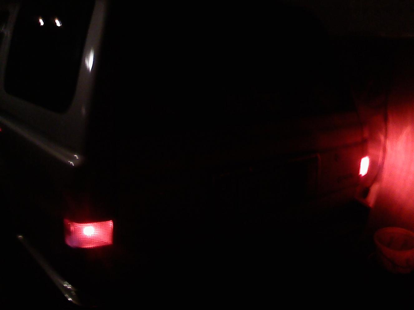

Ok, I went out and took the pictures! And, Here they are. Sorry for the horrid pictures they are off my phone. and I had the garage lights off so you guys could see the lights ( we have 4 long fluorescent lights) The First one is of the lights on and the brake peddle down, the Second is of just the brake lights (brake peddle down), The third is of only the lights on. I hope someone here has an idea of what is going on.

Broken brake light filament in the bulb shorting across to the running lights?

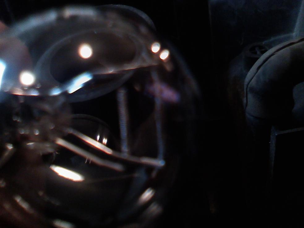

Here is a picture of the bulb that I pulled out of there! That is the kind of light bulb that AZ told me it took so i bought a pack of 2.

the bulb type is 1157?

If the picks are of an 1157 bulb that is the correct application for the running / brake light.

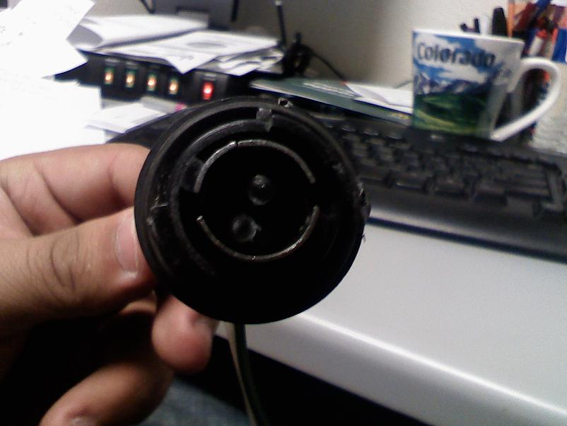

I took a quick picture of the wire harness. Im posting now. Can you please explain to me what I have to do! I do have a multimeter, But I dont really know how to use it. I had a hard enough time figuring out the ohm testing to test my MAF
Attached Thumbnails Tail Light problems-0218002116.jpg   Tail Light problems-0218002117.jpg

Well, I just took one of the prongs out of the plastic connector and the inner part is pretty corroded. Im posting a picture right after this!

Notice how green and corroded it is. I'm wondering if the wire inside the connector is even getting contact because of how corroded it is?
