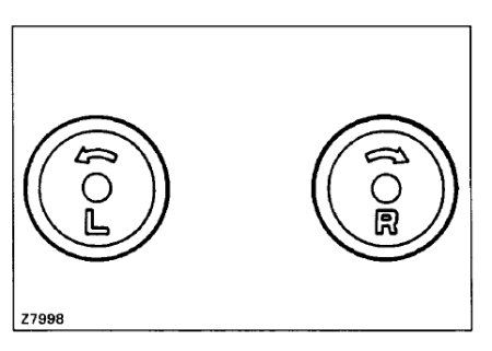

DaveInDenver's Avatar
Joined: Apr 2005
Posts: 313
From: Not Denver
Originally Posted by Old Man
I have already cleaned the heads. There are 4 dash marks on each one and arrow heads in the center pointing out. But no L or R.
If you can see the arrows, that tells you which side. The arrows point out.

Old Man's Avatar
Joined: Jun 2007
Posts: 8
My arrow heads do not look like that. they are on the enter circle pointing to the outside edge of the bar. (Man I wished my camera worked.)
