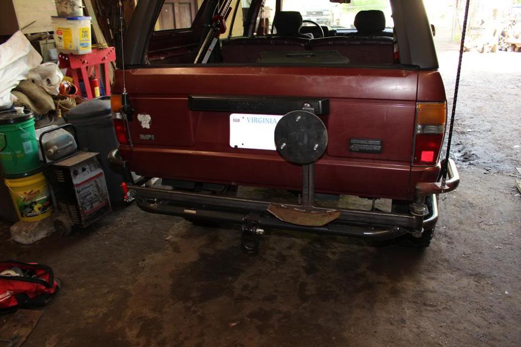

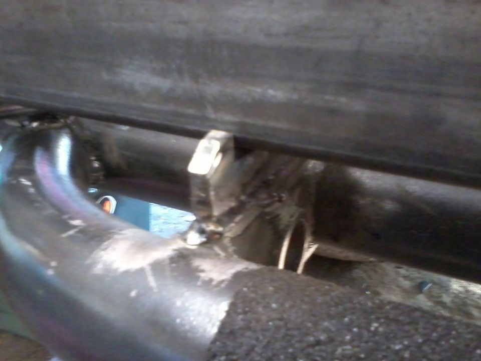

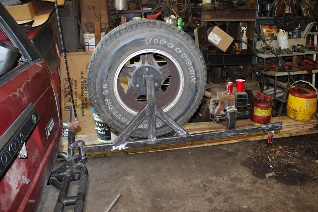

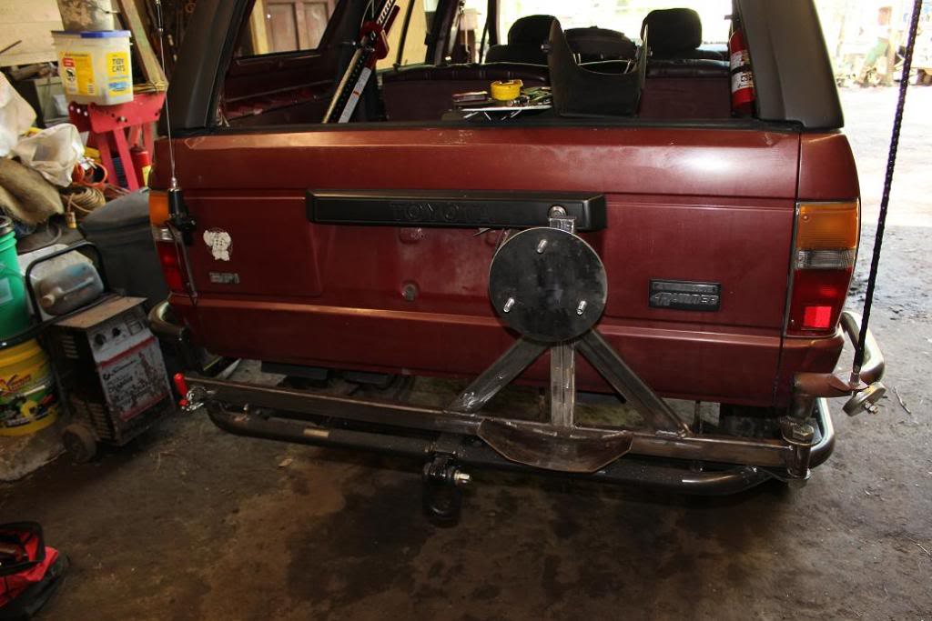

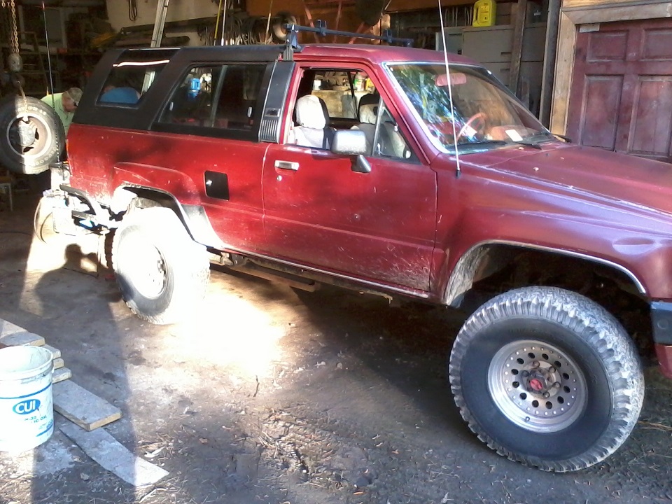

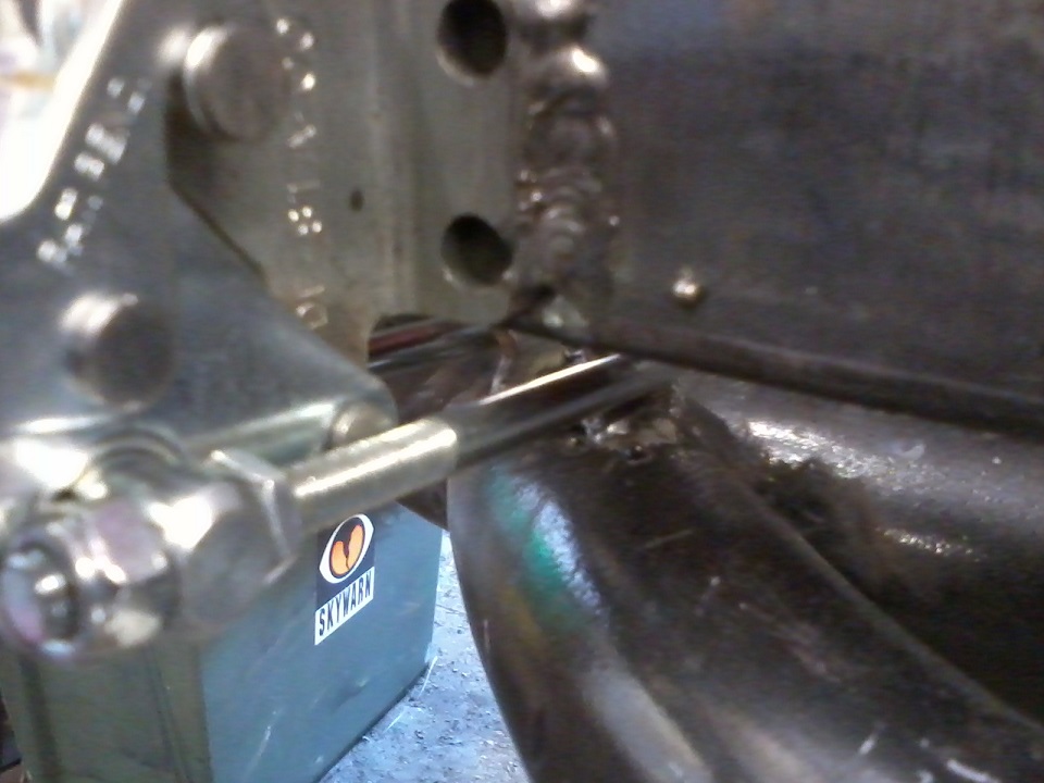

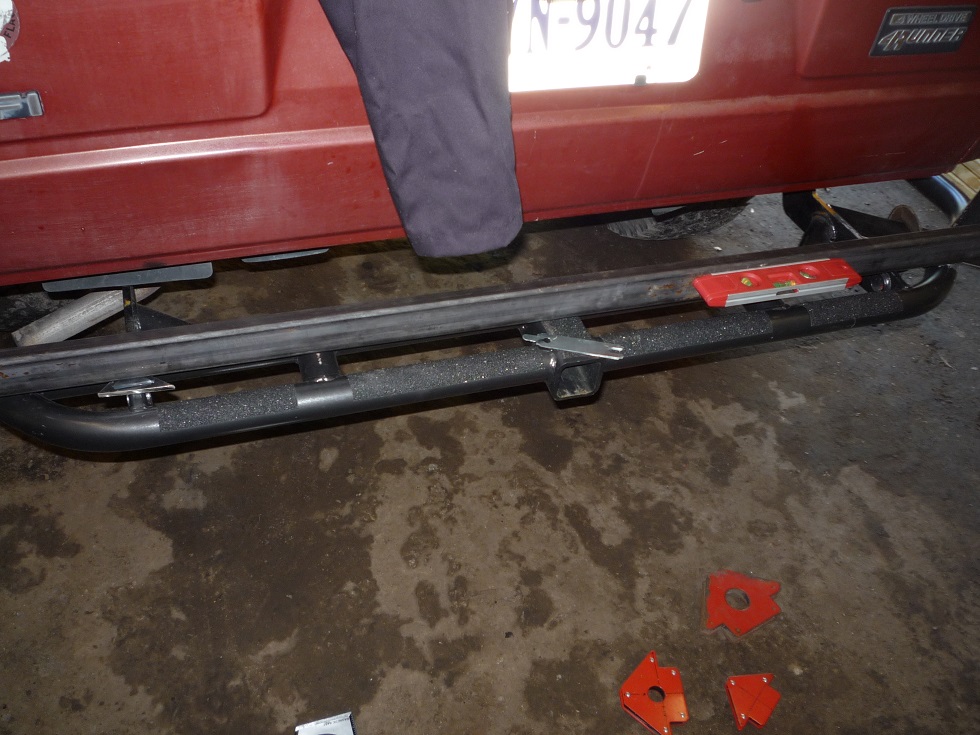

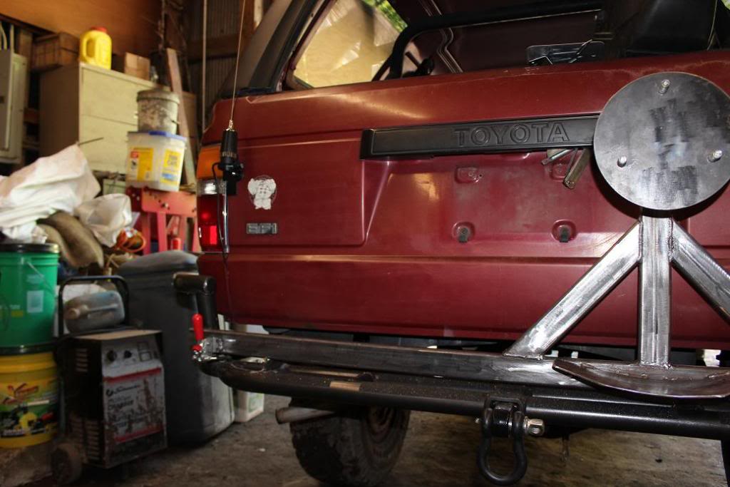

Ok so the timing chain will not be here until monday, so took some time today to do some work. Wed night the body lift came in so I went to work. 2" kit, drivetrain lift will be after the engine is repaired.

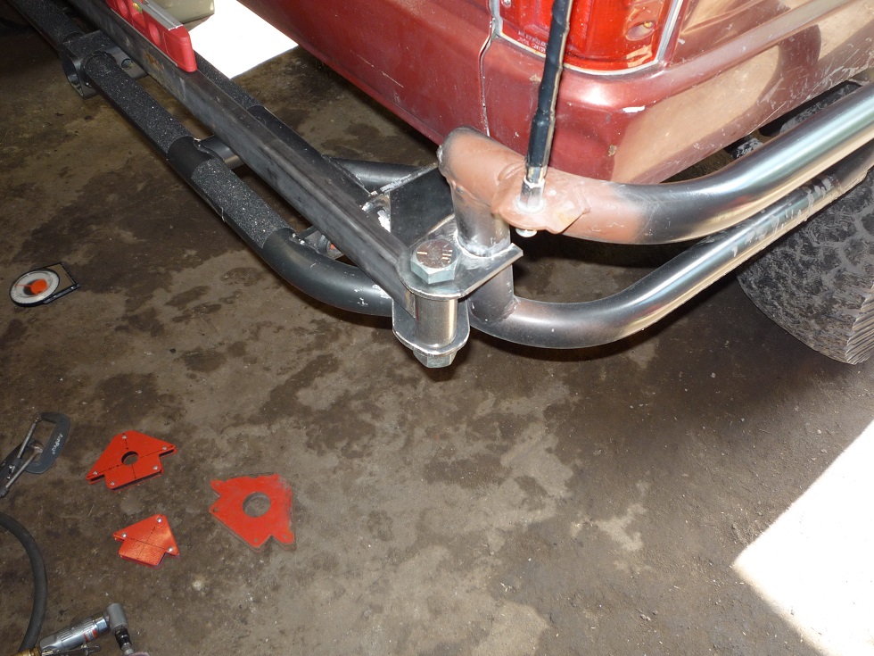

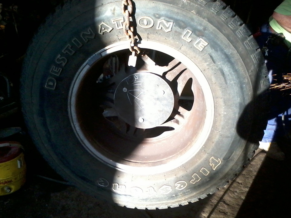

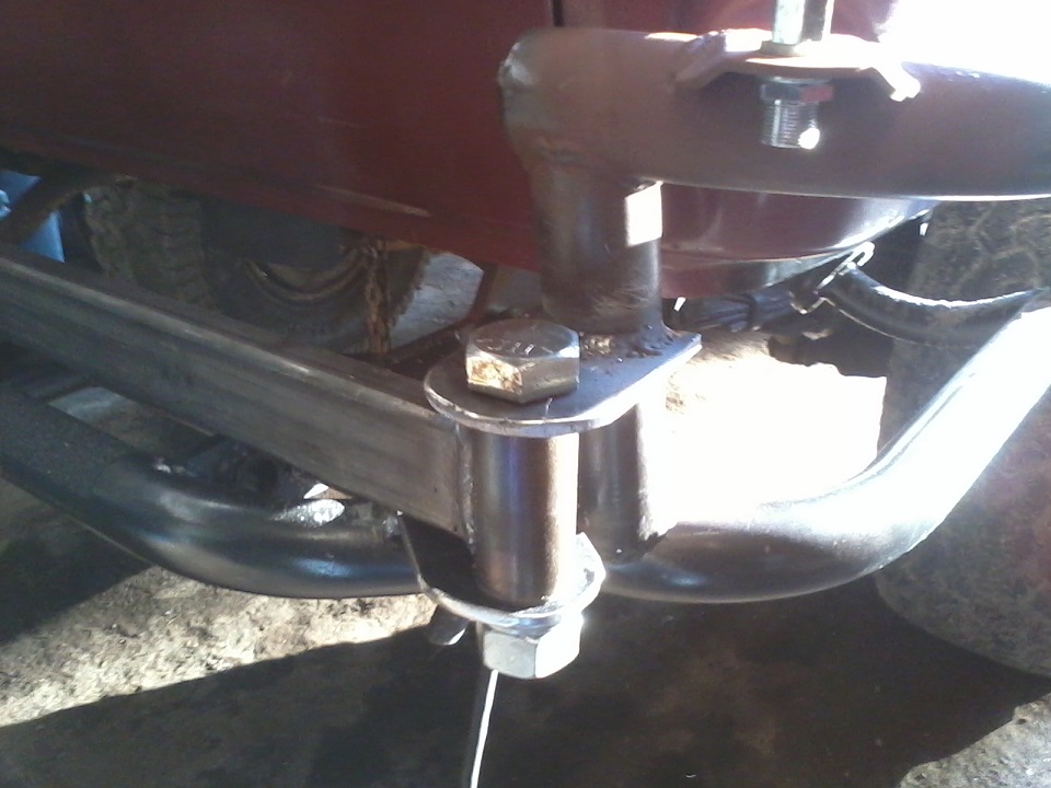

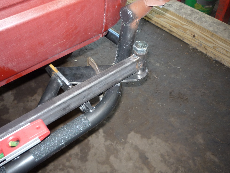

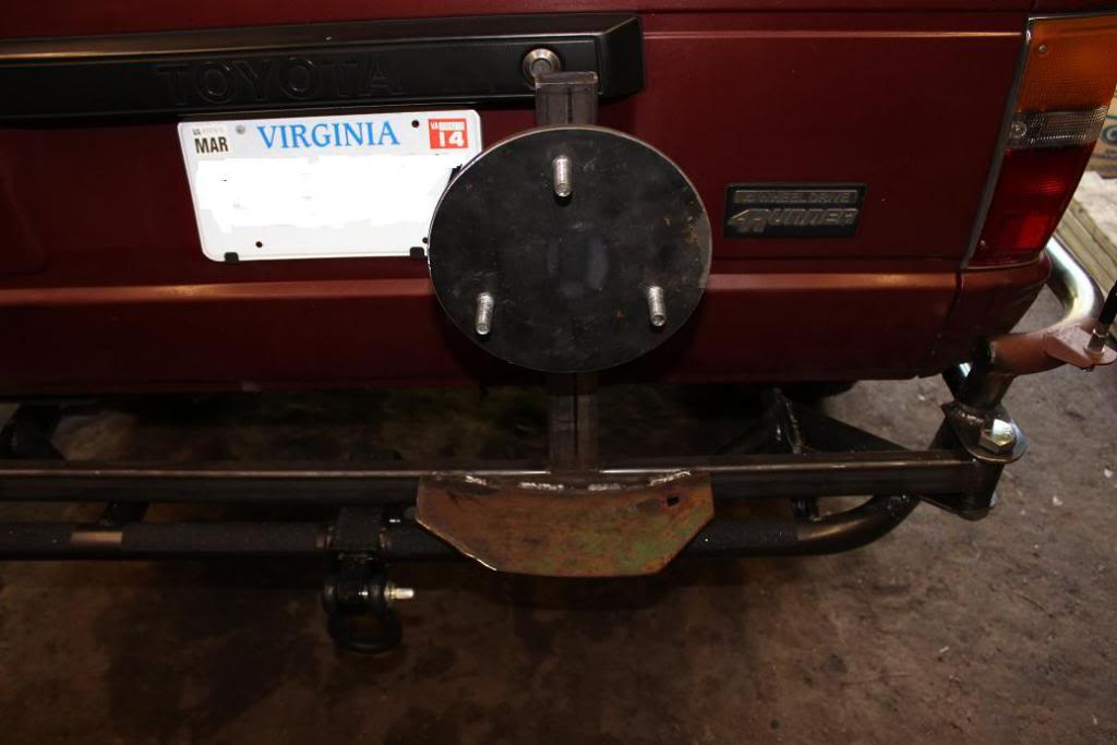

So today began the work on the tire carrier. I got a lot further than the pictures since the batteries died, but I will likley have it finished tomorrow and the progress up loaded. No details for now

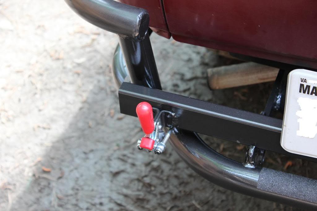

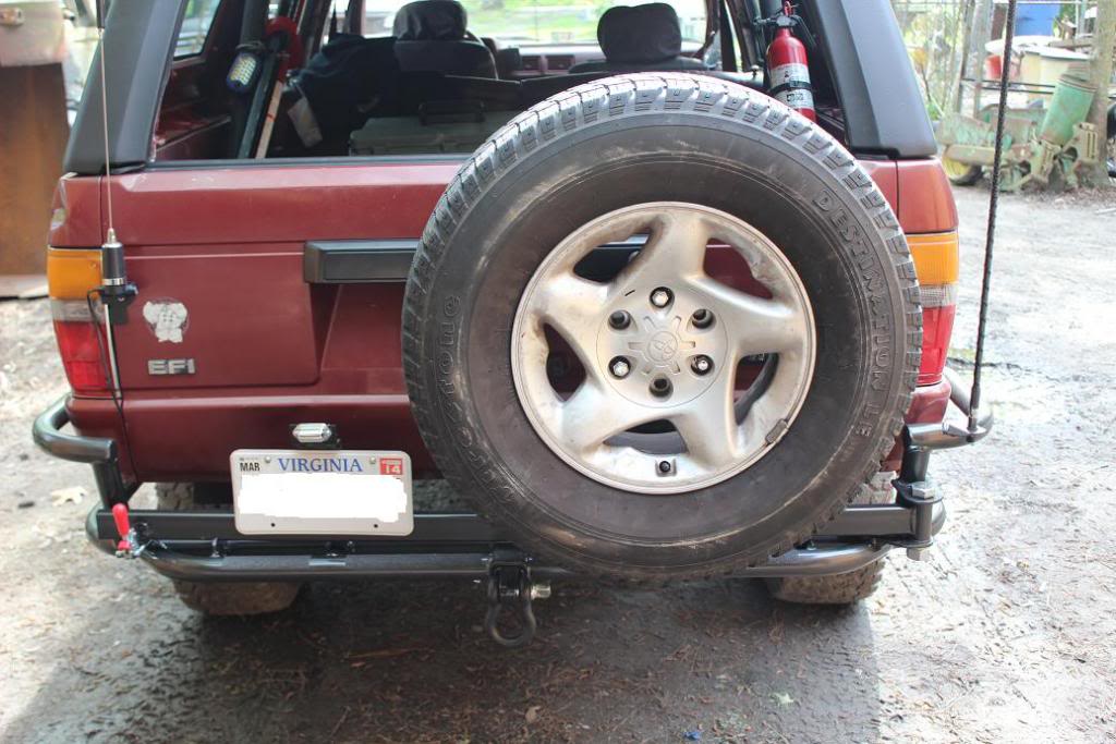

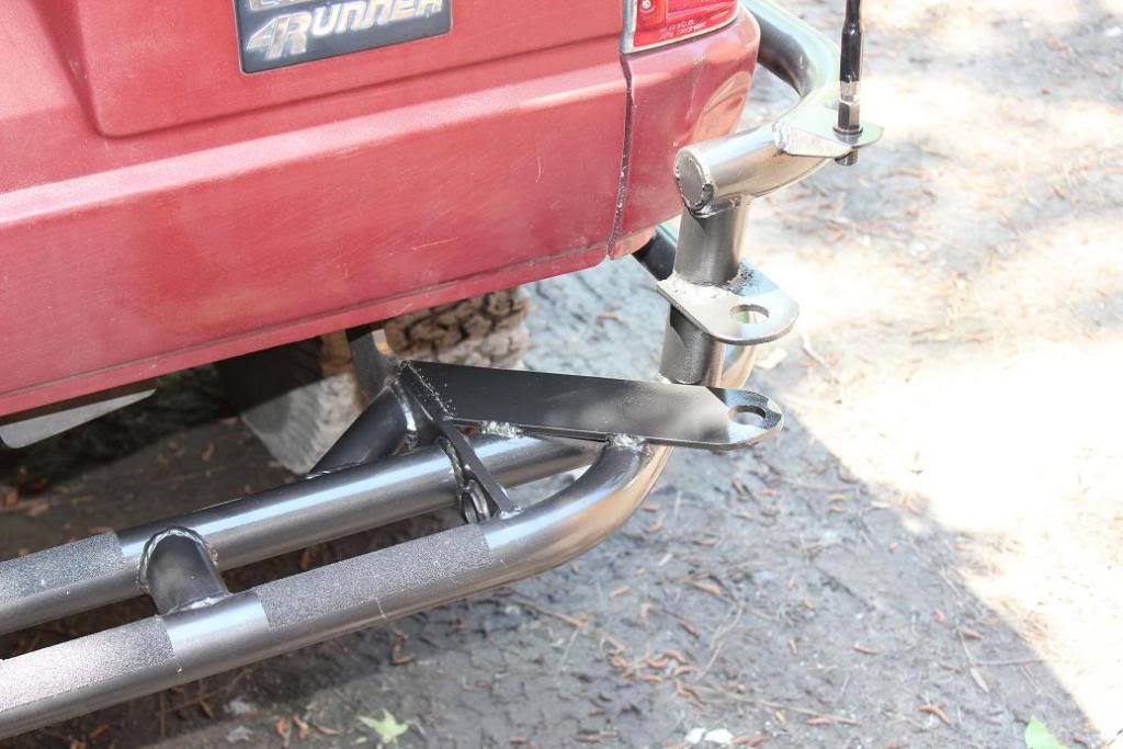

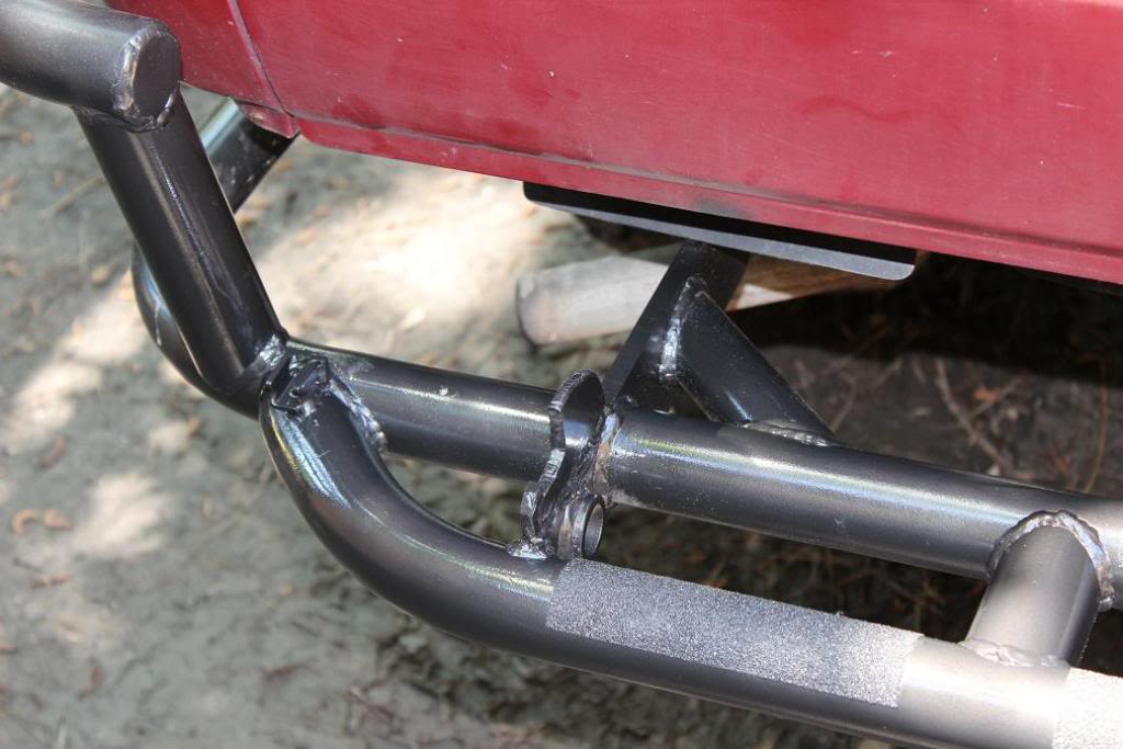

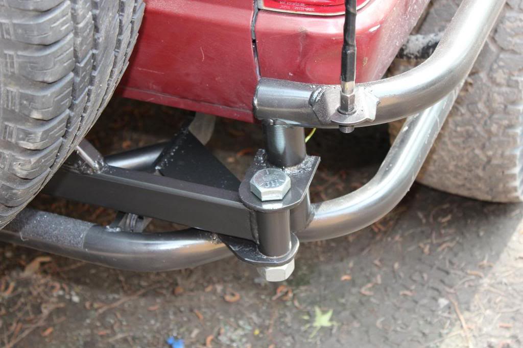

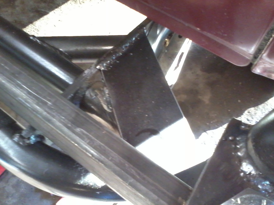

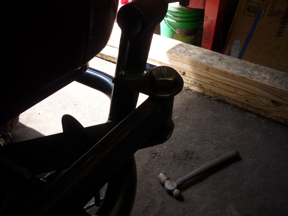

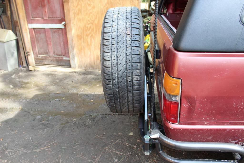

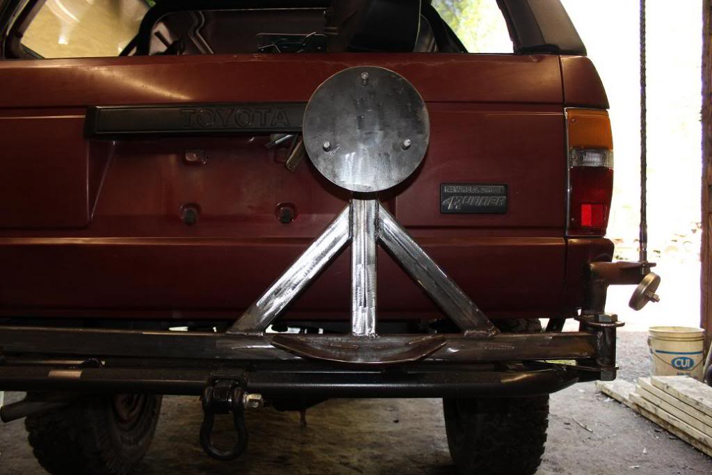

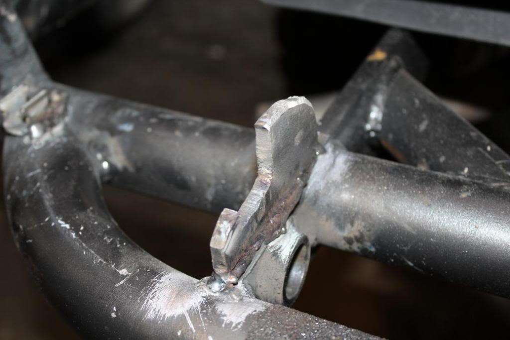

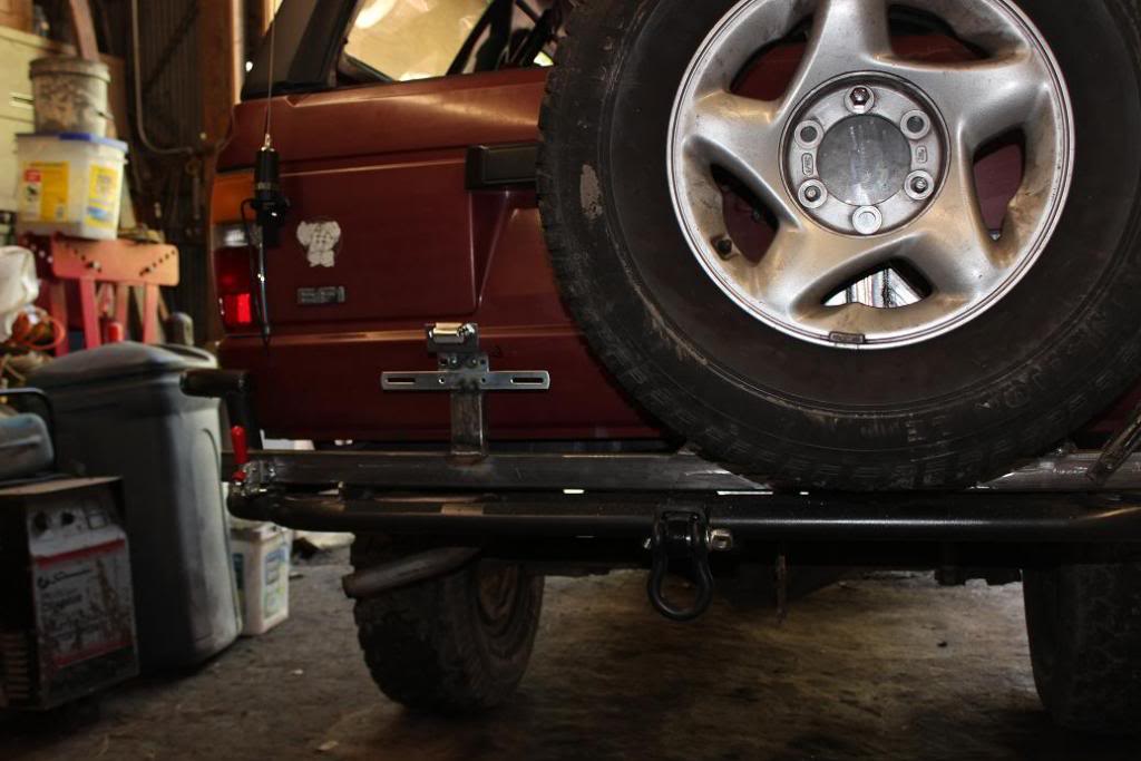

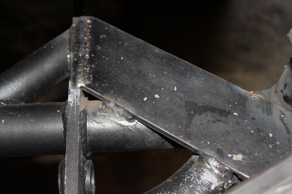

It is solid, and I still need to add the side braces, and some gussets. I also need to build the bracket for the license plate, and wire a light.
The weight will be supported by the bottom bar, not the top. There is a ledge that the tire sits on. The bolt is a 1" with bronze bushings, using 1/4 plate steel in dual sheer for the hinge. There is a tapered shelf that supports the weight on the opposite edge, it also has a safety notch to keep the weight off the latch.
The latch is a locking latch rated for 1000 pounds, it pulls the arm towards the front, and against the stopping tab. The round plate for the tire is 1/4 8" diameter plate that was cut on a plasma table at a local shop where I bought the metal.
The arms are 1x2, but with the design of this thing it saves weight and it will not be going anywhere.

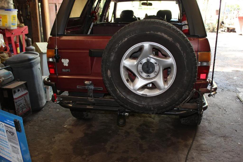

Picture Heavy Update

Nice work on the tire rack. Glad to see you got ~21mpg, kind of gives me an idea of what I can expect. I'm finally going to get my '87 truck towed to Virginia Beach sometime this week, and hopefully in the next couple of weeks I'll have time to pull out the 22R and tear it down to see what's salvageable.
