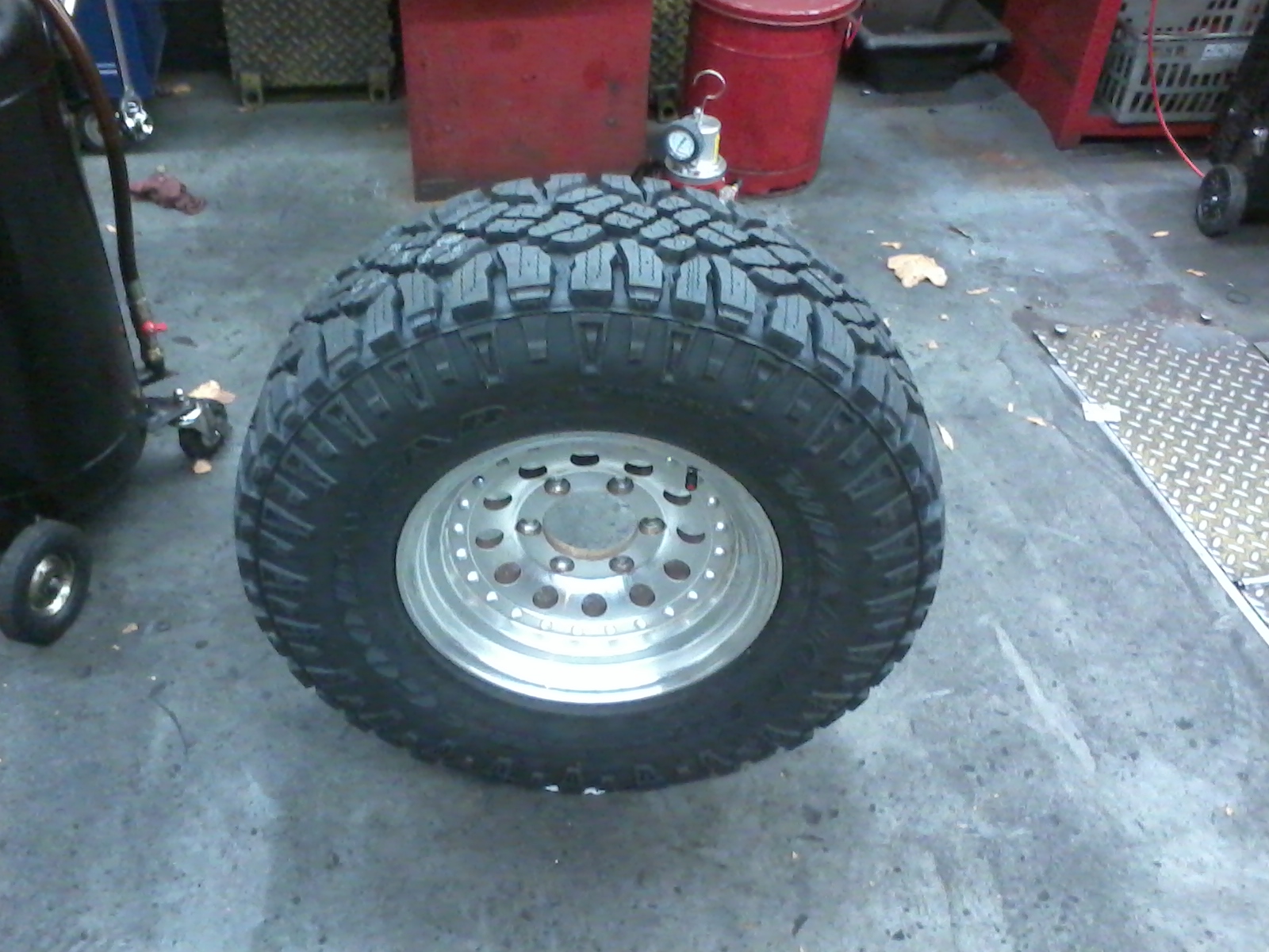

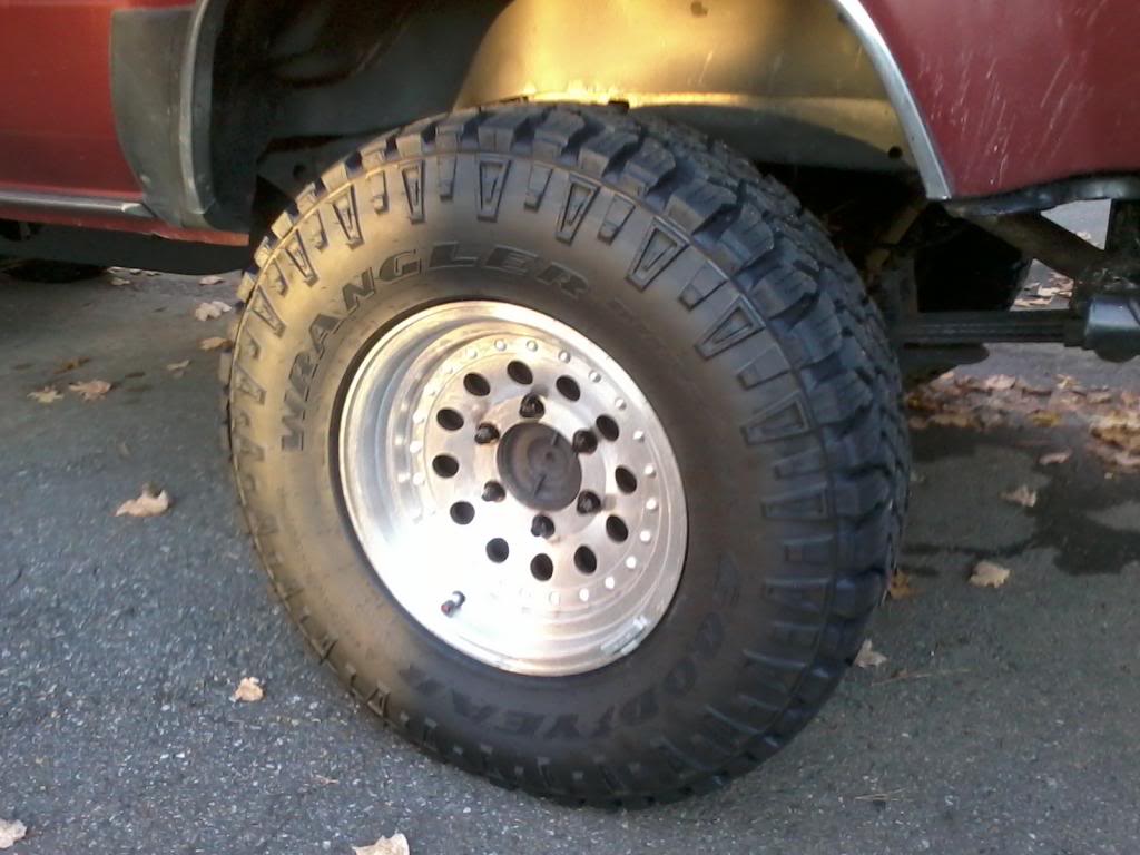

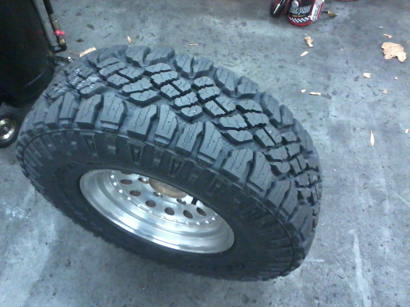

Got the one tire mounted up, and the other 3 are on order. Once the tires are on and the alignment is done, I will start the work on the dual battery/Power Inverter setup. Then it is on to the drive train and fuel tank lift.
Attached Thumbnails Stanprophets Beater 89 Build-img_20131108_173611.jpg   Stanprophets Beater 89 Build-img_20131108_173617.jpg

Duratrac's are on and so far I really like them. Great ride, so far pretty quite.

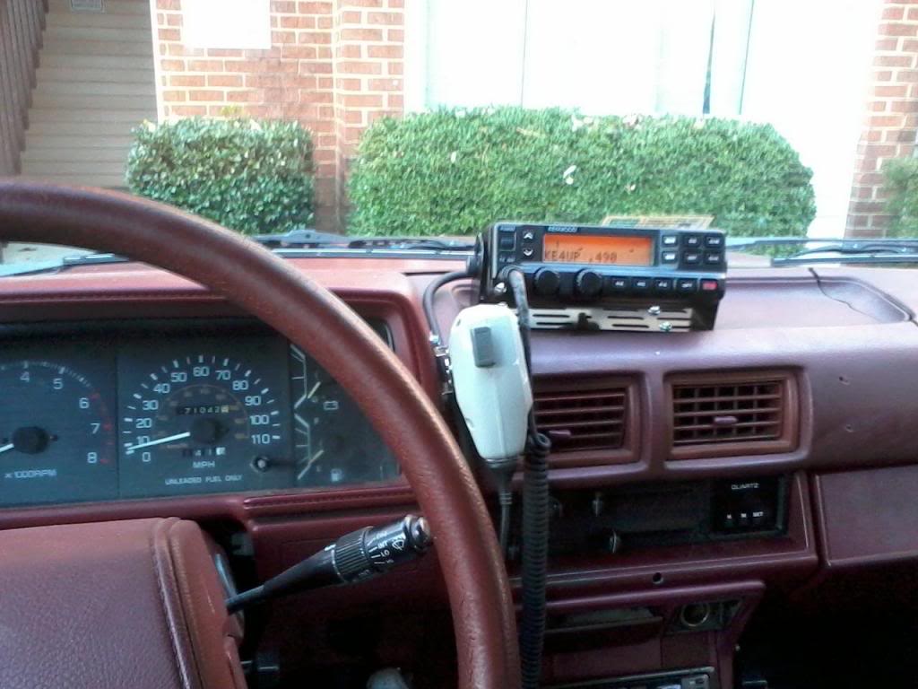

Control head for the Kenwood TK-790 VHF commercial Radio, and have a TK-890 ready to go in. Will be a Dual band VHF/UHF single control head. Also have an old CB that I modified to the 10m band in the truck now.

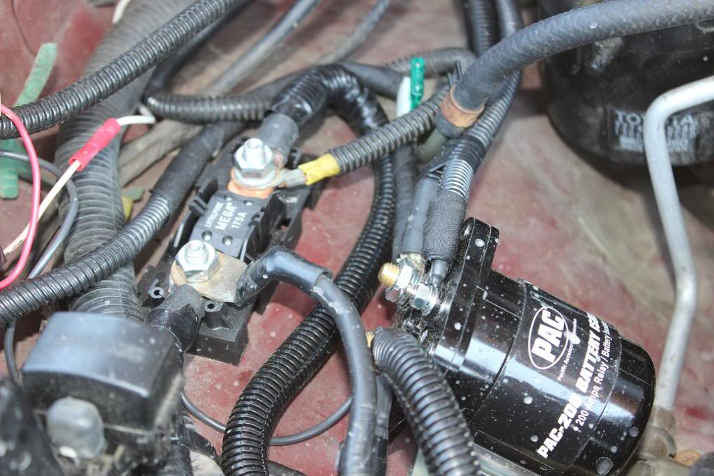

Next up dual remote battery setup. This will isolate the starting battery with the key off, so anything running in the truck will be running on a large group 29 commercial deep cycle/starting battery in the back. It will connect them in parallel when running to charge both of the battery's. it will also allow me to have a manual self jump start by hitting a switch. I am also looking to build a new center console for it really soon.

Although I have not had a lot of miles on these Duratrac's I have been impressed. They all balanced very well with very little wieght needed. They are surprisingly quite even at 65 mph. The stability of the truck, handling and ride quality are leaps and bounds above the 2 sets that were on the truck. Wet weather conditions seem to do well, but I can elaborate on that in the next couple of days as this Noreaster bears down on us.
I was hoping for some snow, but the last little flurry we had nothing would stick, maybe we will get some more in the next couple of days.
I will try to get into a little mud on Thursday to test them out.

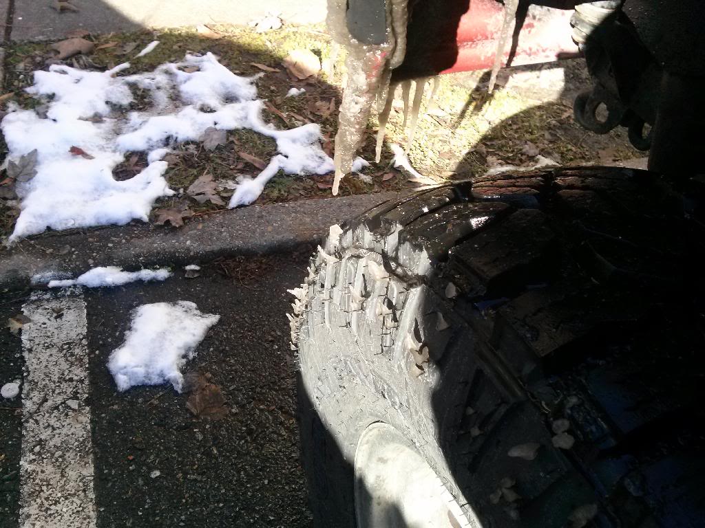

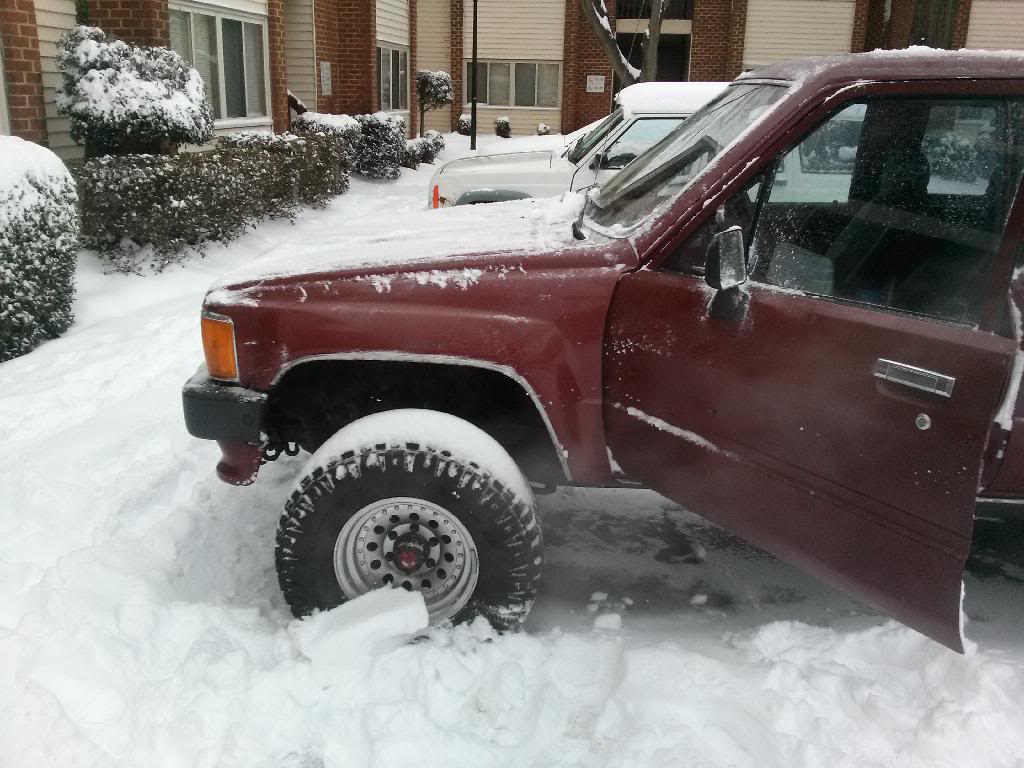

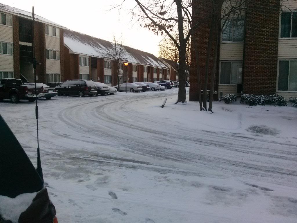

Snow huh?
Road into the complex was a solid sheet of ice, several days after the initial storm of the season, we had about 3 inches on that one, and several days of an hour or so above freezing and then a refreeze.

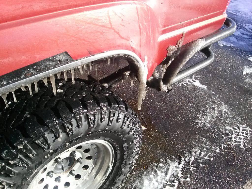

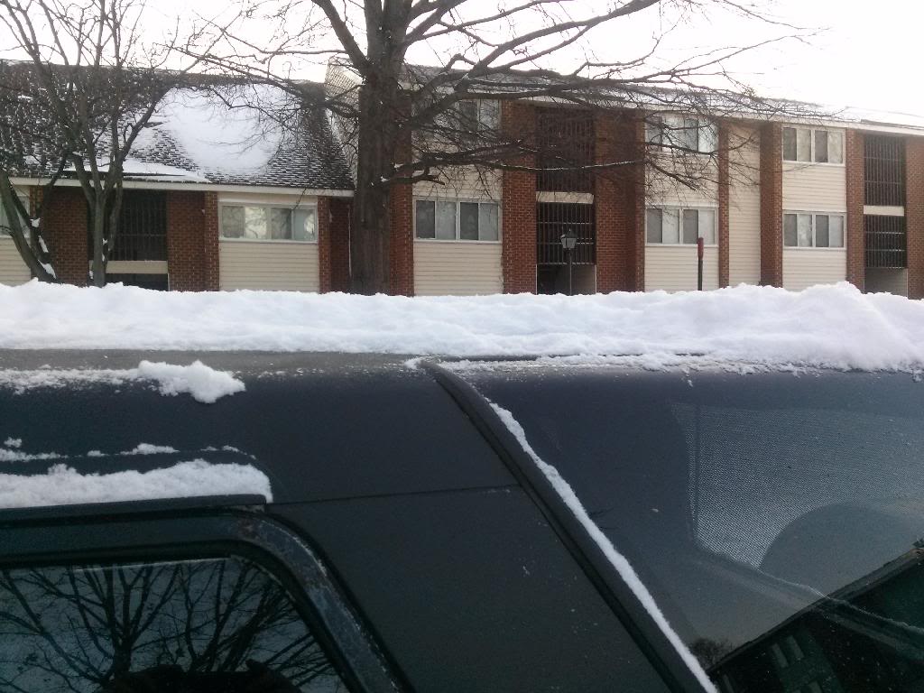

Second storm of the season, dumped about 9 inches of snow, this one had people all over the place.
So After action report, the Duratrac's have been amazing! Snow and ice is wonderful, water is wonderful, and they have done very well in the mud. I have haven't hit any deep mud holes, but been in some very sloppy mud where tractors normally sink in and it has done well.

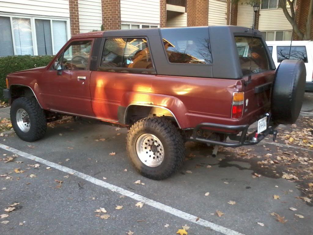

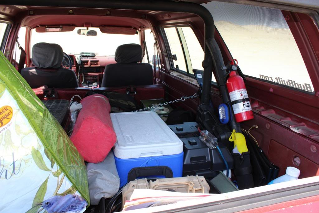

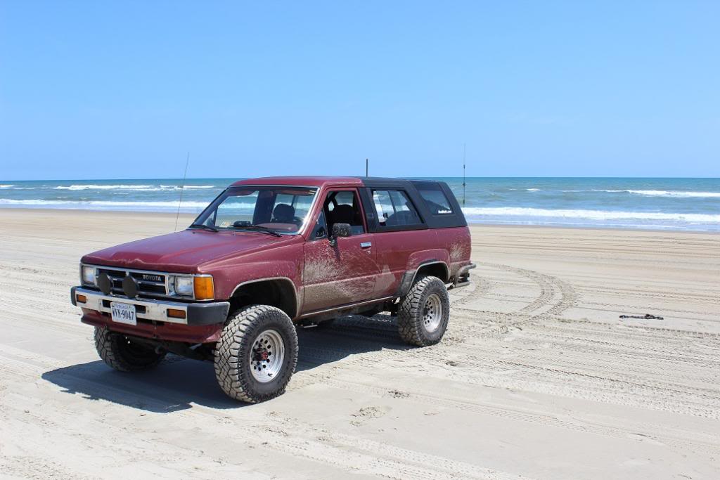

Well the Duratrac's do very well in the sand also. Made a topless beach run last weekend with my Dad following in his 4x4 Tundra. Early in the season, further up the beach you go the deeper the sand would get. The roads over the dunes were much higher than last year, since they have not been smashed down by all the tourists yet.
Couple of things that I have done, built a Bikini top, replaced the glass run on the passenger door that was bad. Ordered a battery hold down from Toyota, and installed that.
Let this be a place marker for a lot of work over the next couple of weeks. I have the last pieces on the way for the dual remote battery setup. Have the glass run to do on the drivers side. Custom made battery, ground, and starter cable for the starting battery. Bud built transfer case cross member with 2" drivetrain lift, new steering wheel. Tomorrow I am going to do a gas tank lift and some misc work. I have a trailer wiring harness off an F-150 with a 4 way and 7 way plug going on. 1200w power inverter with a remote plug and controls, and a custom center console.

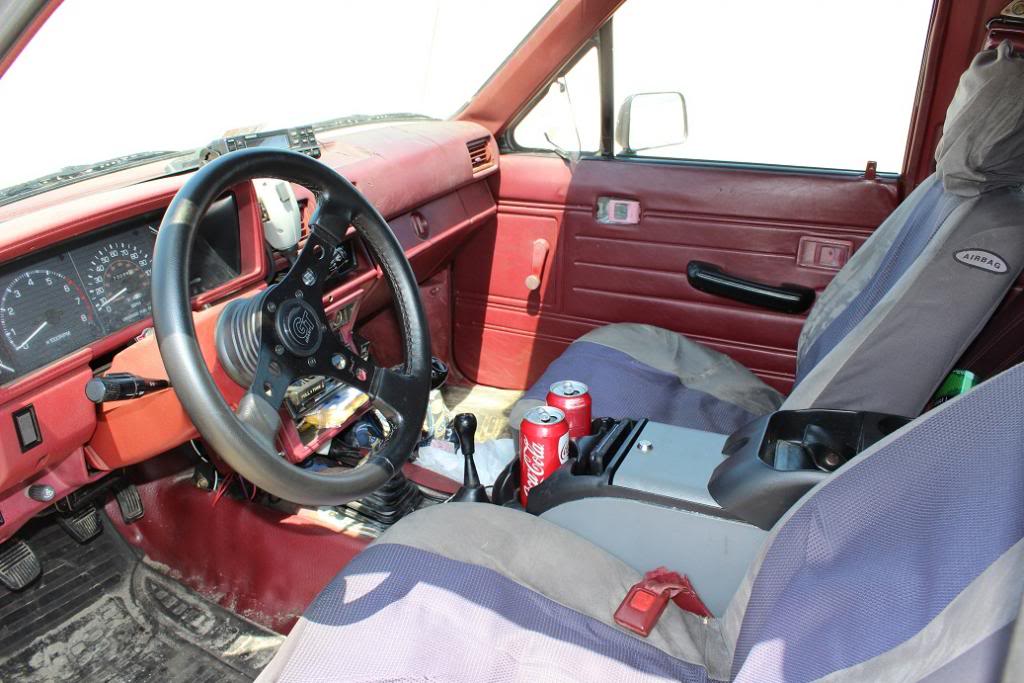

Got a clutter cutter center console that was given to me, well it was too long so a saw blade and some plastic epoxy later and I had a nice viable center console with cup holders!
New Grant steering wheel, much more comfortable than the thin one.

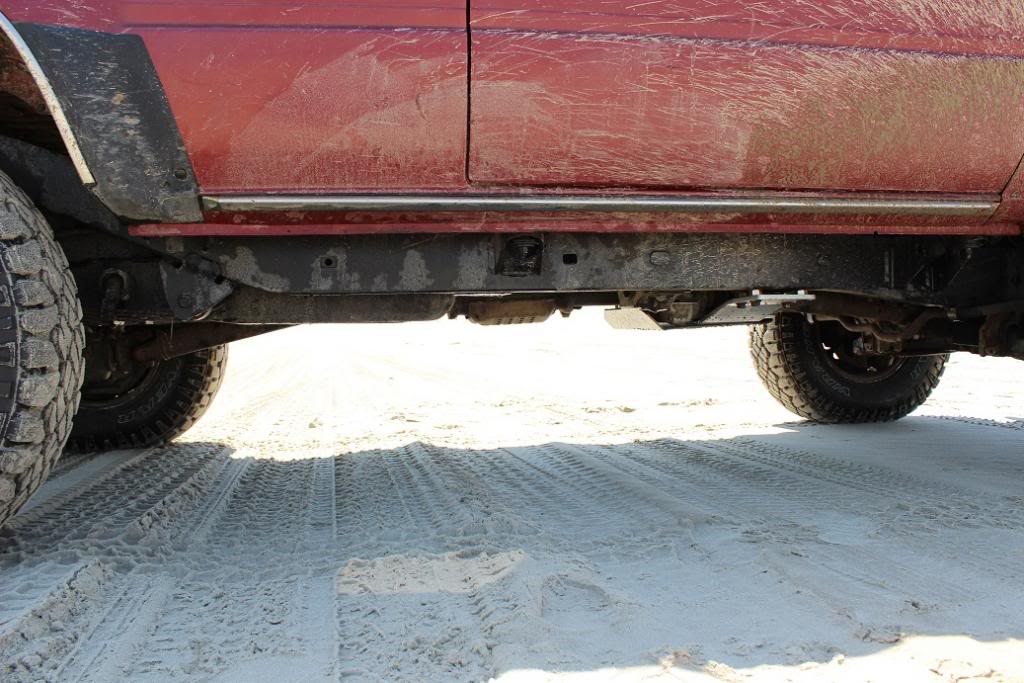

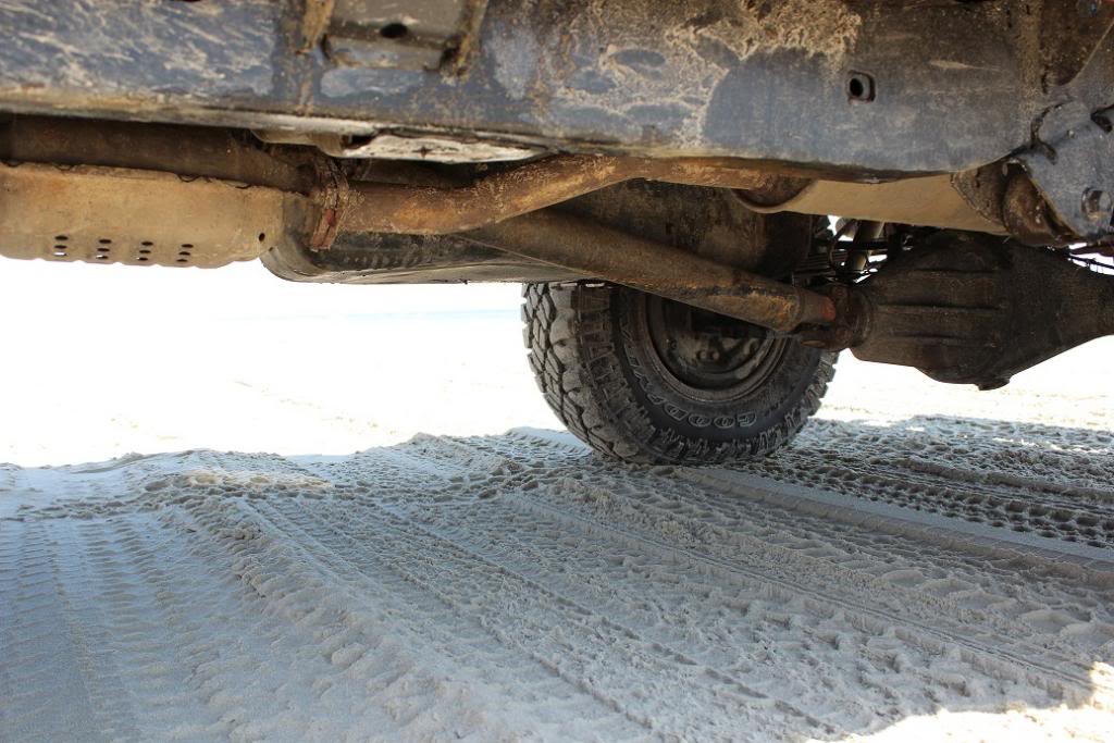

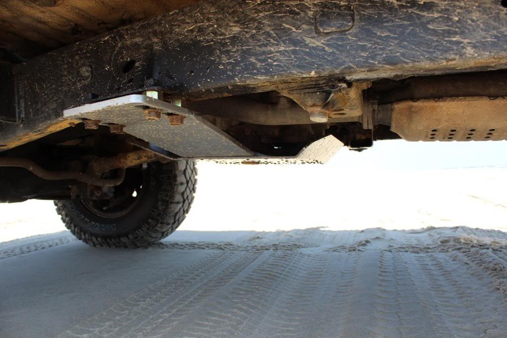

2" drivetrain lift Bud Built cross member turned out to be a bit much. The exhaust would hit the horse collar. Had to run some 1/2 spaces until I get the exhaust redone. But still have tons of ground clearance. Fuel tank was lifted 2". Still need to work up a skid plate for the tank.

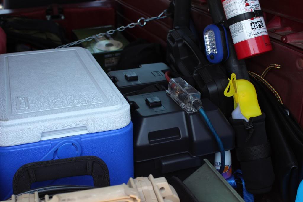

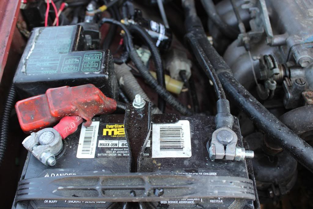

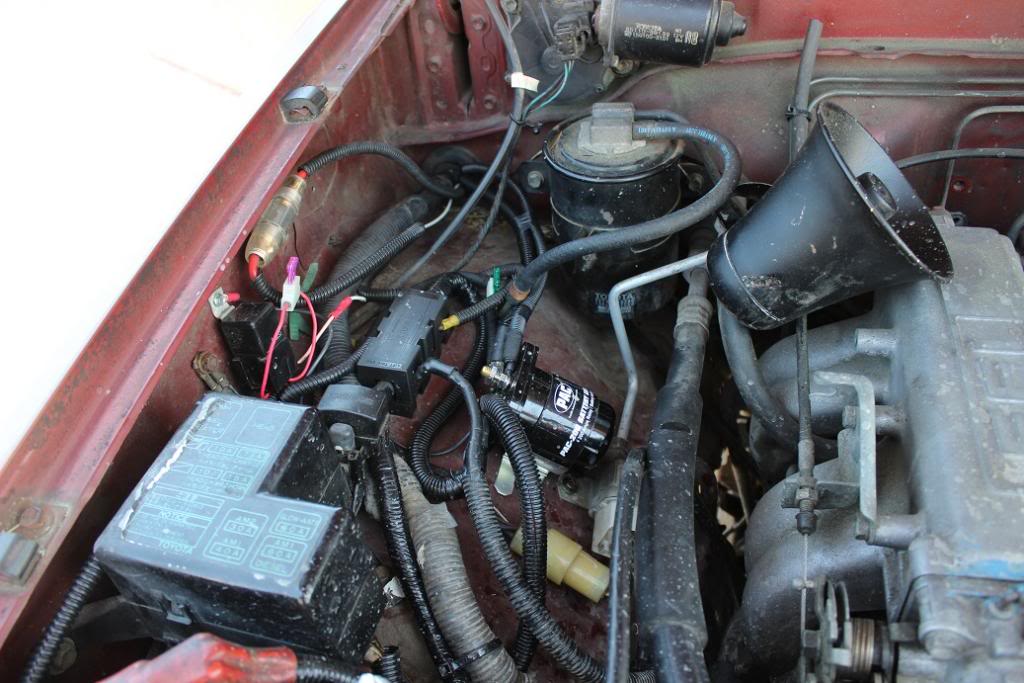

Upgraded battery cables, Battery Isolator, and large fuses for dual battery setup. 4AWG used throughout, was going to go with 2 awg, but the 4 awg ws free so I could not pass it up. Battery cables are OEM USA made 4awg, that was a take off on a damaged E350 van positive and ground cables. The factor ground cable was moved off the battery and attached to the firewall. The terminals are Napa Industrial terminals that are soldered, and heat shrink. The ring terminals are all high quality, crimped, soldered and shrink tubed. I was able to isolate the front battery and start the truck off the rear battery without any issues. So I do not think the voltage drop is going to matter. The battery is in a battery box currently, tie strapped to the roll bar. Soon to be replaced with SLA batteries in a custom holder where the spare tire was.

Here was the truck after a deep water crossing, drop is kind of scared me since water splashed over the hood. I have now decided that a PCM relocation and hidden snorkel is in order. I need to work on the rear springs since they are sagging, but camping and beach runs will be common. So after my trailer harness is on, and the power inverter is working I am planning on building the on board air, and I will be putting on some Air Bag helper springs to level it out, and work on getting the replacement leaf springs.
The 2 inch drivetrain lift made all the difference in the shifting, and transfer case operation. Makes the truck much more pleasurable to drive offroad. Many more mods to come, and hopefully some pictures of the truck in action.

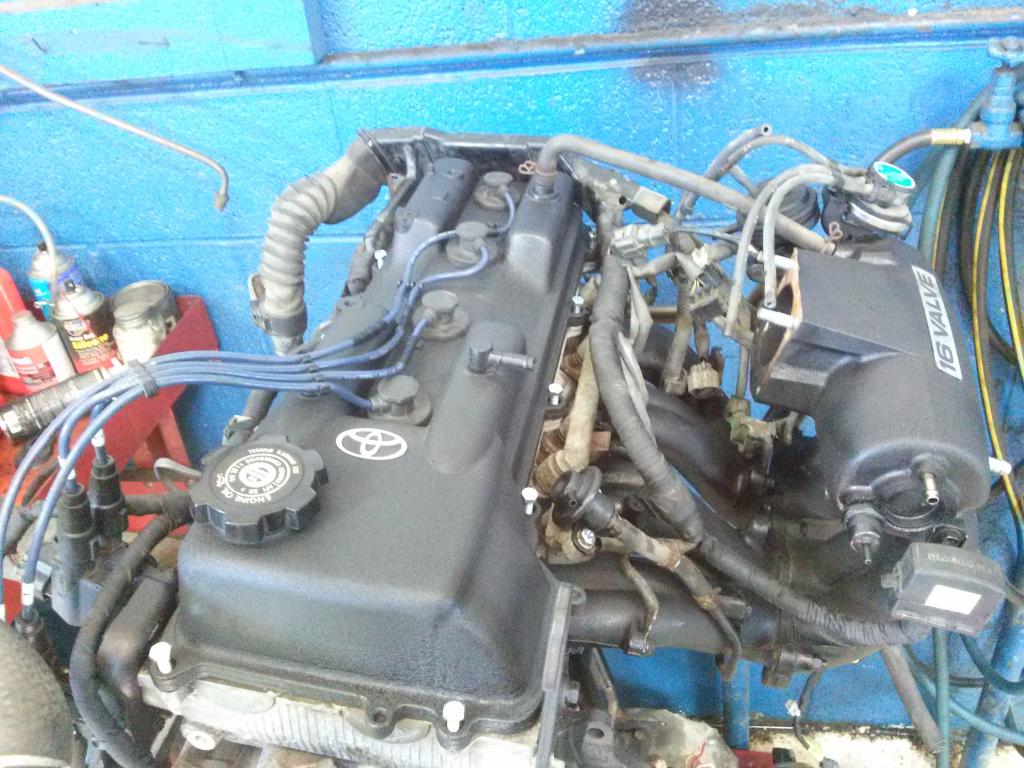

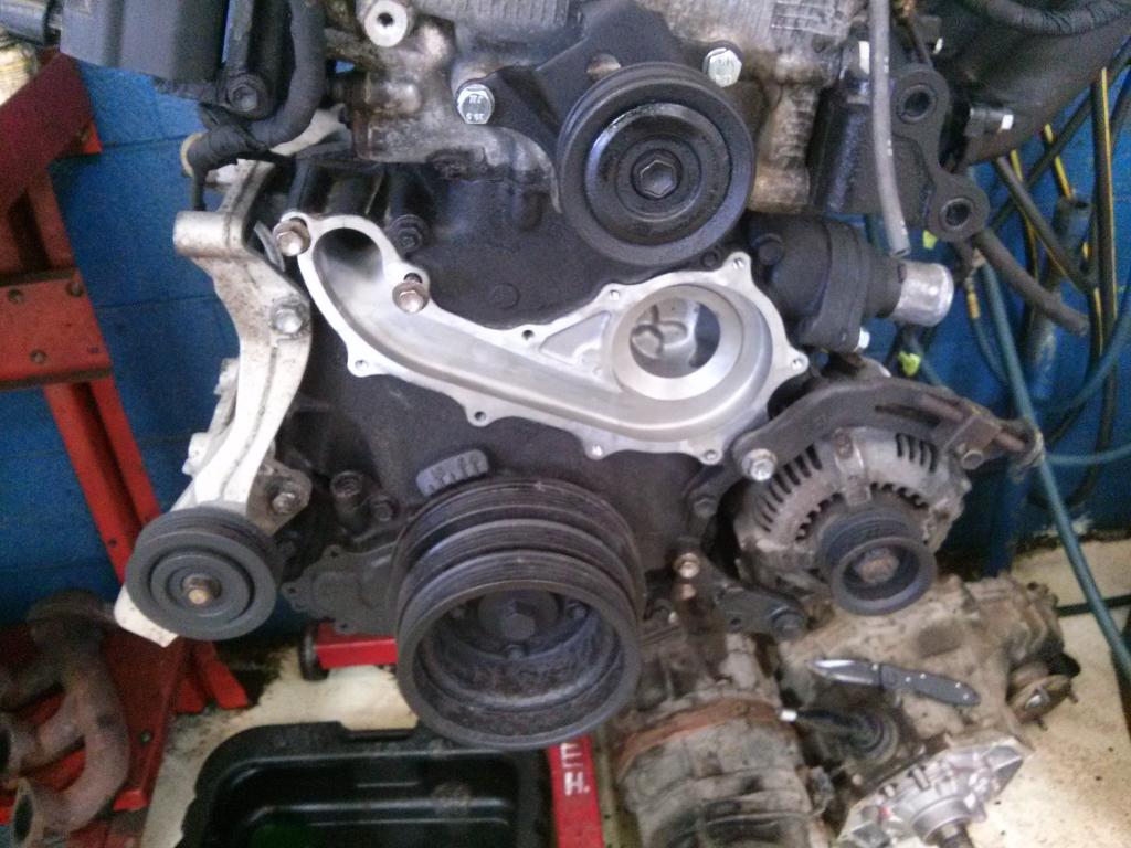

Well here is the 3RZ, a lot of cleaning up the NY rust. Waiting on a bunch of parts to come in to get the valves adjusted, put the finishing touches on the oil pan, and get the engine to sealed up.

About 1 Hour north of Newburgh. It was a bit of a drive but well worth it. Beautiful up there, just too bad all the city politicians making all the crazy laws. And the cost of living is crazy. I will stay in south VA where the weather sucks, but we have no emission testing, and where the Safe Act, would have been a War Act lol.

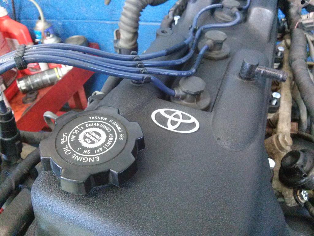

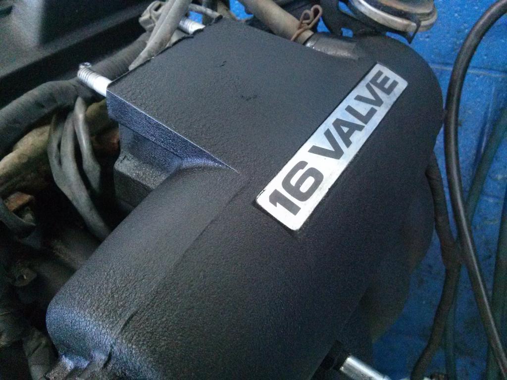

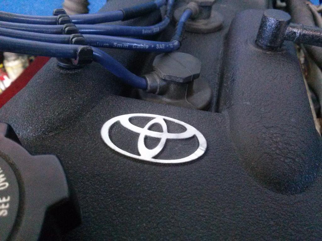

Got a bunch done, my parts came in from Toyota. I got all the valves adjusted and the exhaust cam torqued down. Oil cooler oring, throttle body and water pump gasket. The exhaust has been remounted. I was going to go with a header, but its going to have to wait until the engine is in.
T100 oil dipstick is in, and oil pickup. I have a clearance issue, so i have more fabrication on the oil pan than i thought i would. But i have enough metal to make it work, and to build some baffles. The only thing left on the base engine is to get the valve cover gasket set, some bolts for the water pump, and finishing the oil pan. Then i can move onto the PS pump, maf, custom intake, clutch, flywheel, starter, evap system, 02 sensors, slave cylinder, and compressor clutch.
Its the nickel and dime stuff that kills you!

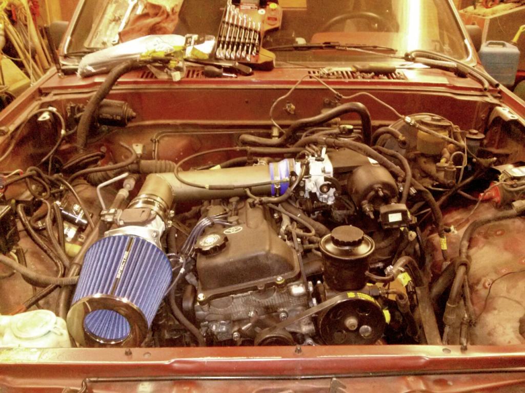

After a long day I made some progress. Ran into some clearance issues I was not expecting, and did not run into much where I was expecting them. The oil pan fit like a glove, with only millimeters to spare, I really lucked out on the pan. The pan did hit the steering stabilizer, so I will have to build a bracket to drop it an inch. One unexpected problem was my Budbuilt cross member, I have the 2" drivetrain lift cross member. Since the 3rz is canted, it rotated my transfer case, and it was hitting the cross member, so I had to build some spacers, and get some bolts. So I will be rolling around without my skid plate until I get the right type of bolts. I was also going to use my AC compressor and change the clutch, well mine is too long and hits the motor mount, so I will have to get a new compressor for it.
Still have a lot to do, but the drive train is buttoned up, going to do some more hoses, clutch lines, down pipe, and wiring. Hope to fire it up for a short time tomorrow, then move on to fabricating the exhaust.

Doint 2.25" exhaust, with a Magnaflow Heavy Metal Cat Converter, and Magnaflow stainless muffler. Also have new down pipe, all new tubing, new Aisin Clutch and slave cylinder, new Luke flywheel. New Denso O2 sensors. Cant wait to get this thing on the road.
