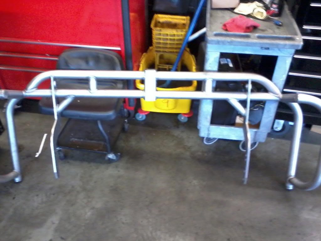

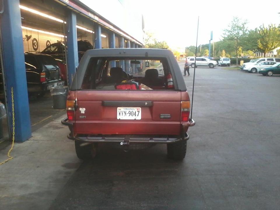

A nice little present came in to work today for me!
Got it on during my lunch break and got a coat of paint on it. I will post some pictures of it tomorrow when I get the new mirrors on.

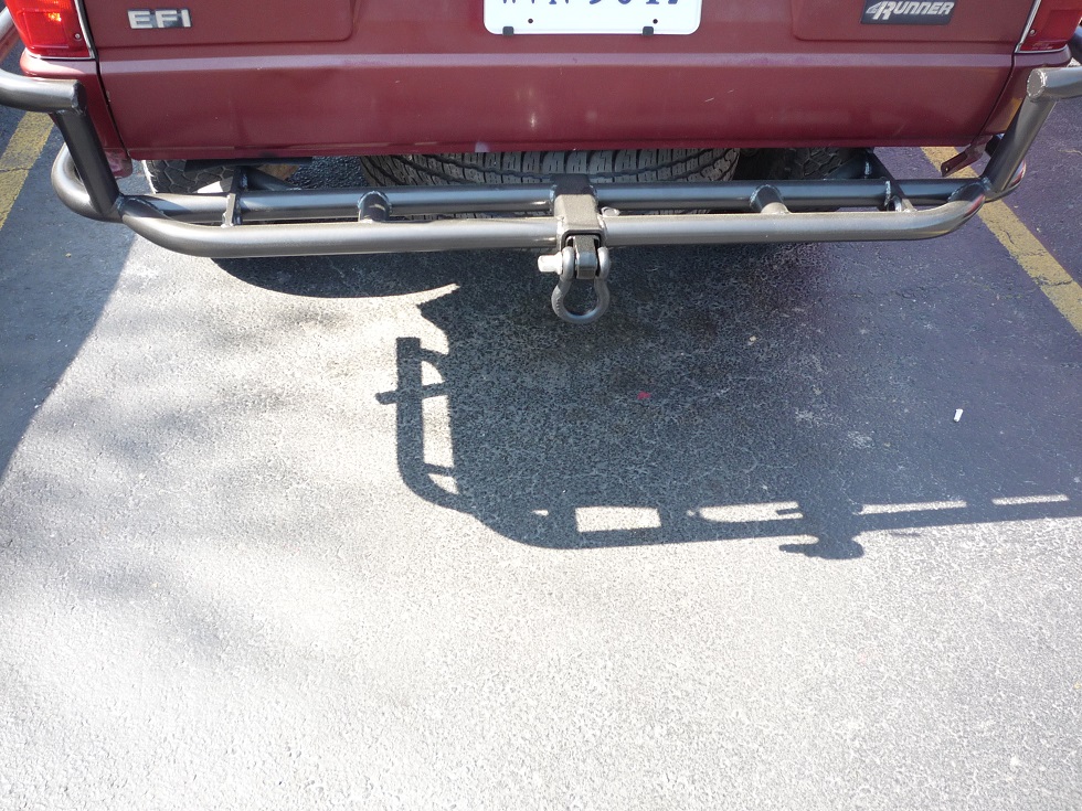

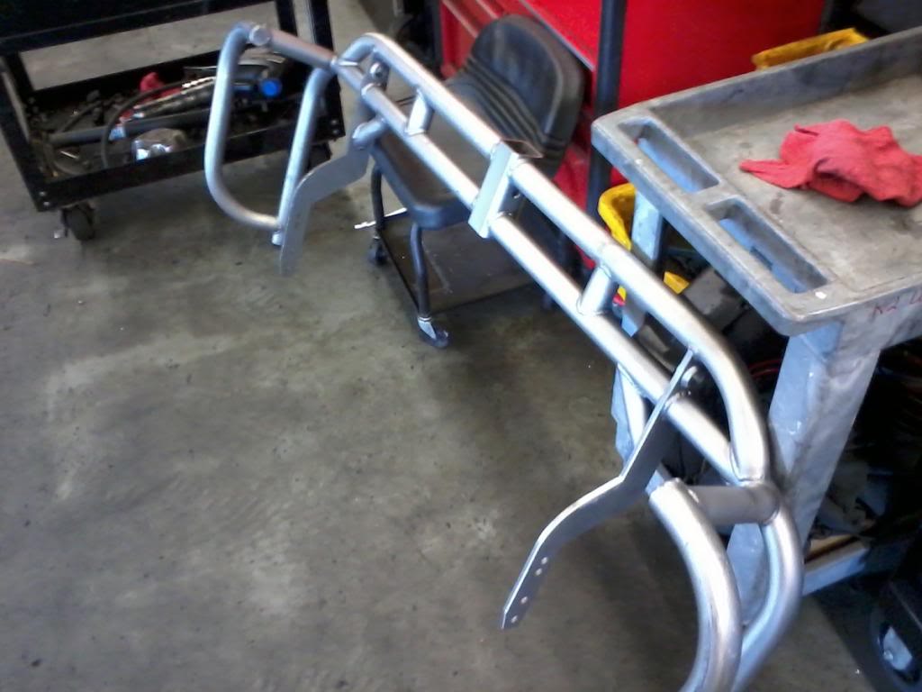

Here is the bumper mounted up with one coat of primer and paint. I have some more work to do on the bumper. I still have to mount and weld the upper supports, and weld a light bracket on the corner for an antenna mount. Got my first parts today for the swing out tire carrier, but it will be a couple of weeks before I can get to work on the welding.
Got a bunch of parts and work to do but not enough time!

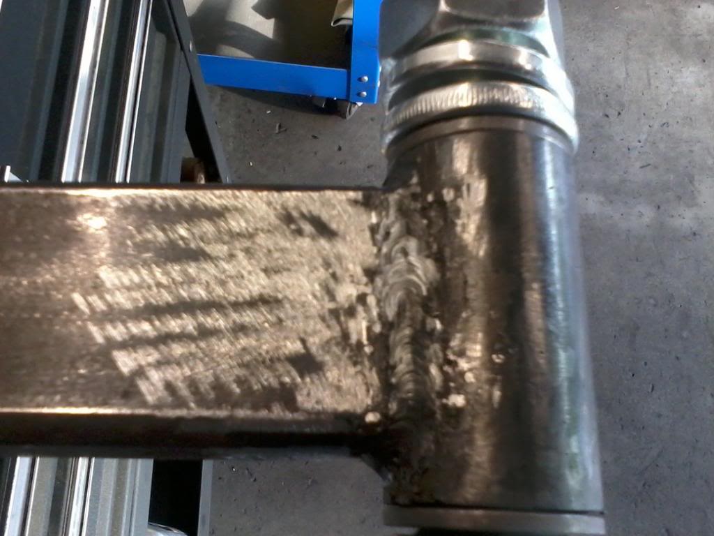

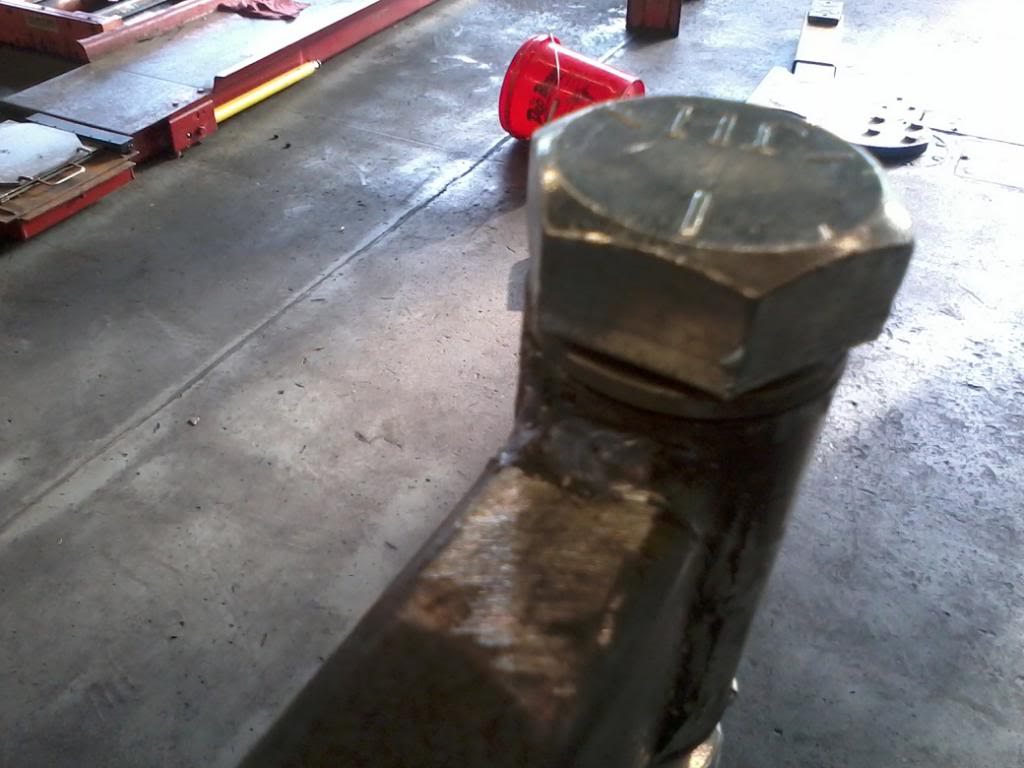

I am going to use a 2x4 box steel for the swing arm, welded to a 1.5 inch dome tube uses for the hinge. The tube will have bronze flange bushings reducing the ID to 1 inch. I will use a 1 inch grade 8 bolt in a double sheer configuration.
I think the idea I have will be a little different, but not crazy. There will be some design aspects to prevent oscillating loads and hopefully make this thing like a tank.

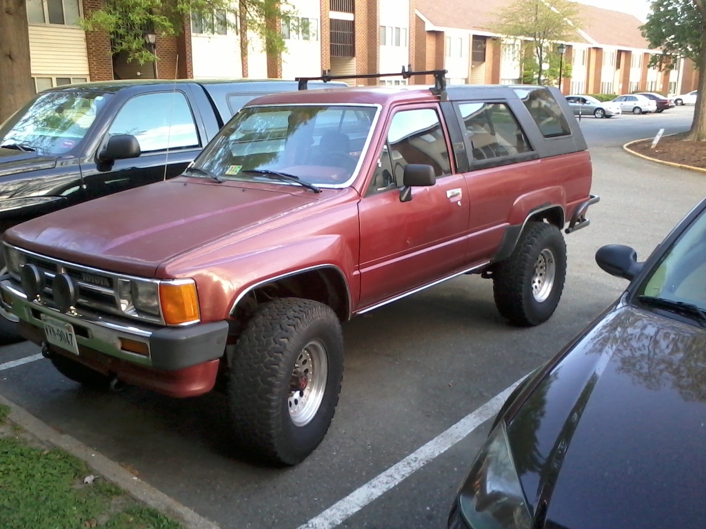

I guess it is time for an update.
I got a set of decent BFG AT's in 32x11.50-r15 so I decided to put them on the Outlaw II rims the truck had when I bought it. They have a little dry rot, but a bunch of tread, so hopefully I can run them the rest of the summer and upgrade them later.
I think they look better than the Taco rims I had on it. Of course the mirrors have been replaced now, and I added a couple of cheap offroad lights to the front bumper. Still need to run some wiring. Have a bunch of parts here waiting for the time to be put on.

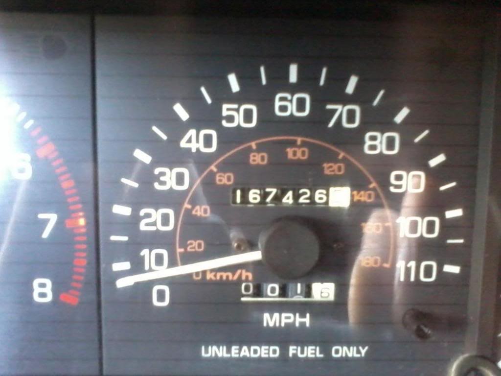

Also got the SR5 Cluster today, it was in rough shape but for 45 bucks shipped from the west coast I cannot complain. I tore it down and swapped my odometer into the SR5 cluster, adjusted the tach, and added some LED backlights.
Overall I love the guages now, much better than putting a little crappy tach in there.

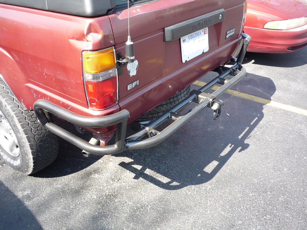

Well I got to use the bumper today!
I was driving down a rural road after I left school this afternoon, and I see an older gentleman that had his Dodge Ram 2500 diesel with the LF tire in the ditch in his driveway. The RR tire was off the ground and he was almost high centered. So I pulled over to give him a hand. We hooked his tow strap up to his hitch and to the D-Ring on the bumper. Locked the hubs and put it into 4lo and pulled him right out. Wasn't a difficult pull, but it is a heavy truck.
Only reason I even put it in 4 low.... 32's on 4:10 gears, figured the extra torque of the low gear would help, and it did. So he is thanking me, then asked if it was possible to pull out his tractor?
Aparently he was mowing the lawn with his midsize tractor with a rear mower attachment, he was on the edge of about 5 foot deep drainage ditch and slid in. Well his wife grabbed the Dodge to pull out the tractor and she slid in with the LF tire. I did not even see the tractor. It was buried to the axle with about 40" tractor tires.
He was at a right angle to the driveway, so I backed down the grade just a bit, and angled the best I could. We hooked up and I started pulling, it was pulling the tractor out sideways. This was was straining a bit, but when it came out far enough he was able to cut the front wheels towards the yota and she came out with little more effort. I wish I had some pictures this tractor was deep in the ditch.
He offered to pay me, but I refused. He complemented on the truck, and the bumper. He was telling me that I probably did not need to lock the hubs and kick it into low. But when I responded that it was only a little 4 banger he was shocked. Anyways him and his wife were great people and I was glad I could help.
Bumper is good to go! Oh and for the truck

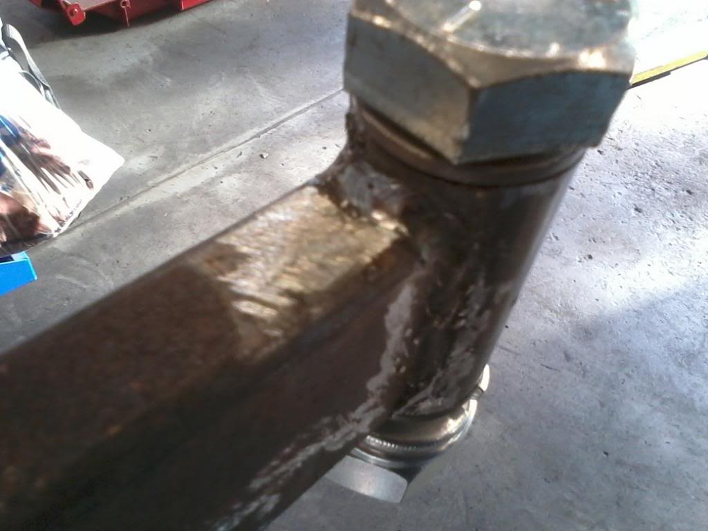

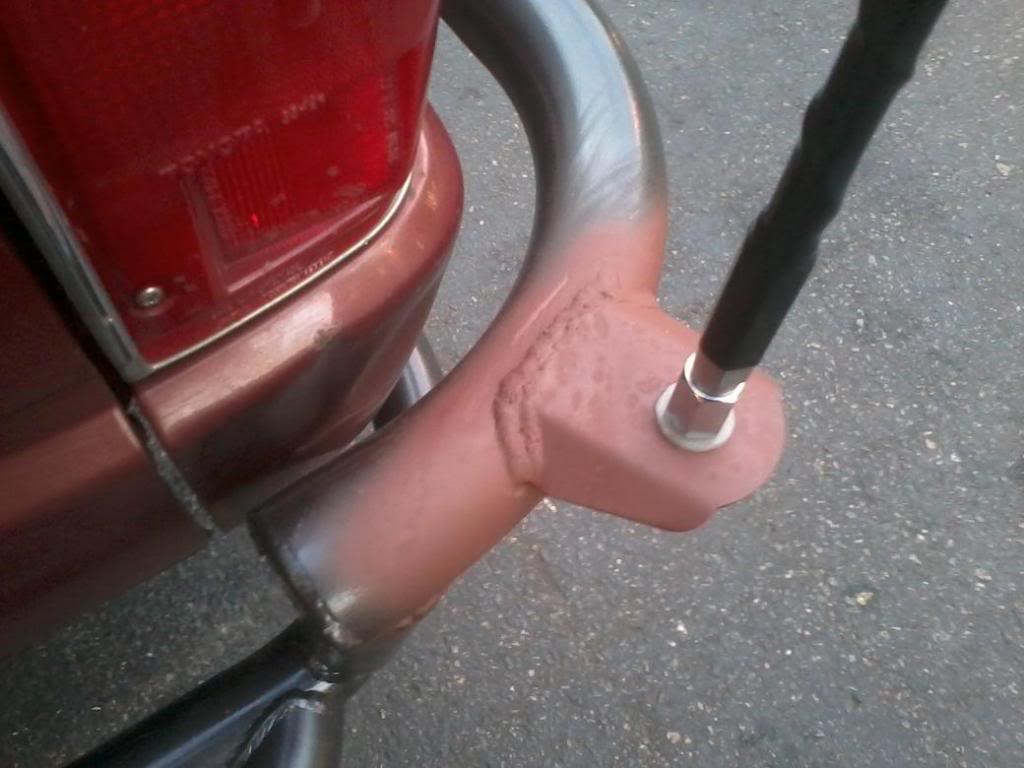

Ok so I have made some progress. Made it to my buddies house to weld on an antenna mount and the front supports for the bumper. He had a nice Mig machine, and I had not welded in about 10 years. Well I caught the bug again. I was saving my penny's for the soft top but the timing chain is needed ASAP, so I splurged a little to get this thing trail worthy for now.
So had to do 2 passes to get the light mount solid, not the nicest welds but they have full penetration. So I purchase a little stick welder!
I ordered a small Northern Tool ST80I stick and Tig welder. This thing is small but it is powerful for a 110v welder. So I started to work on a piece of scrap to get the swing out tire carrier fabed up.
This was the first time ever stick welding, I jumped in with only 3 practice beads before this, well and a lot of you tube instruction video's! I am happy with the results. I hope to get the steel I need this week and begin the fabrication of the carrier.

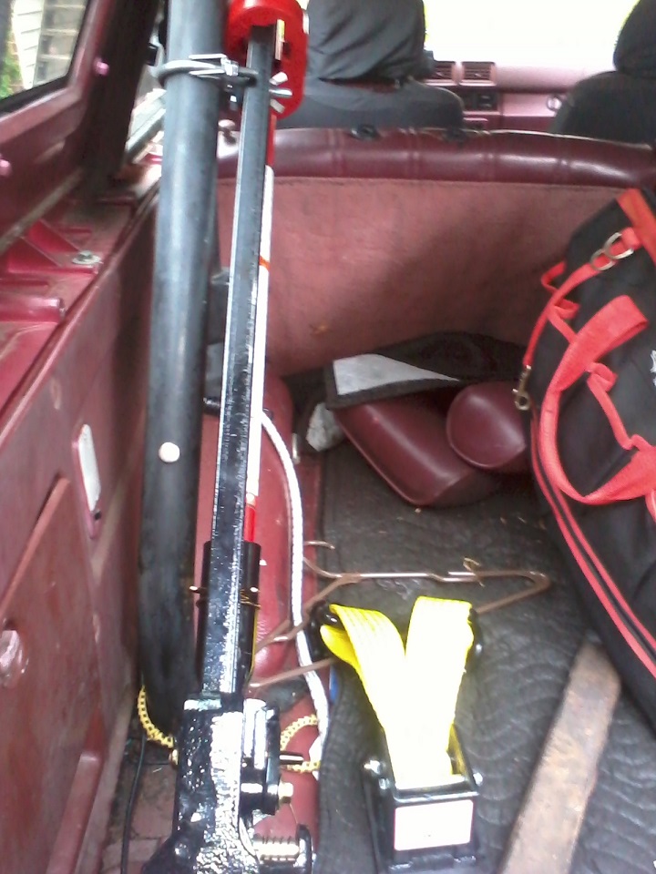

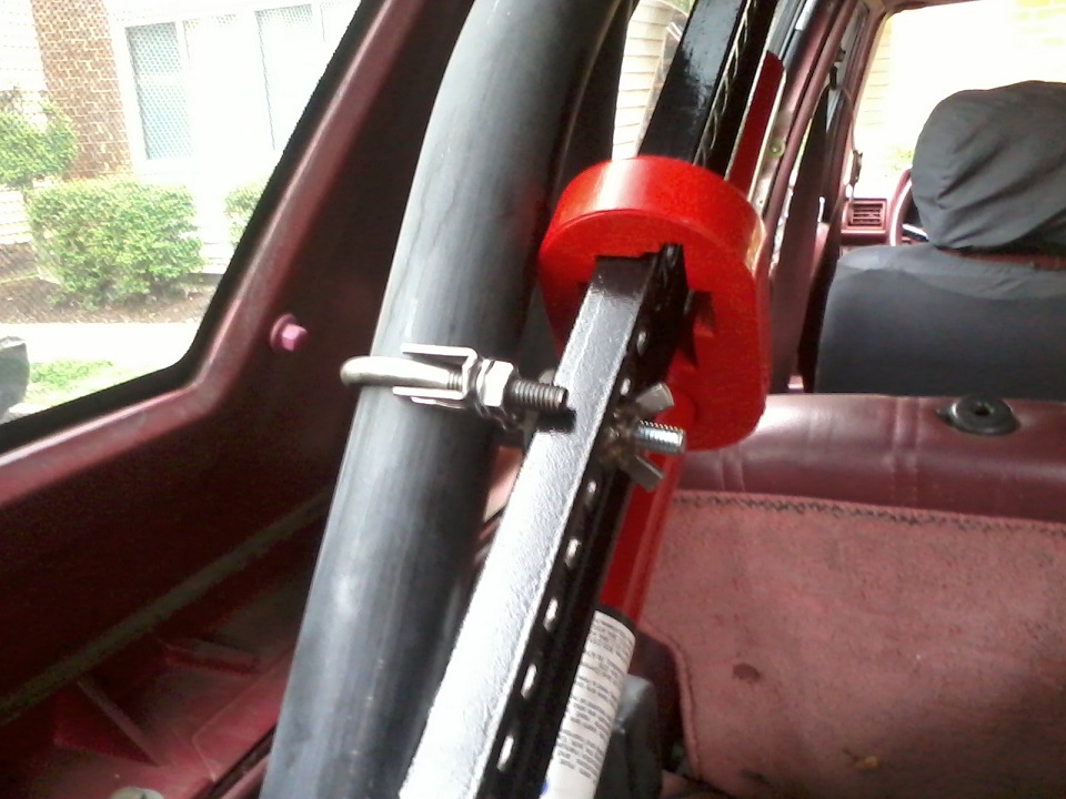

Today I picked up a high lift and build a mount for the roll bar. Very simple, used a 2" exhaust clamp, and a 3/8 2" bolt welded to the clamp. I then used an old sway bar end link bushing as an insulator. I then welded a washer on a wing nut. I plan on finding a nice large plastic wing nut to replace the small one, and use a neoprene washer on the back side of a fender washer.
Well hope to have some pictures later this week when the front end kit comes in, and I get the front half of the motor torn apart.
