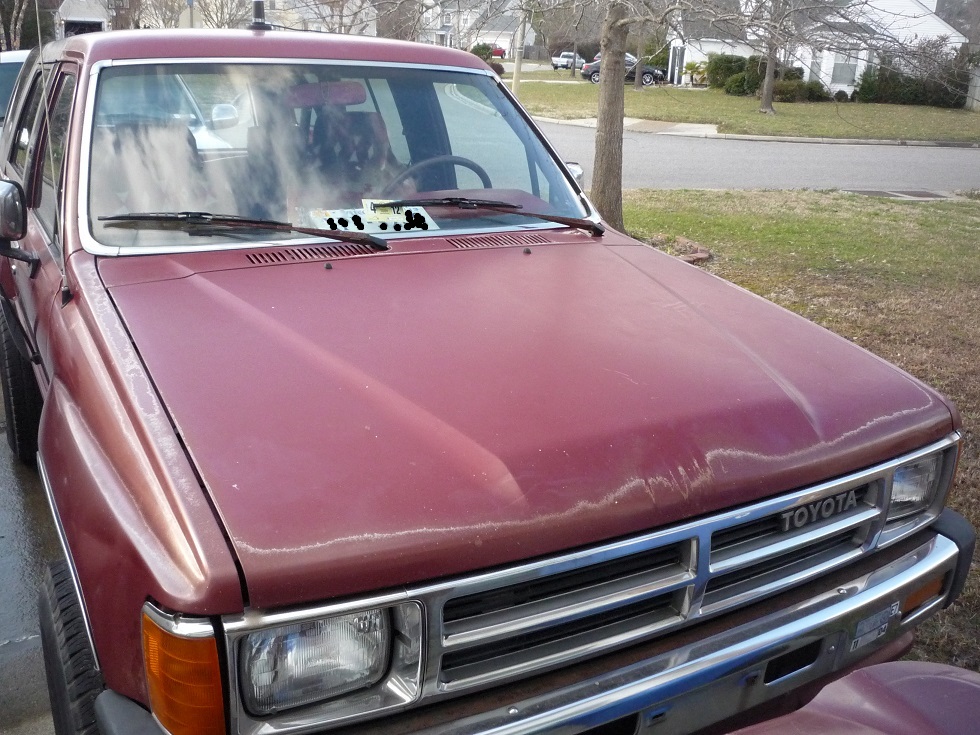

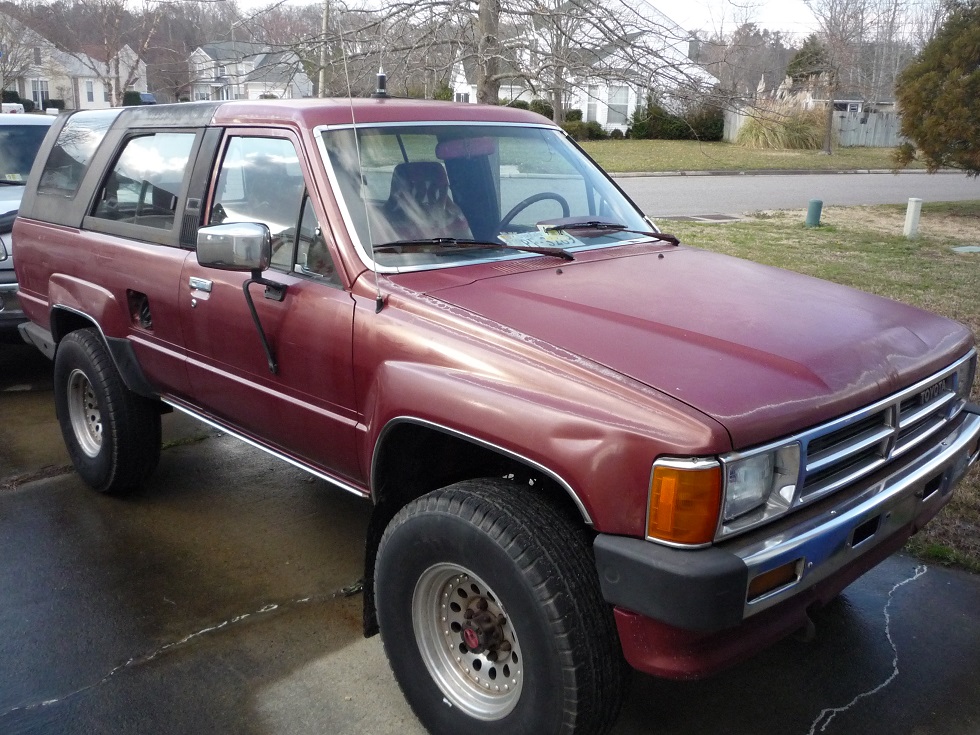

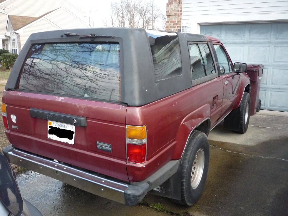

So I have been down to 1 vehicle for the family for a while, and have been looking for a second vehicle for some time. Currently the only one in the household working, and I am going to school full time. I had been looking for some beater ranger just as a backup vehicle, mainly because they can be found cheap around here. I have owned a 91 2wd little lowrider truck (First Vehicle and all) and an 89 truck with 35 inch tires. I loved my yota’s but the resale is so damn high on them I had not really considered looking for one.
I had a rifle listed for sale and happened to be contacted by a retired navy chief that had a bunch of vehicles and asked me if I wanted to trade for an 89 runner?
I really could not beat it, but the total value I had into the rifle was about 500 bucks. The truck was rough, had been sitting for a while and someone stole the battery out of it. But mechanically the motor and drive train are very strong. I threw a battery in the truck, and put some gas in it and drove it home. There were about 10 lights out on the truck, and the first thing I noticed was the gas gauge was not working and neither was the cooling gauge. The battery and brake light were coming on indicating a charging issue.
I drove it to my dads house and parked it knowing that it was going to need a lot of work. The tires were shot, the shocks were toast, it was squatting in the rear. There were all kinds of electrical issues, and one hell of a drivetrain vibration. Oh and as you can see the fuel door is missing.
So it sat there for a couple of days before I could get back over there to start the work. When I got over the battery was dead! So I started some parasitic draw testing, old aftermarket alarm was causing a 240ma draw, the alternator was causing a 5 amp draw!
So I started with an alternator, put a set of Rancho 5000’s on the front, changed a bunch of fuses, and pulled the cluster to find out why the dash lights were not working. I fixed a bad ground on the cluster, put a new cooling sending unit, and new thermostat, since the old one was stuck open.
I borrowed a set of spare rims from my dads tundra and drove it to work so I could get it on the lift. Found it needed a rear U-Joint, both lower ball joints, wiper blades, a headlight. So I went ahead and fixed that stuff, got it inspected and started driving it.
All I can say is I love this runner!
Attached Thumbnails Stanprophets Beater 89 Build-truck.jpg   Stanprophets Beater 89 Build-truck2.jpg   Stanprophets Beater 89 Build-truck3.jpg

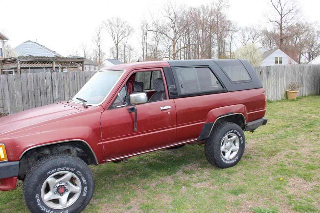

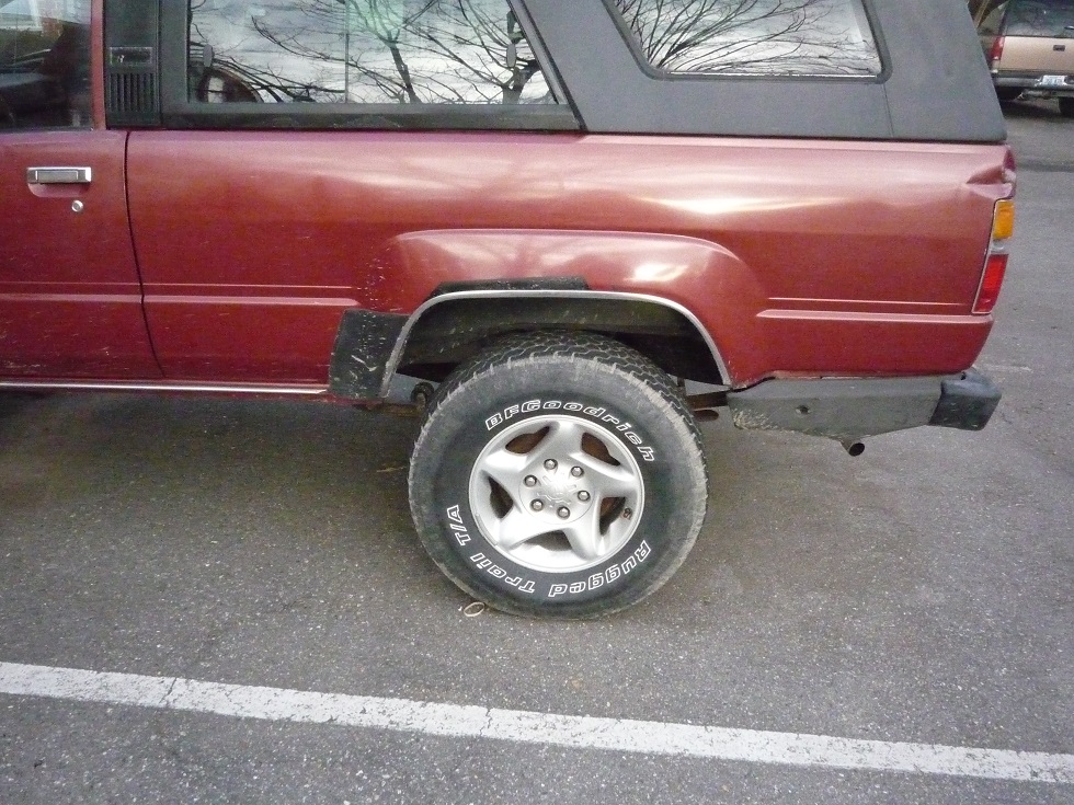

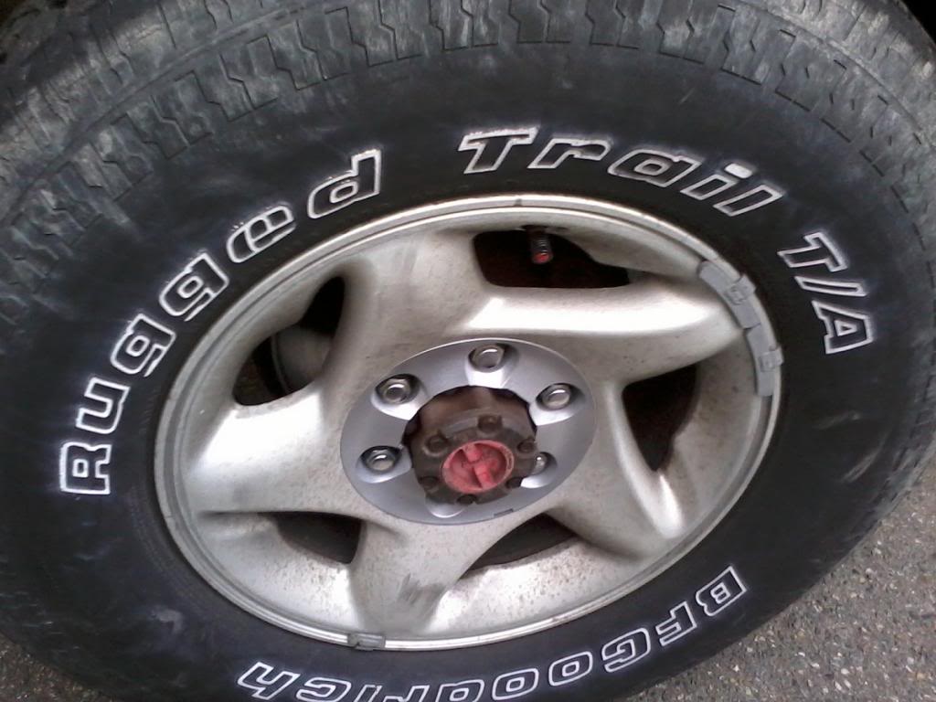

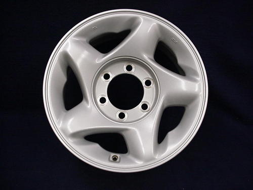

Last night I made a run to pick up a set of rims and tires from a leter model Tacoma. The guy had them on CL for 150 bucks with tires. So I hauled my but the 30 miles north and kindly paid the guy cash!
This style of rim
Guy had the center caps and lug nuts, with 4 good tires on them!

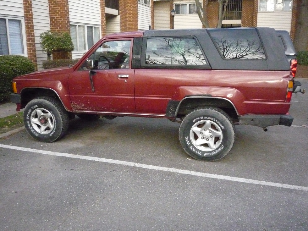

So today I took a trip down to my dads house, and changed out the rims, put the AAL on and installed the Viper alarm.
The old rims were aftermarket with 31x10.50's on them, I am now running 265/70/16.
So far it rides sooooo much better, and looks a ton better than it did. I am still waiting on the Rear Shocks to come in, and the fuel door I just found on this forum.
I still have to wire in the door actuator, and relays so I can roll the rear window down with the alarm.
Attached Thumbnails Stanprophets Beater 89 Build-rim.jpg   Stanprophets Beater 89 Build-p1020019.jpg   Stanprophets Beater 89 Build-p1020020.jpg

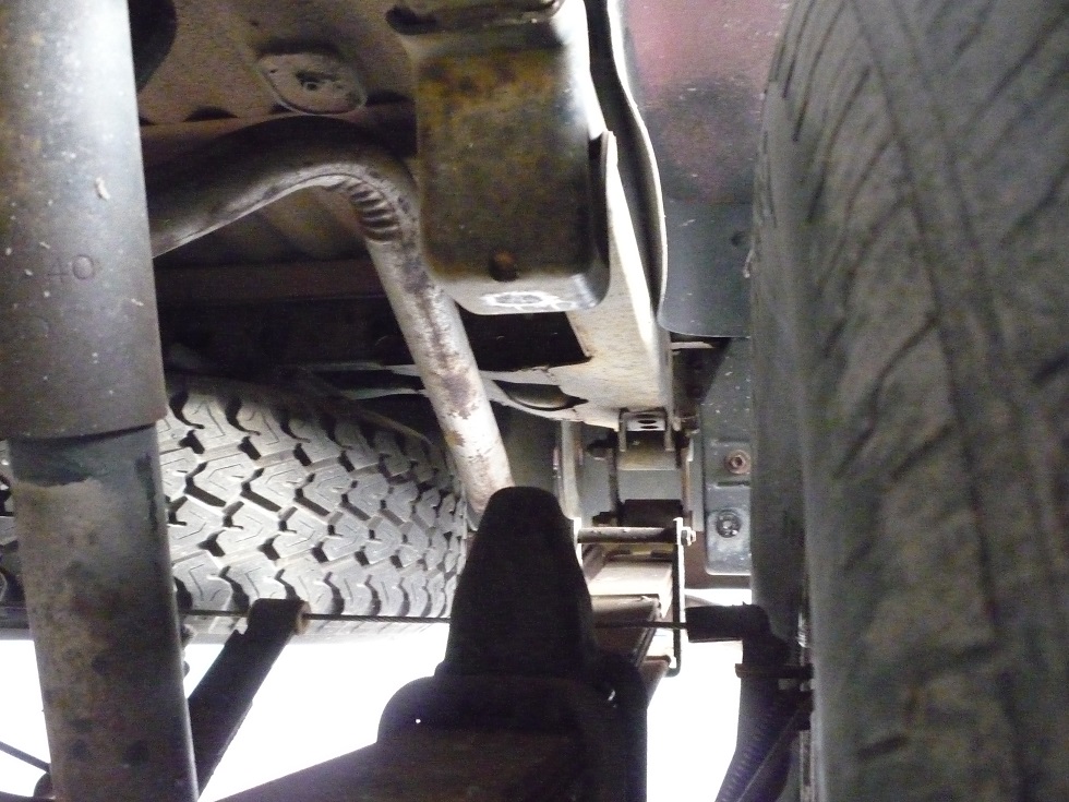

Here is a couple of more picutes, I has about 1.5 inches before the bump stops hit, and boy did they hit. And the leaf springs were flat on the overload spring. Now it is much better!

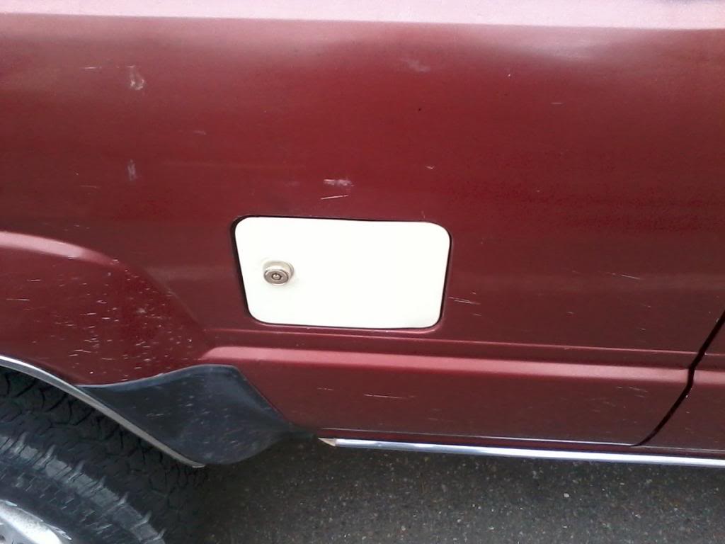

While I was working on that and relocating my antenna, the fuel door came in.

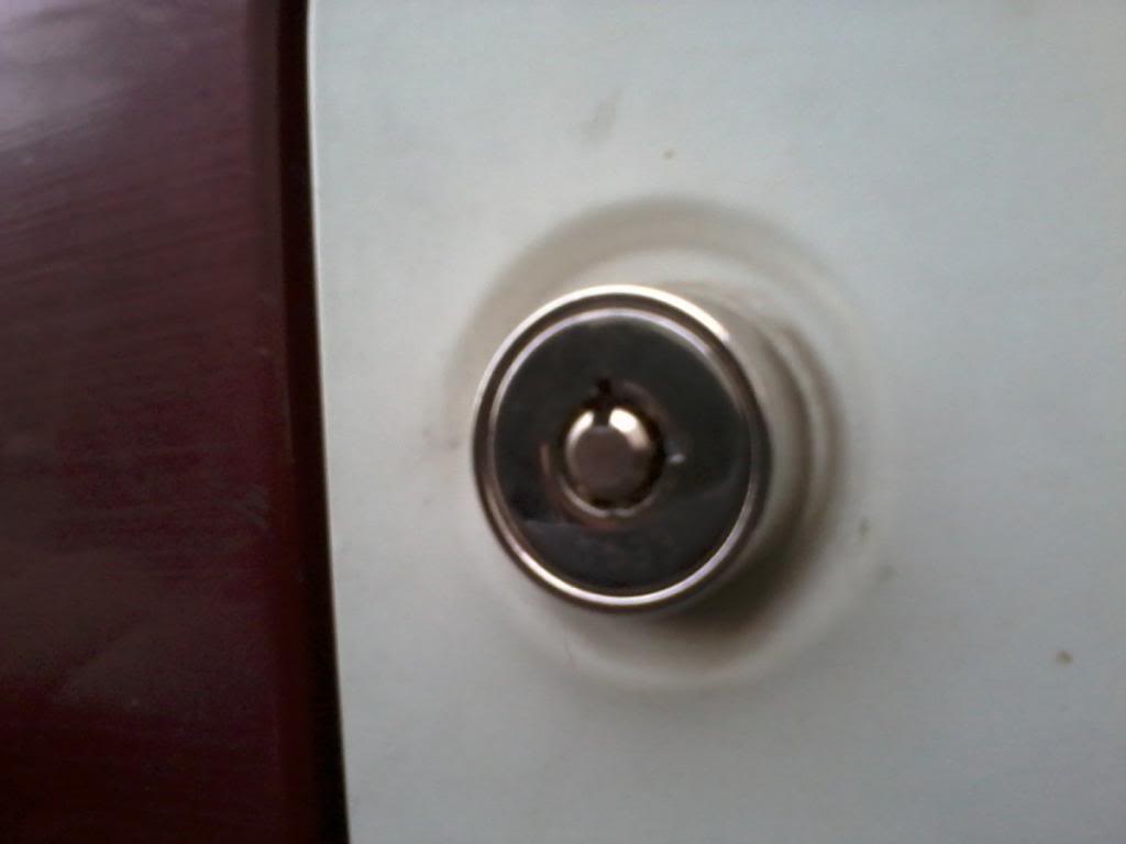

It did not have the lock, so I ran down to work and found my extra Snap-On tool box lock and some spare latches for the rear. To my surprise it fit the hole quite well. With a little cutting and bending I was able to get the door to work fine. It is too long to work with the interior door release, I will address that later.
I like the look of the high security lock, I need to do a little work to the door since the post guy bent it a bit to get it in the mail box. I am also going to paint it just a flat black.

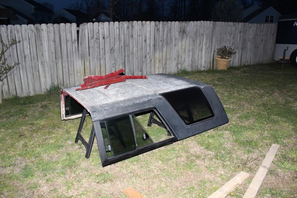

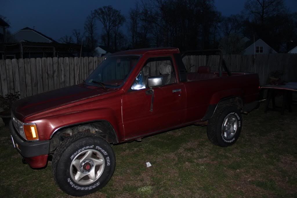

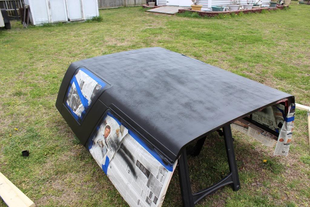

Pulled the top last night so I can refinish the top. It has seen better days, so I am going to spray it with bedliner.
I love this thing running topless, and I am highly motivated to get the soft top.
As you can see the fiberglass is not doing too well.
Ordered a trail gear rear bumper on Friday from Addicted Offroad, so hopefully it will be in soon and I can get it on there.
I will post updates when I am done refinishing the top.

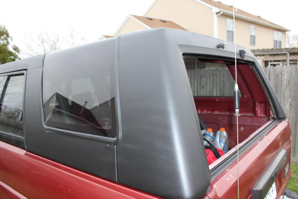

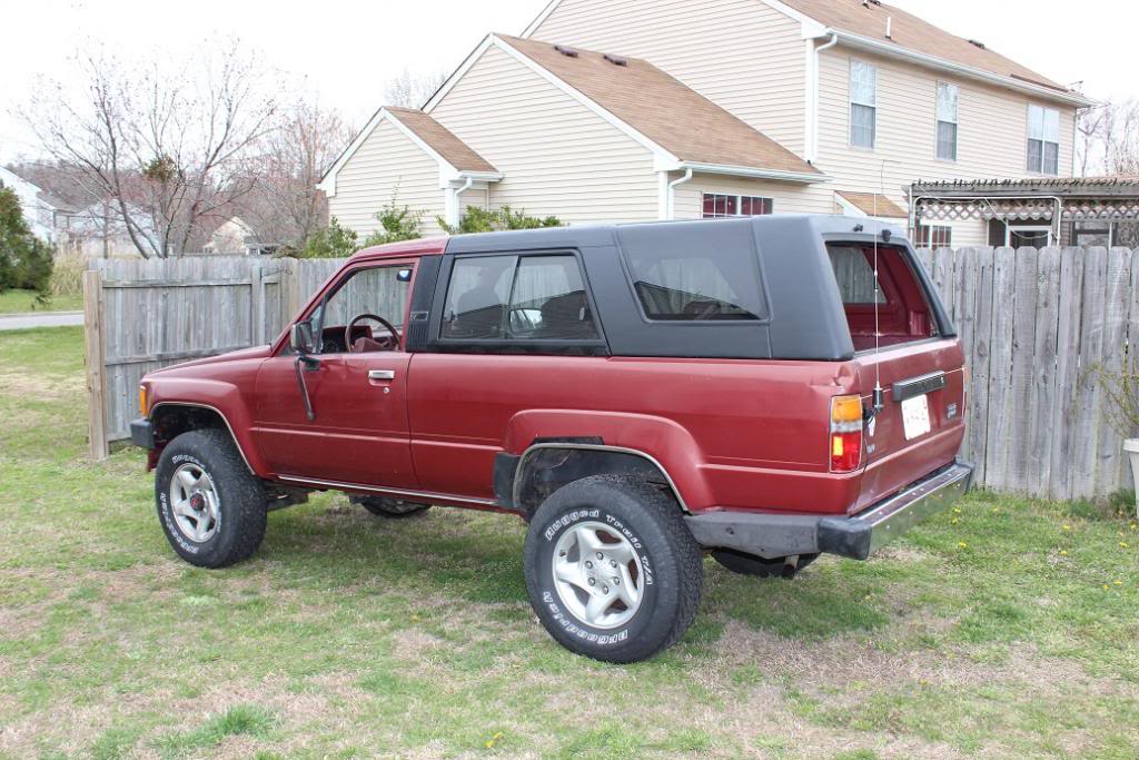

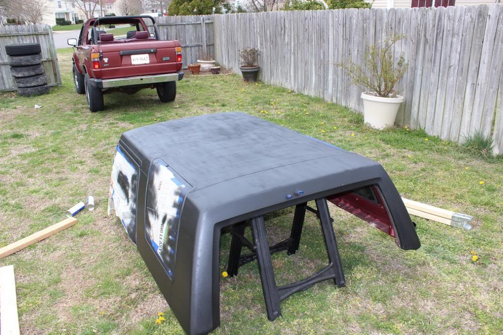

Well got the top sprayed with enough time before the rain that is suppose to get here. I still need a second coat for the top.
I can say that driving this thing without the top was awesome! I am sold on getting a soft top kit for it.
Although the top is not perfect, it looks so much better than what it did before. Plan is to hit it with a second coat on the top, then look at painting the top with a satin black with an HVLP gun.

Overall I am very happy with how it turned out.
