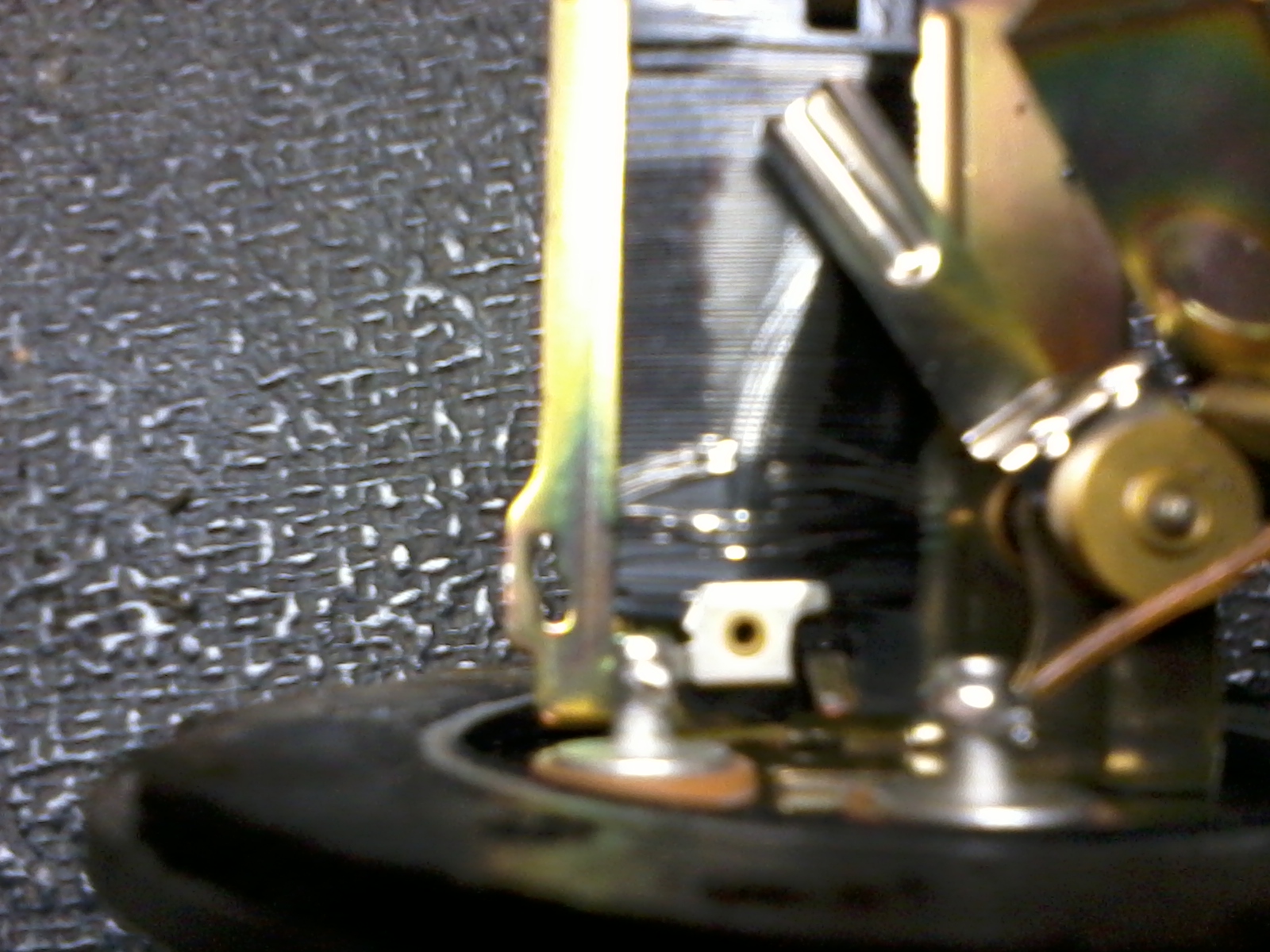

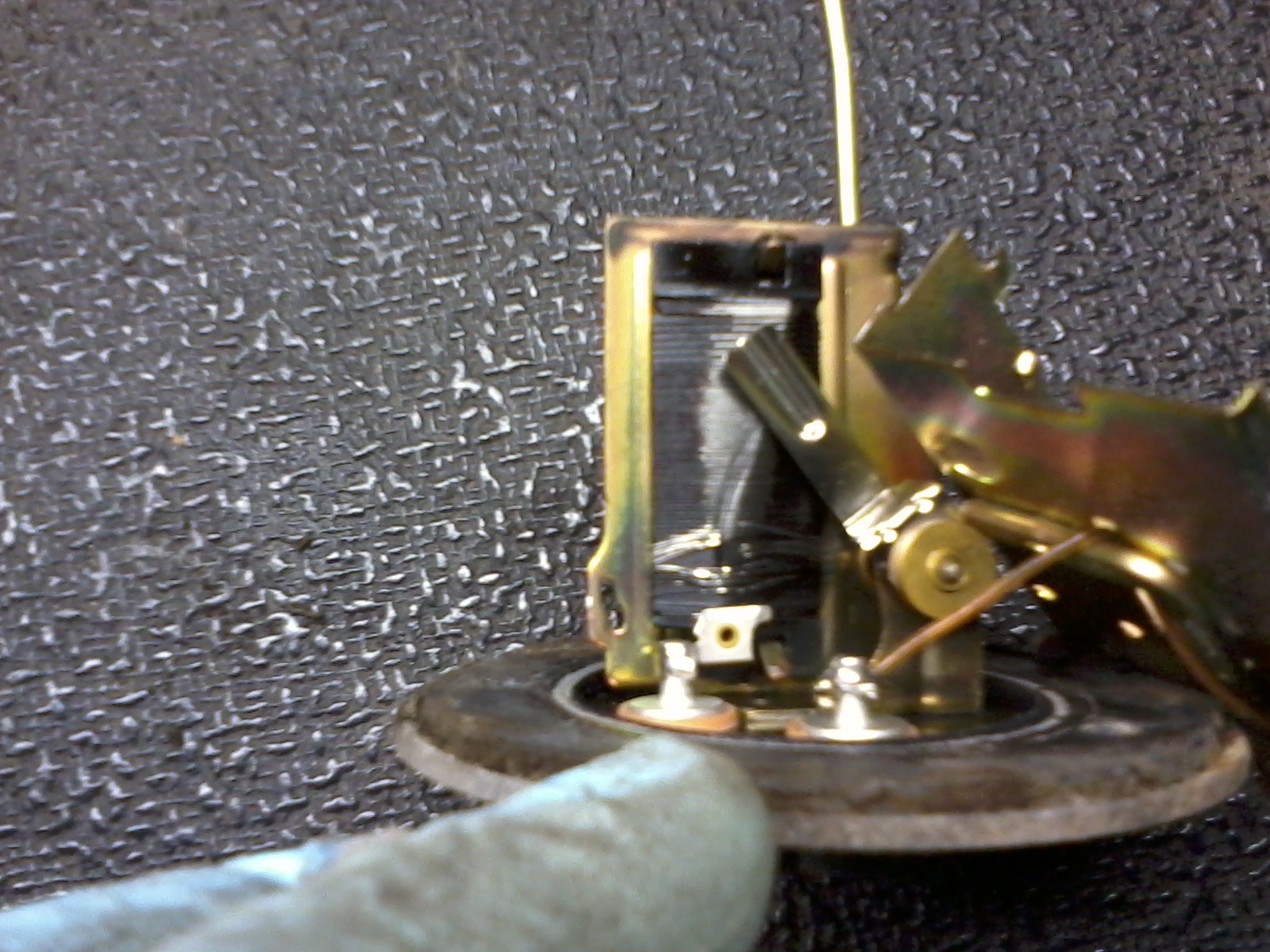

I then checked to make sure the pulsed voltage was making it to the sending unit, and it was. So I ordered a sending unit from Toyota yesterday, and it came in today. Proceeded to drop the tank tonight after work. It is not a bad job, especially with a lift and a transmission jack. I got the old sending unit out and tore the shield off of the resistor. This is what I found.
Sorry for the crappy cell phone pics.
So all was well for about 10 minutes, then the gauge dropped down to empty. So now I will have to dig back in and figure out if the float sunk or there is high resistance in the connector. I did fill it up and there was no change, but it is too darn cold, windy and wet to check it out tonight.
On the plus side the gauge was pegged at the bottom, well below E when the sending unit was broken. The fact that it is now sitting on E tells me there is high resistance somewhere, or the float gave up the ghost. Really sad if that is the case, since the part is brand new OE. But I will get in there and diag this thing tomorrow.

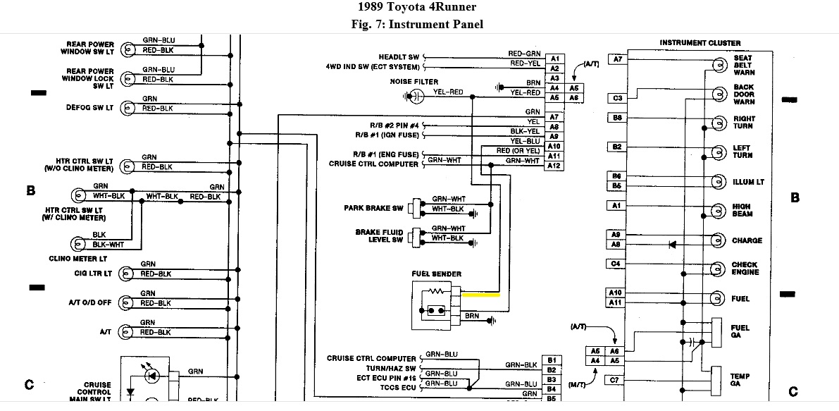

Here is the schematic:
The gauge cluster voltage regulator will pulse a voltage, this will show on a voltmeter as about 11 volts pulsed about one time per second. This voltage will pass through the gauge. The Fuel sending gauge is a variable resistor, as the resistance changes the current flowing through the gauge will increase as resistance decreases. The gauge just measures the current flow in the circuit.
Just to expand on the above instructions. The sending unit will be the flat 3 wire connector, not the round 2 wire. The round 2 wire will be for the fuel pump.
The center wire is for the fuel light, and when grounded with a test light, the lite will be bright, and the fuel light on the dash will illuminate.

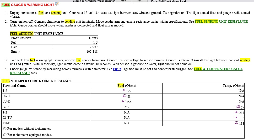

The fuel sending unit will be the Yellow-Red wire, this will be the wire sending voltage from the gauge. To measure the resistance of the sending unit, use a DVOM and measure the two outside wires in the connector going to the fuel sending unit. The resistance value should be compared to the table above.

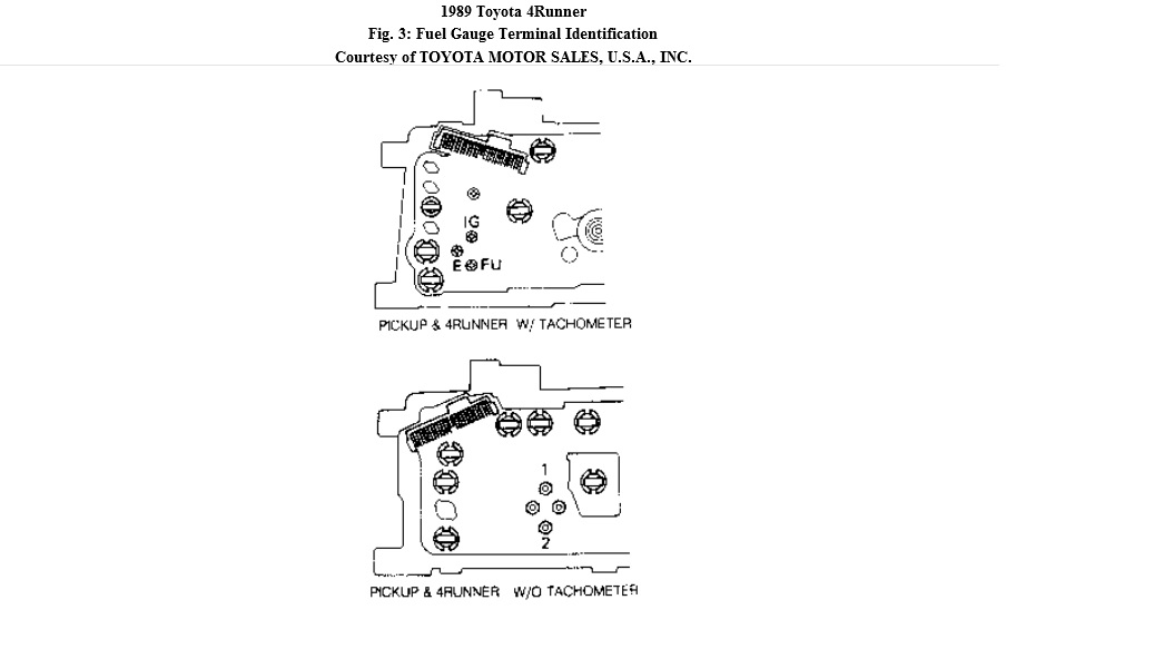

To check the resistance of the gauge:
Measure the terminals listed in the resistance chart, the pins are listed above.
