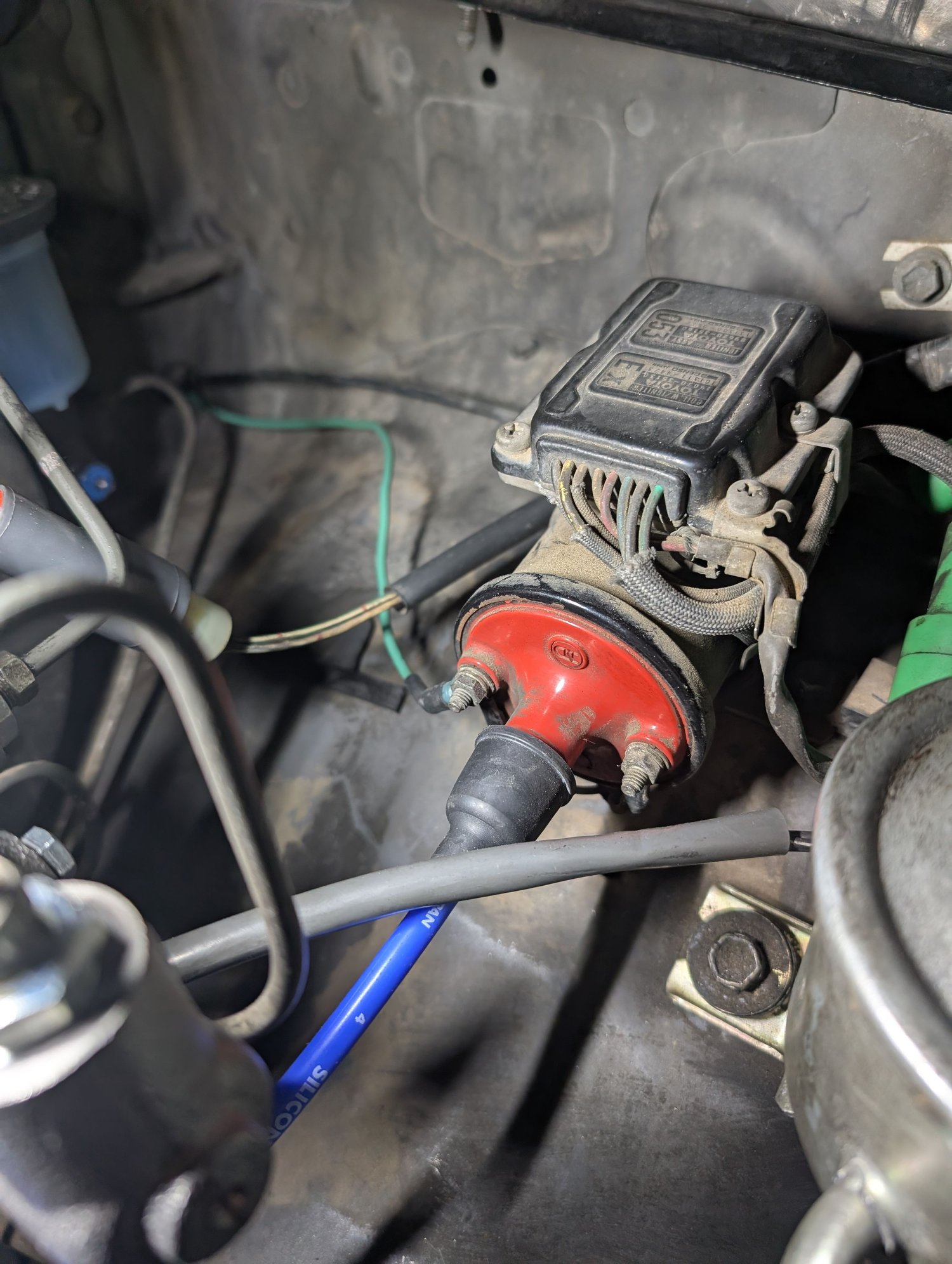

Looking to get some insight on how to correctly wire the tach. Bought a cluster from what I believe to be an 86 with a 22RE going in to my 88 4Runner 22RE. I have all my gauges working correctly except my tach and coolant temp gauge. Tach is unresponsive no matter how I wire it and I am at a loss... The temp gauge is immediately under the red line when I start the vehicle. I think I'll just end up swapping my temp gauges with my old one. My tach on the other hand (which is the whole reason I bought this cluster) I can't figure out for the life of me. Looking for someone smarter than me to help out! Thanks in advance!

I think I found a great write up on post #180 on this thread.
https://www.yotatech.com/forums/f115...00/index9.html
My tach doesn't work even wired this way. Think I may have just gotten a lemon cluster... Which brings me to my next question. Fixing/Rebuilding a tach if anyone has any knowledge on it that would be awesome.
