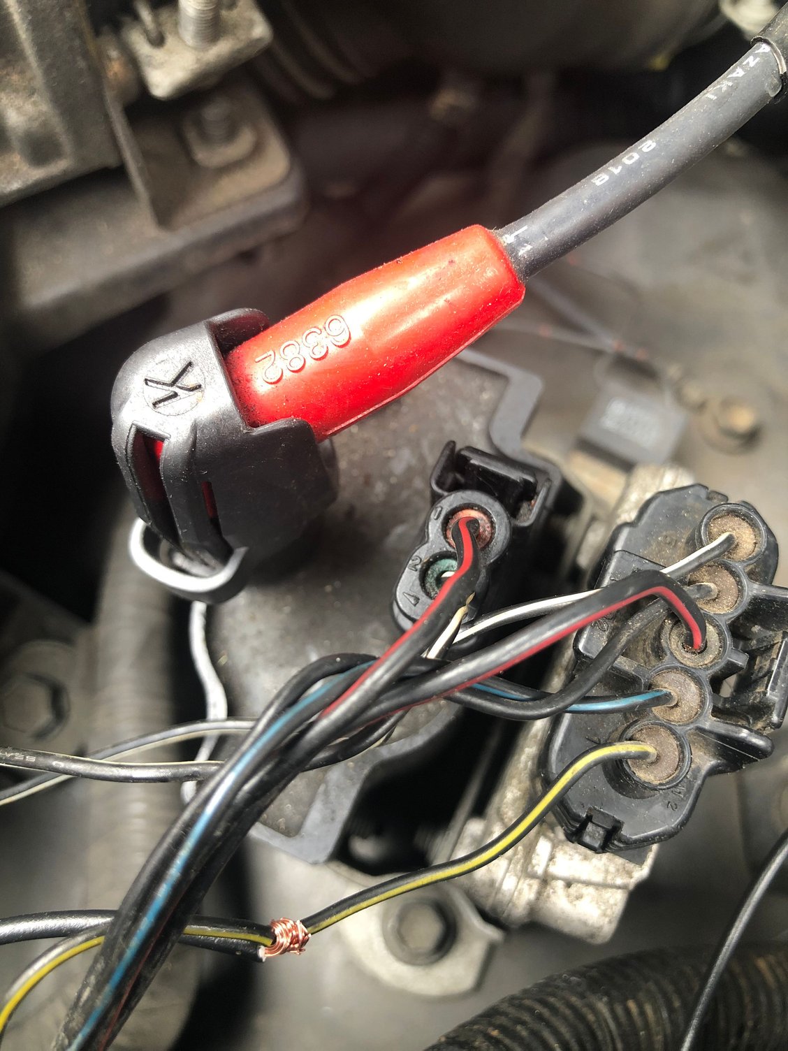

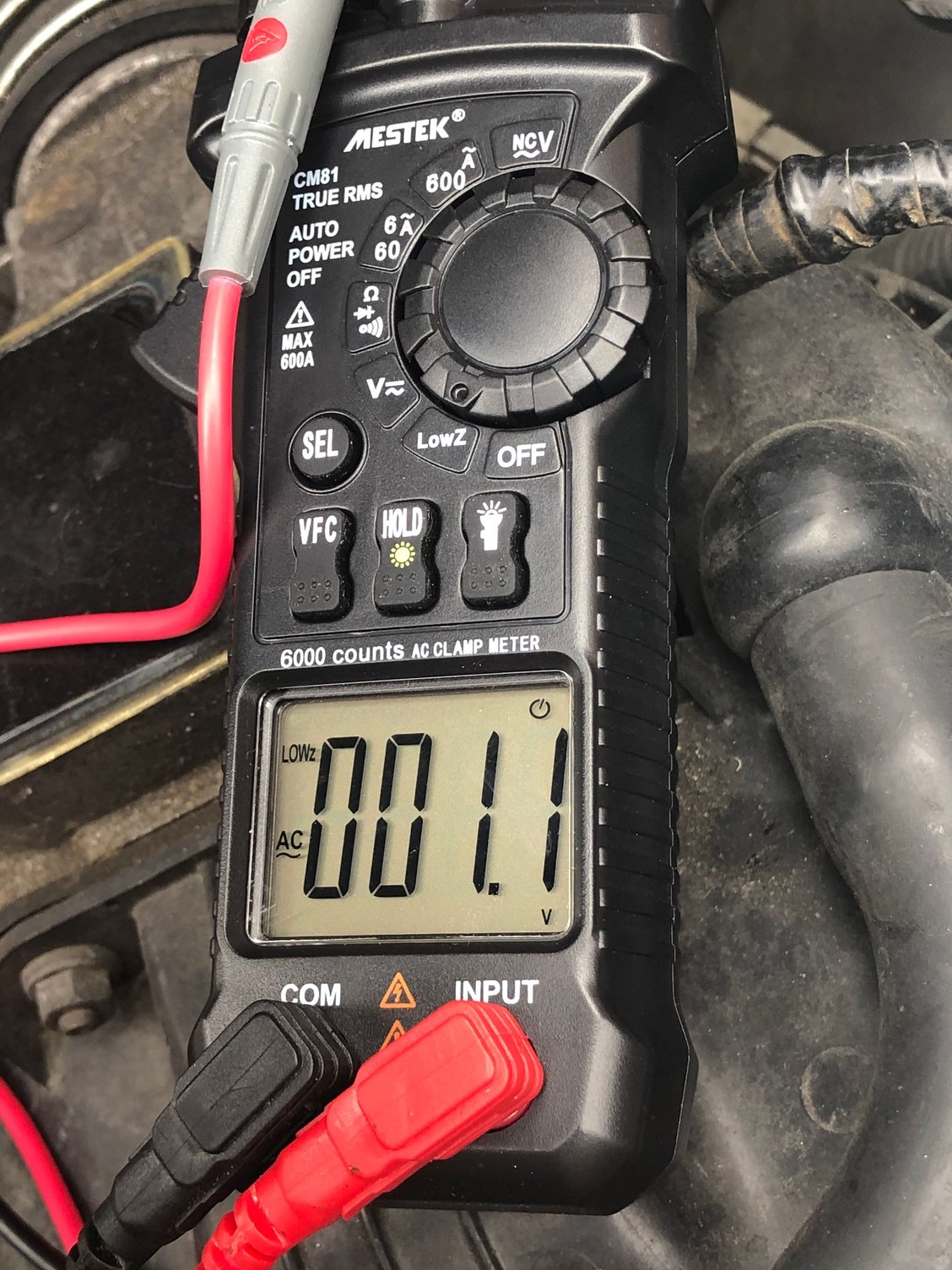

Hey folks. I just swapped my 1995 V6 3.0 cluster to an SR5 unit and the tachometer is not working at all. I ran a wire from the what I believe is the proper “yellow” distributor coil wire to the back of the gauge cluster “p” position as indicated in other posts; no movement. The voltage reading is about 1.1V. How many volts are needed to run the tachometer? Am I tapped into the proper wire on the coil? Any help with this would be much appreciated. Thanks in advance.

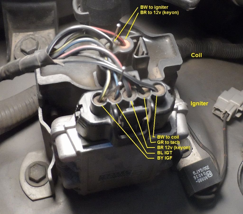

A user named “scope103” posted a picture years ago (see below) that perfectly details were to tap. My tachometer is working perfectly now. I’ll do a more detailed write up with pictures later.

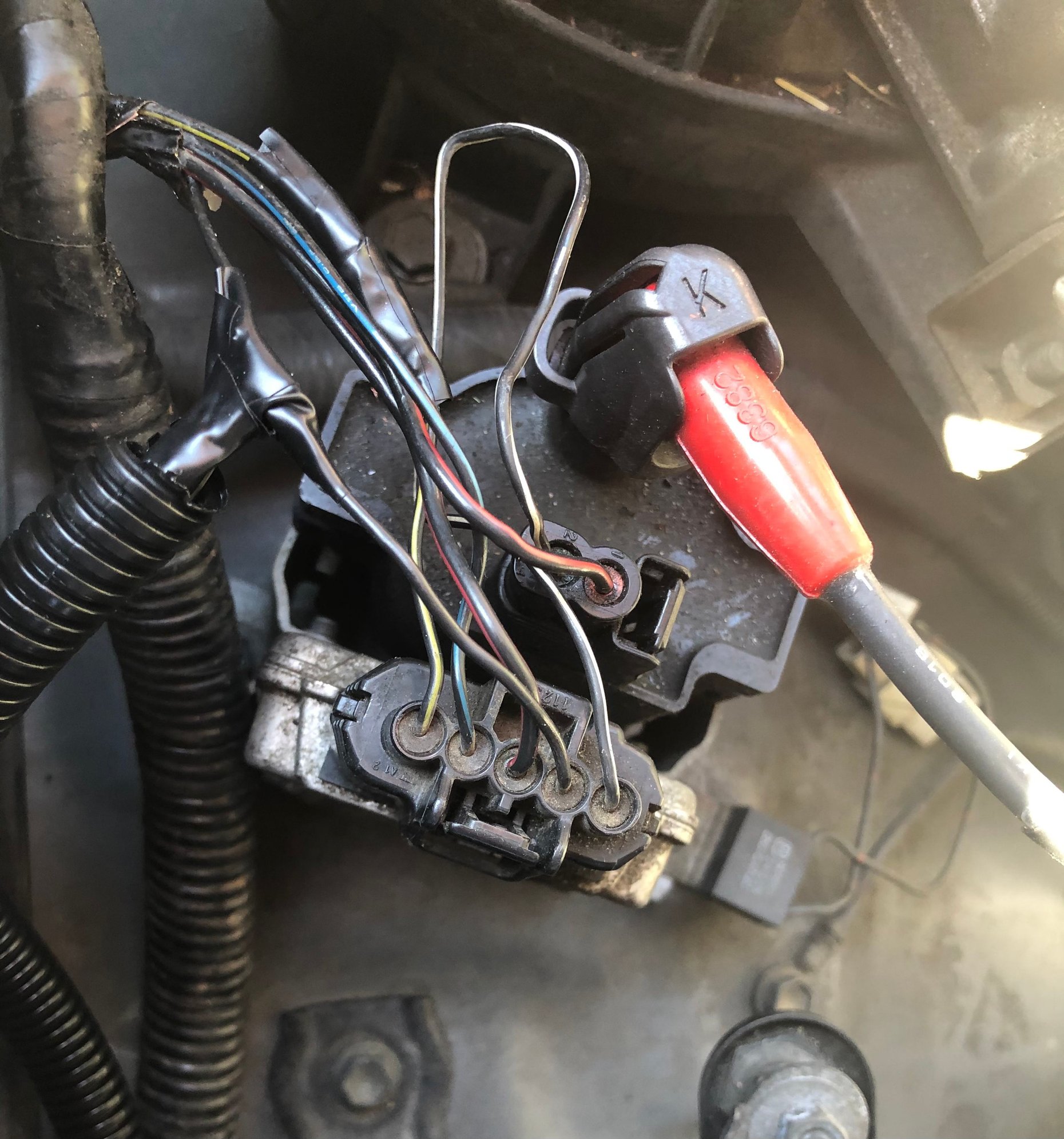

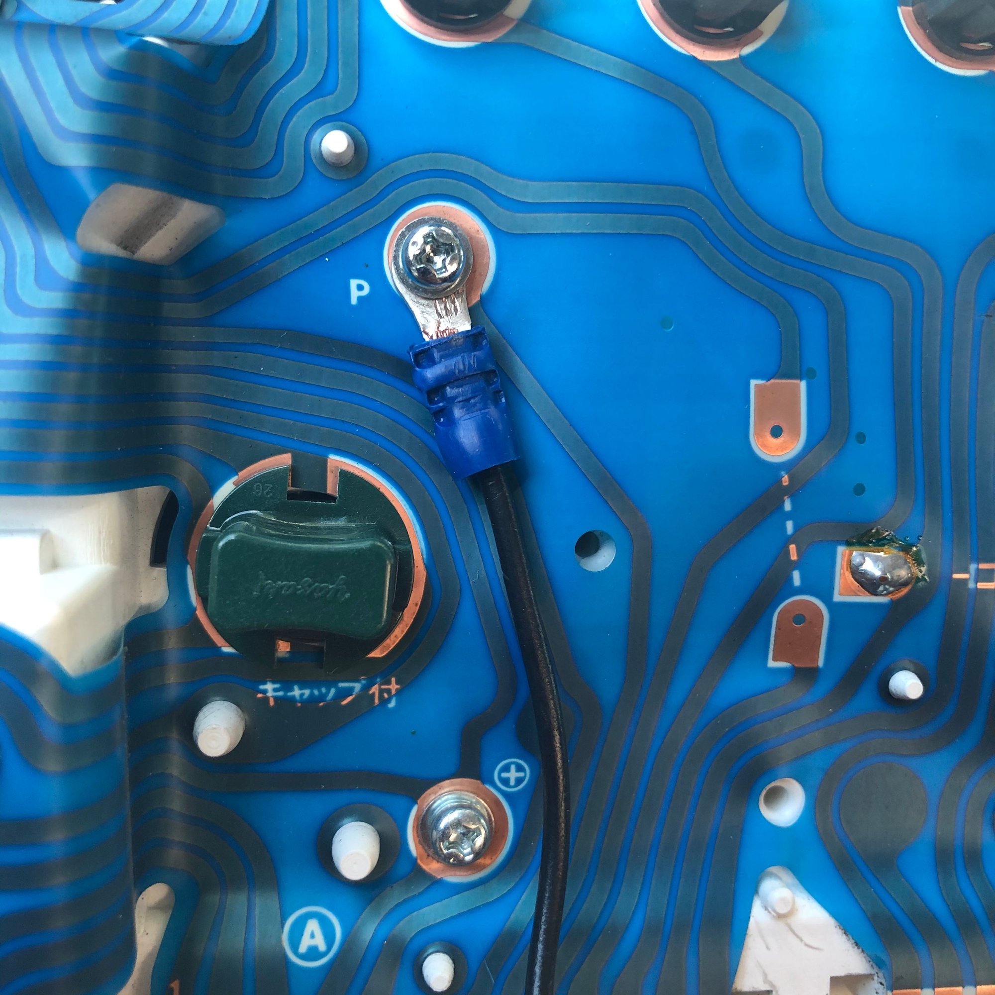

From the the distributor coil, I tapped into to the second wire from the end (the one labeled “GR to tach” in the previous picture I re-posted). If I had time, I would’ve bought quick splice t-terminals because they’re cleaner and waterproof. I had to do it the old fashioned way and solder the ends and later add wire loom. After that, I ran the 18 gauge wire to the dash cluster via the rubber grommet just below the windshield on the driver’s side. I connected to the letter “p” position behind the cluster. I used a crimped on ring connector to screw onto the cluster. I started it up and the tach worked perfectly. Perhaps tapping the yellow wire mentioned elsewhere must apply to other models, apparently not mine. For a 1995 3.0 V6, this method worked perfectly.

Side notes: Looks from the top pic like a couple of the wires have gotten crushed, or at least hot enough to soften the insulation. In the top plug, the WB wire, looks worst off. Maybe a burn-through right at the plug. The RB wire, same plug looks like it's been crushed, too, but not as bad. Same with the other plug. BR looks crushed a bit. I'm sure there are others. I would ohm them out while moving and flexing them to verify there's no chance they have problems.
I'm not one to criticize others solder jobs...well, ok, I am. Instead of a T join, I would have used a tight Y configuration. Instead of electrical tape, which will come unglued over time, you could have used some good FIT-300 heat shrink on it in the Y configuration. Keep everything that might be floating around the engine compartment...fuel, coolant, battery acid mist, etc...from getting to you solder join, and corroding it to failure.
