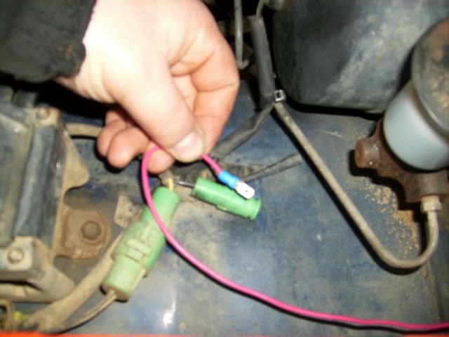

SR5 Cluster Swap 2nd gen
Hey Guys,I don't want to seem as i am hy jacking this thread but i read the whole thread start to finish and i kept seeing the tach and oil sending unit questions come up and nothing really had a direct answer for anyone so i figured i would throw in my 2 pennys and some pics on how i did the sr5 cluster swap in my 87...The model of your 84-88 toyota truck plays a huge roll in weather or not your tach is going to work when you just put your cluster in...some were wired from the factory and some were not, i am not sure how to determine that but a real simple way to tell if yours was or wasn't is to take a look at the coil...If your truck was pre wired for the tach from the factory it will not have this plug just hanging right here with nothing plugged into it,
There will be something plugged into it and you will not need to do these tach connections. You can simply throw your new cluster in and your tach will work!
These pics are from my 87 and it was not pre wired for the tach option. My truck is also a carb truck.
Now if your truck was not pre wired for a tach, Don't be fooled it is very easy to do this, it is a 1 wire connection.
Again if your truck was not pre wired from the factory that green single plug with the black wire will not be plugged into anything.
I got my cluster from a 4 cyl truck so the tach being correct is not an issue for me.
from start to finish this is about a 30 min project and well worth the effort i would say!
NOTE! Before you begin this project take a minute to reach into the pass side engine compartment and unplug the factory oil pressure sending unit wire. It is located just below the oil filter on the 20r and 22r and re motors. YOU MUST DO THIS BEFORE PLUGGING IN YOUR NEW CLUSTER!
The original oil pressure sending unit used a ground reference signal for the oil ( Idiot ) Light in the stock cluster. The reason i stress doing this first is so that you don't get caught up in the moment of your new fancy cluster and just plug it in and turn the key on FRYING your new cluster! Thats never any fun.
You will need to remove the oil pressure sending unit from the block and replace it with either the one from the donor truck you got your cluster from or you can also buy one from the local parts store for under $30. The sending unit to be removed is the one mentioned before that you unplugged your wire from just below the oil filter. When asking for this at the parts house make sure to let them know the truck is an SR5 and it uses the actual oil pressure gauge in the cluster.
Re install the new oil pressure sending unit and use a little thread sealer on the threads to ensure no leaks. And for god sakes don't over tighten it. The last thing you want is to break the threads off in your block. Just run it in till it is good and snug. You can now slip the wire that unplugged from the original sending unit back onto the new sending unit. And your done with that part!
So to begin, Simply remove your gauge bezel with the screws that retain it to the dash. remember to unplug your clutch disable switch if you have one and set your bezel off to the side. Now you can remove the 4 retaining screws that hold the gauge cluster in.
Once you have done that you will notice the cluster comes free but still feels like something is holding it in place, This is the speedometer cable holding it. Reach behind the cluster and while trying to pry your eyes back there at the same time squeeze the plastic clip that retains the cable to the cluster itself and give it a little tug, it should pop right off. If it doesn't you may need to unbolt the cable holder from the firewall to allow you a inch or so more to pull the cabe out to be able to get to the clip a little easier. Just follow the cable down to the firewall and you will see where it is bolted there by the steering colum.
Once you have your speedo cable off the cluster go ahead and unplug the 3 main harness plugs from the original cluster. Set your old cluster aside but don't toss it! It has lots of good spare bulbs and what not it in haha! I'm a pack rat and like to hang onto that kinda stuff

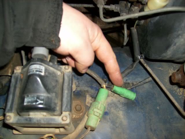

Now you will need to run a new wire from behind the cluster area out into the engine bay to make your tach connection.
I suggest using a 14 or 16 gauge wire for this. I choose to run my new wire threw the hood latch cable gromet in the firewall next to the brake booster, This worked out great because it is about 6 inches from where your connection is going to be made under the hood.
Once you have your wire ran you can now make your connection under the hood, I used a single Male connector,

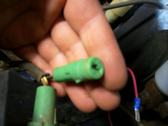

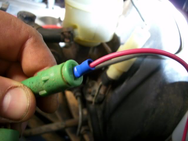

The green Plug under the hood has a female connector inside of it
Simply plug your male connector into the green female connector like so
And your done with your tach connection under the hood.

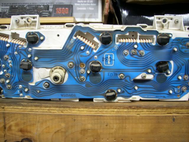

Now on the back of your gauge cluster there is 2 ways to make your tach connection. You can either use the #6 wire that comes out of the stock harness and tap your wire into
Or you can make a direct connection on the screw itself.

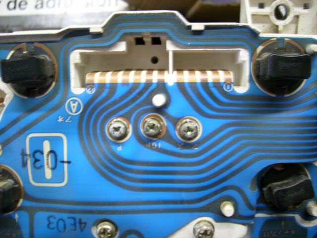

the back of your cluster should look something like this
See the 3 screws just below where 1 of the harness plugs plug in?
This is where your going to make your tach connection.
The 3 Screws are labled :
#1 P
#2 IGN +
# 3 some jap symbol lol ( This is The ground - )
You will not need to supply a postive + Or Ground - connection as they will allready be supplied.
However the ( P ) is your tach input signal source.
Use a eye connector on your wire you installed earlier.
Now remove the screw with the ( P ) under it as shown
slide your screw in the eye connector and re install the screw.
And thats it for your tach connection.

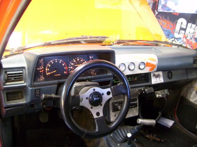

And thats it!
You can now enjoy the perks of a factory syle Gauge cluster with a tach!

So verifying that everything works you can go ahead and plug your speedo cable back in and re install the cluster and bezel in the opposite order you removed them.
And thats it!
