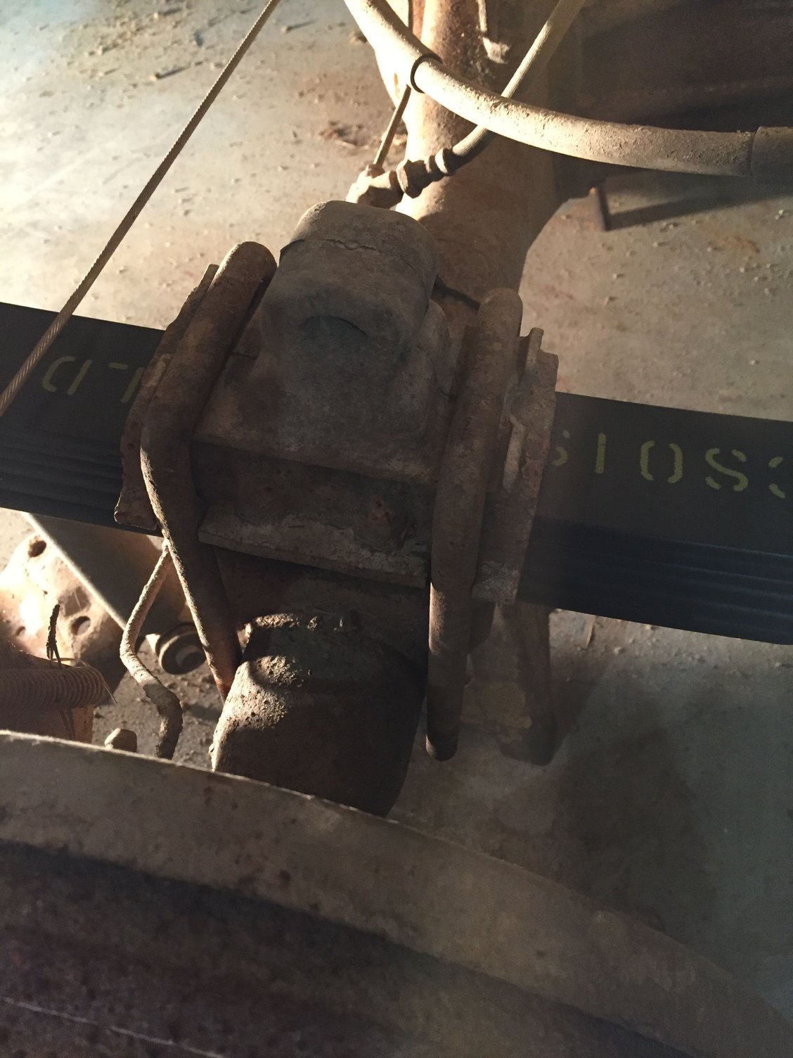

Im needing to get a new set of springs to be able to haul my boat easier as you can see from the pic! I can sit on the tailgate and just about get on the overload. I was looking at the CS020R but im not sure i need that much spring, but this boat is a big pig. All i have in the front is spacers and its sitting at roughly 24” center axle to fender and rear is roughly 22.5.
Any input on what to go with would be appreciated.
Well here they are installed. I will get hooked up and see what it does in a day or so. Rear is sitting 1” higher than the front right now with just a single 3 mile trip

Tried to remove the clamshell but ran into more problems. Not sure what im going to do at this point but ive got it together for the time being.
Spring perch is roughly 3-1/16 wide and springs are roughly 2-3/8 wide.
Bushings i made were .849 od x .550 id x .510 h
