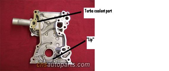

Hopefully someone that has both might be able to shine some light on this:
When my timing chain broke it ripped off the "lip" the runs underneight the crankshaft hole on the timing cover, so I think I'll need to replace it.
Sadly I can't seem to find an aftermarket turbo timing cover, so I'm hoping to use a regular one. I though the difference was the coolant passage on the back side(by the main outlet). But I've found pictures that have this port on non-turbos.
Can anyone shed some light on this?

The only difference that I know of is the way the oil pump relief hole is in the timing cover. Either will work. The water cooling port is the same turbo/non-turbo, but the thing that bolts on to that port in terms of water line is different.
I believe John's foreign engine's carries the turbo cover:
http://www.22re.com/
You should match the oil pump to the timing cover (turbo vs non-turbo). If you don't, it's not the end of the world and will function.

Cool, that's what I wanted to hear.
I need to order some stuff from Ted, so I guess this is getting tacked onto the order($130 from the other place is a tad more than I'd like). I've still got my stock coolant line plate, so that won't be an issue. I'm running an oil pump from Ted already, and it's not a "true" turbo pump, so I think it should work well together.
