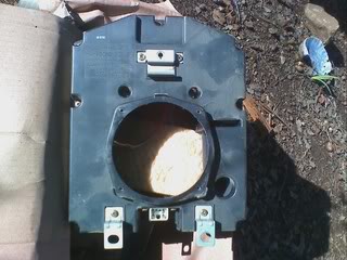

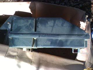

Speakers in Rear
Ok, so I figured out the rear speaker situation. I ended up modifying the rear boxes to accept a 5.25" speaker. I did this a few months back(November), but I didn't bother to take any picures, but I was digging through storage, and found two of the factory speaker boxes, so I figured since it was SOO easy to do, that I'd take some pics and let you know how to do it. This is a great beginner's upgrade, or budget upgrade, or starting point, because it doesn't take any mechanical knowledge, other than how to saw and file.
This is the line where I sawwed off the excess from the side (NOTE: Remove anything that is screwed onto the box around where you are working before you start cutting)
This is what it would look like when the sawwing was done
Now this is another view, from the front. This is for referance
This is with the center blacked out, no cutting yet.
This is approximately what it would look like after completing the sawing, and filing.
After you get done sawing, you will want to file away the excess plastic, so you have a mostly smooth area surrounding the speaker. Vacuum or blow out the plastic "dust" and find your self a 5.25" speaker to install. If you find that there are "high spots" along the inner circle(the part that you were filing), and your speaker doesn't fit, just mark those with white out, or a sharpie, and file them down so your speaker will fit. This mod is free, assuming you have a course file, a saw of some sort, a sharpie(or whiteout) a 5.25" speaker, and about 20 minutes start to finish once you get those damn back panels off. If you have any questions, just ask.
