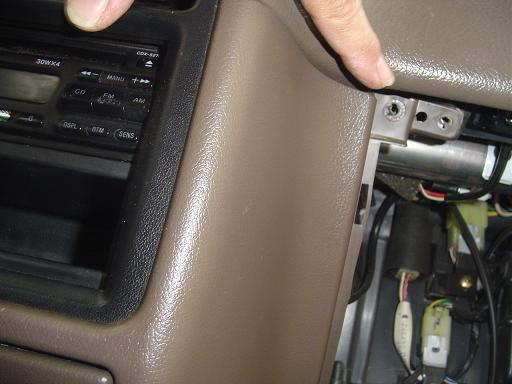

This is the bolt you need to take off after you remove the left side (under steering wheel), the glove box and the lower center console. The center section will be held on by snap clips. Remove the AC dial/slide tabs and pull the center section.
You now have access to the radio's four screws that hold it on. Below shows the stock connectors that you should get an adapter to plug right in so you don't have to hack into your harness.

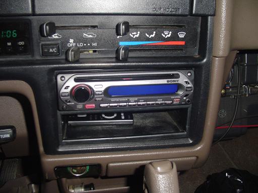

This is the new HU installed and the center console replaced. It comes out just a little, but the outer edge of the deck's front face pops off and it fits snug right in the center console.

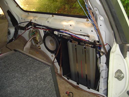

In the back, I did not want to lose my rear cargo area, but I wanted to be able to put in subs. I did not want to bolt my amps to the back of the rear seats like others had and the amps were too big go under the front seats. So I came up with this.

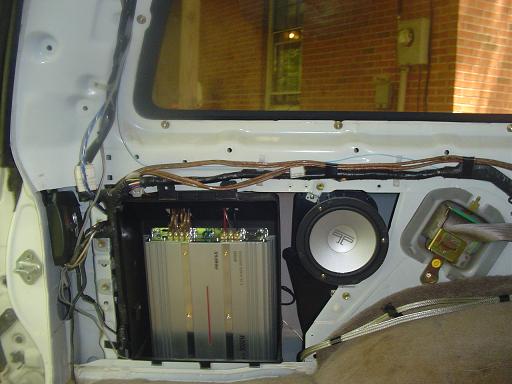

I installed my two amps in the rear boxes behind the rear access panels. I took out the entire rear panels so if anyone has questions about that I have experience. It is pretty easy.
Here is my 4 channel amp installed and wired. I cut holes in the top and bottom to run the power and speaker wires. On the right, you will see the DB6500 woofer.

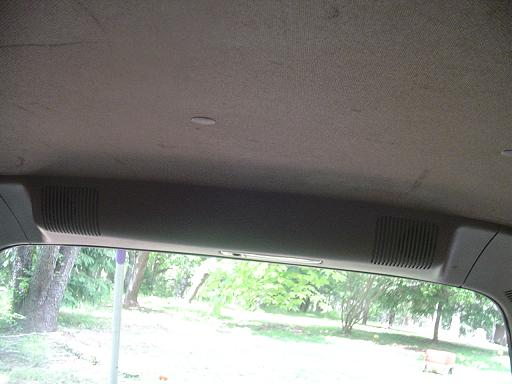

These are the tweeters in the rear of the cargo area.

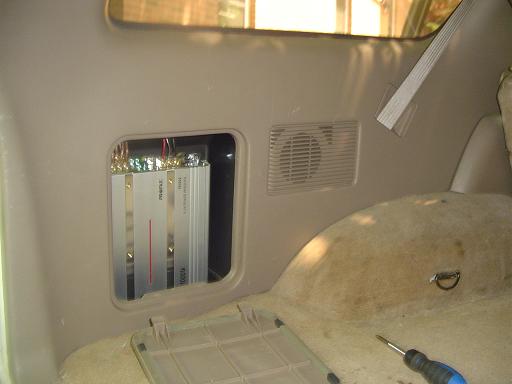

Well, here are shots of the completed rear cargo area. It seems to work well. If you look at the right rear panel, you will see the sub's wires coming out to hook into the subs. This is all that is taking up the rear cargo area. I can unhook the subs, tie off the connections to prevent shorts and have full use of the rear cargo space.
4 channel amp exposed.
right rear panel, completed. notice the sub speaker wires coming out.
The rear tweeters w/ cover. All speakers were in stock locations and my goal of having the appearance of everything looking stock, except for the HU and a box of subs in the back.
