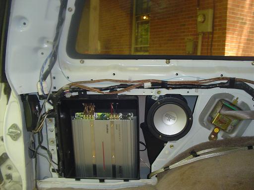

In the back, I did not want to lose my rear cargo area, but I wanted to be able to put in subs. I did not want to bolt my amps to the back of the rear seats like others had and the amps were too big go under the front seats. So I came up with this.
I installed my two amps in the rear boxes behind the rear access panels. I took out the entire rear panels so if anyone has questions about that I have experience. It is pretty easy.
Here is my 4 channel amp installed and wired. I cut holes in the top and bottom to run the power and speaker wires. On the right, you will see the DB6500 woofer.
Attachment 67185
Here is the sub amp on the right side of the car. It too has only big enough holes for the wires to fit through. The sub's wires come through the bottom of the panel and that is all.
Attachment 67187

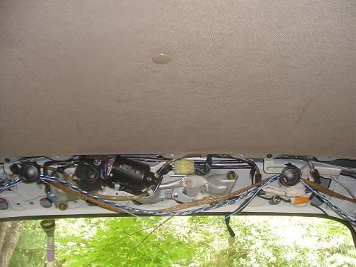

These are the tweeters in the rear of the cargo area.
Attachment 67186
