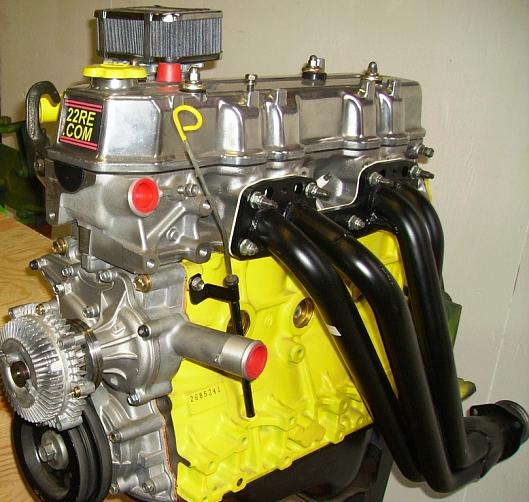

(2) colors I did last week!!

I never will understand the neon-green trend just not a big fan of it I guess...
to each their own; it's not like it looks horrible, but I wouldn't use the color on my truck, lol
I'm old school I guess... red, blue, or black... oh and chrome

I am not a big fan of the green but the yellow looks good but would look better with some red on the front and a bit more black
