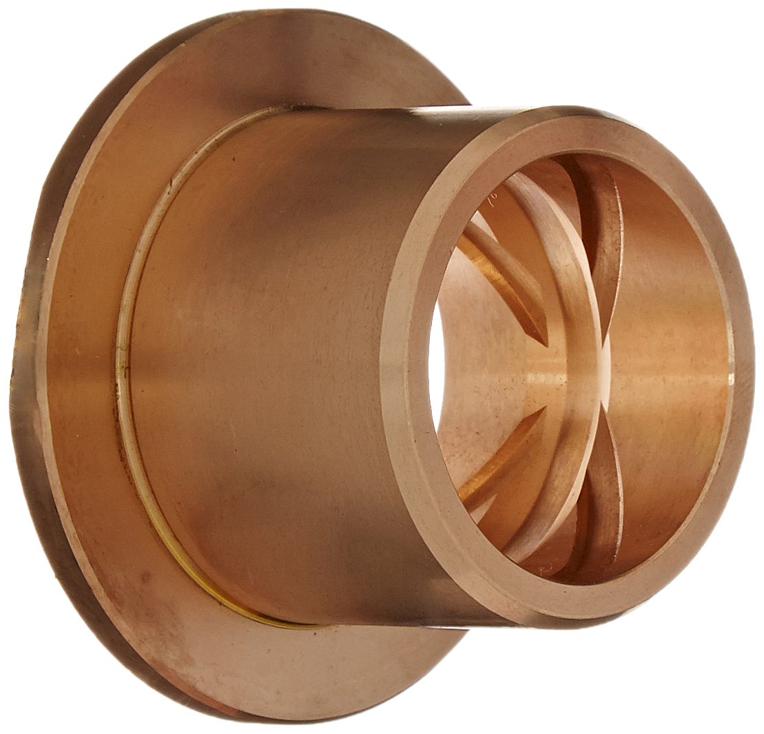

Excellent thanks for the info. I've been doing a bunch of research and am finding conflicting info. Are there two brass bushings per side on the IFS trucks? An inner bushing and outer bushing? Do the brass bushings from 1985 and prior solid axle trucks fit the IFS trucks? What product should I use to lubricate them before installing the new CV halfshaft? If anyone has any answers it would be of tremendous help to me! Thanks!

I have come across this which is expensive: http://www.lceperformance.com/1986-1...-p/1054128.htm
And also this, but which only pictures one bushing. From the picture it looks like it's the inner bushing and seal. If I could just find the outer bushing then this would be the best bet on price.

The pic below shows the outer bushing and the outer seal. The inner seal is on the CV axle.
The inner bushing is shown on the bottom of the same page.

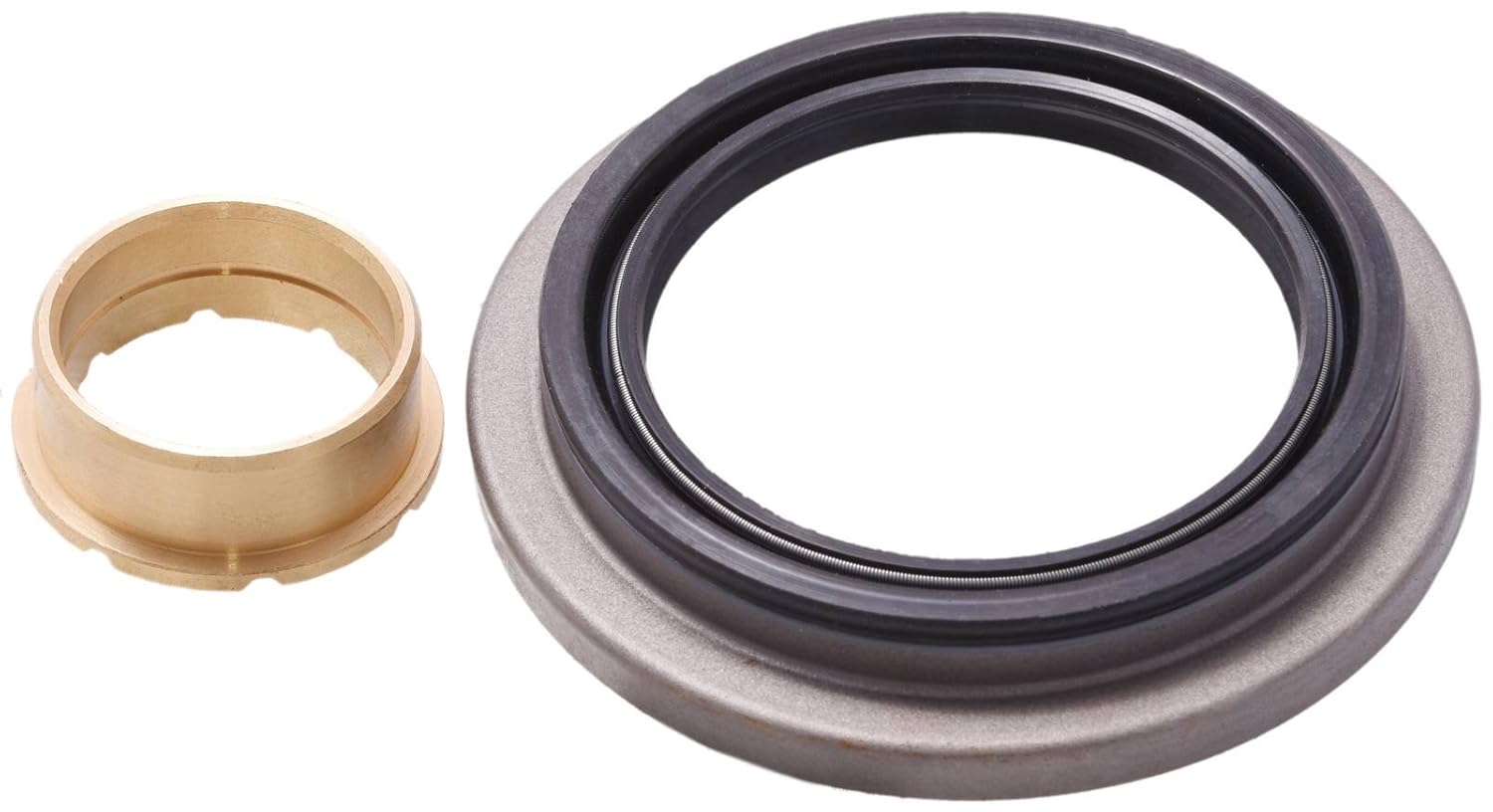

irv's Avatar
irv
Joined: Dec 2011
Posts: 250
So I've bought all new wheel bearings, brass bushings, cv shafts and seals. The smallest rubber seal, orange colored seal and the seal directly above the orange colored seal all came in the Marlin Crawler wheel bearing kit. But I don't see a spot on my truck for either the small rubber seal or orange seal. They don't seem to exist on my truck unless I'm somehow overlooking them. The large seal in the picture directly above the smallest rubber seal came with the brass bushings and I clearly see a home for it on the truck. But as far as the other two, I can't figure out why I have them. I'm only seeing installation spots for two of these four seals on my truck. 4x4 1986. What gives?
Also, does anyone have a part number or name for this large seal? It is from behind the rotor, attached to the steering knuckle.
Old Apr 20, 2016 | 12:50 PM
MudHippy's Avatar
Joined: Jan 2007
Posts: 6,106
Likes: 27
I don't know about the first question. But the answer to the last question is Type K Oil Seal 90313-93002.
