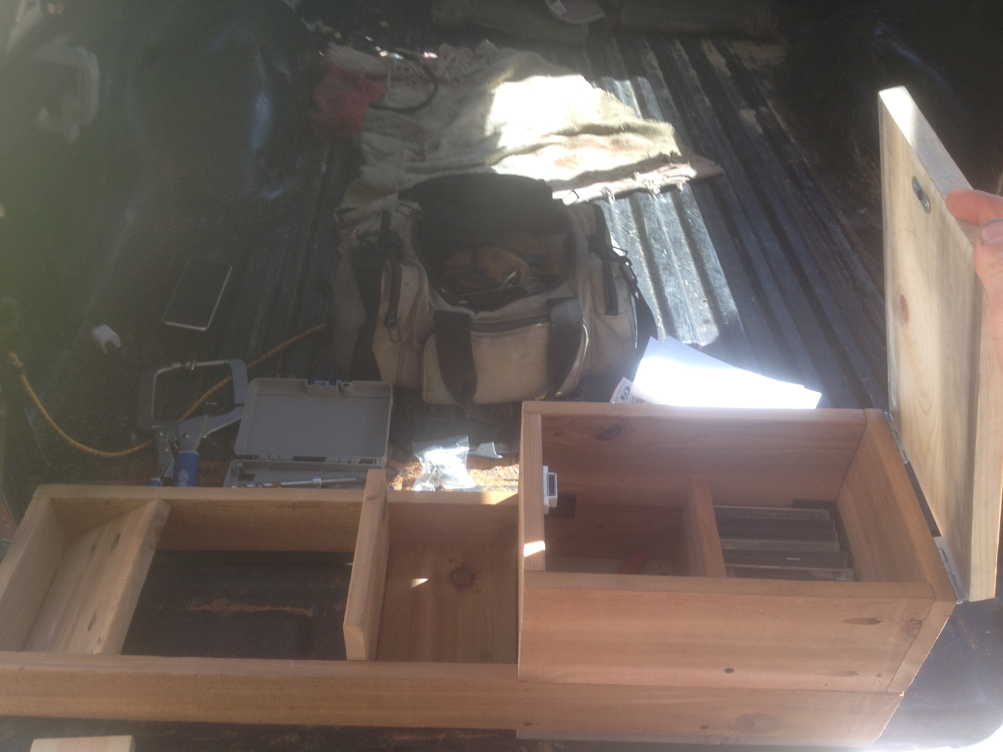

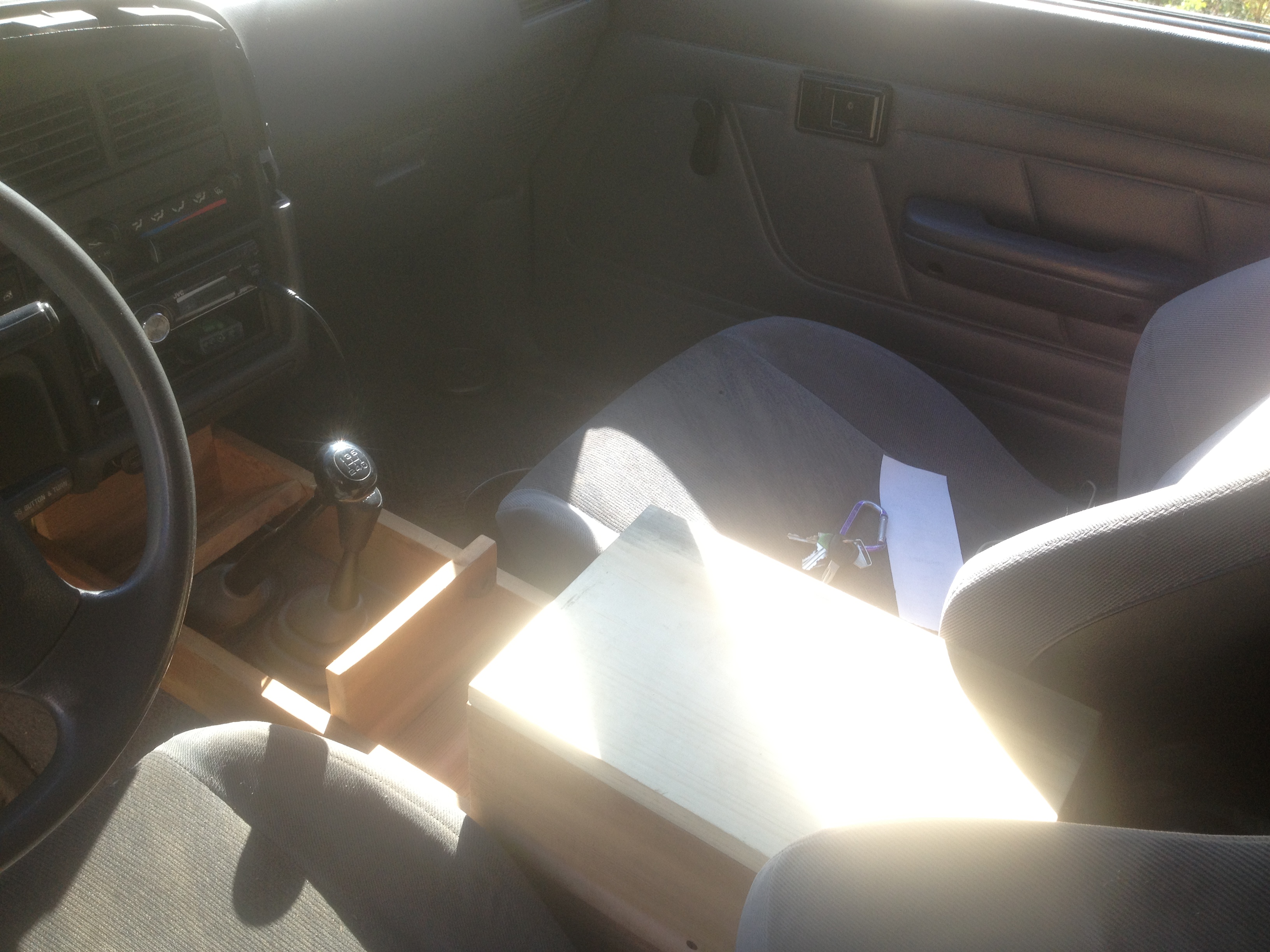

Smile Acura seats w/ custom console
I just recently added this console this past weekend to fill the space made with the buckets. I didn't want to do the runner console, and I think this looks fine. I bought a darker stain, but really enjoy the smell of the cedar and don't think it looks that bad. I used a pocket hole jig as much as possible to make things look cleaner. It is fastened with nothing, but I cut to fit snugly between the seat rails, and you wouldn't be able to tell if you tried because It only goes in one way and is very firmly held in place. PM if you want specific measurements, but they likely would be different from that of sr5 seats, I just guessed and checked; yall are very capable. I found a cabinet magnet to keep the hinged top from rattling. Lumber, screws, hinges + 1 hour of my time=15.
I am likely going to pad the arm rest and cover with fabric to match interior. Let me know your thoughts on how to improve!

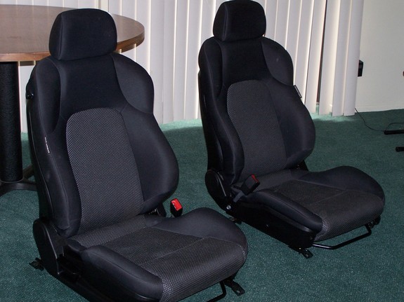

The cloth version seats out of a 3000GT are really comfy and 3 of the 4 bolts lined up in my 85. I wish I would have kept them cause they were soft and fit my back just right. Right now I'm using Hyundai Tiburon seats, only two bolts lined up and I had to fab the rest. They are also quite stiff and not as soft as I would like. They look nice though.
