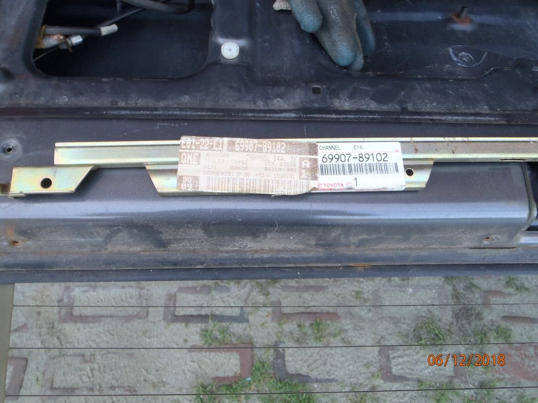

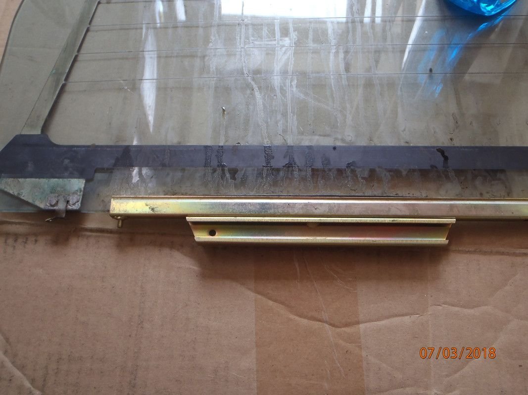

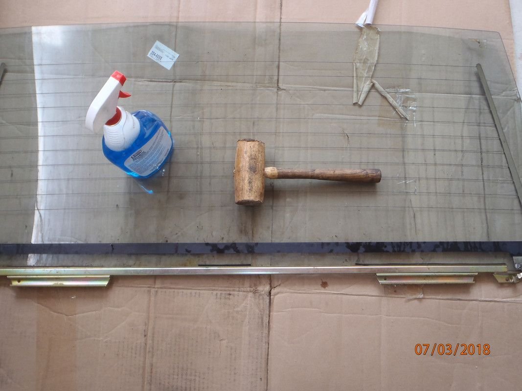

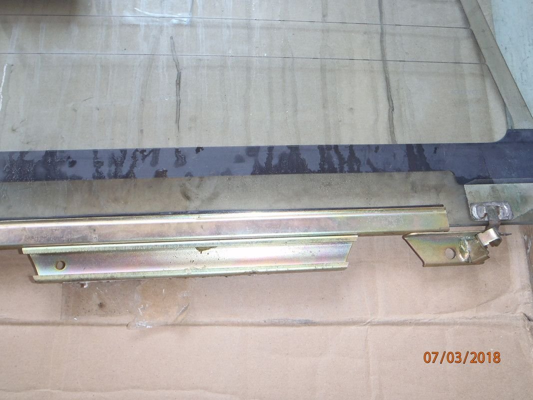

you also need to remove the weatherstrip/wipers from the inside and outside lip of the tailgate where the window passes through, because the bottom track won't pass through the gap with them installed. i've got a maintennance thread over on t4r.org that shows some of the process i used to install a new track on the bottom of a window.
note that the glass is extended more than half-way out the tailgate in prep to remove it (almost all the way out)
only tools needed to install the new track
