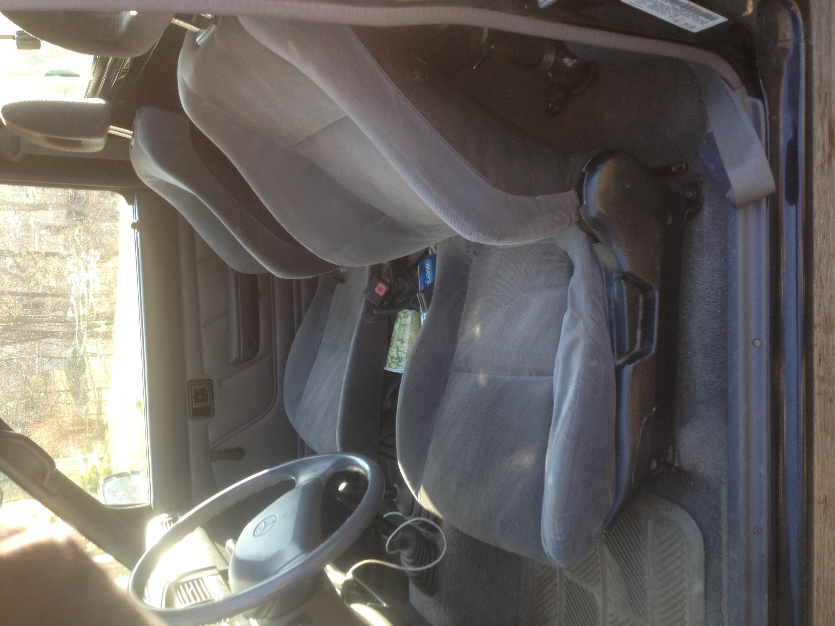

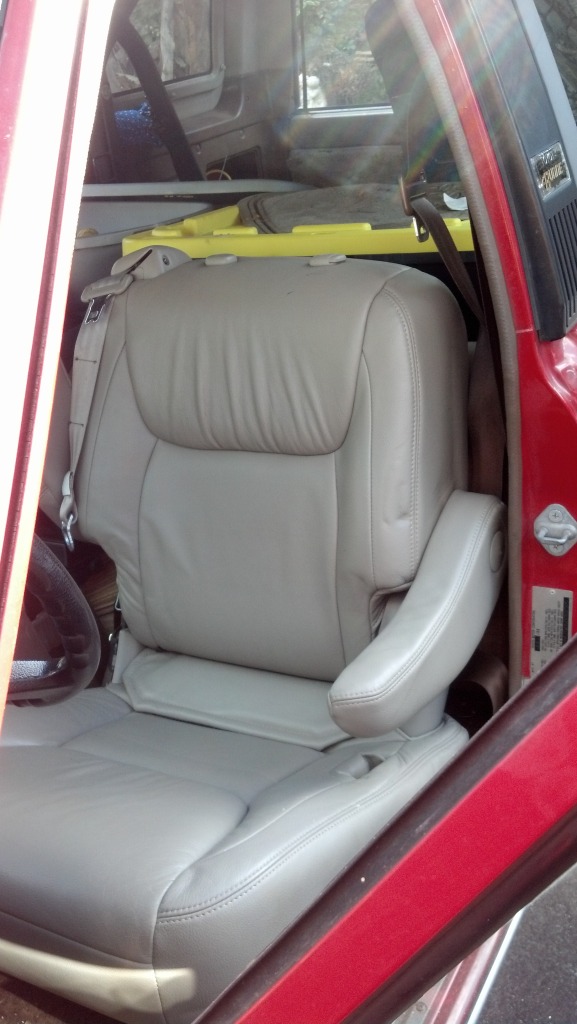

I swapped in a 2nd row fold up leather captain's chair from a toyota sienna that I picked up cheap.
Ditched the sliders b/c those were far too difficult to attach and would have made the seat too high
super comf

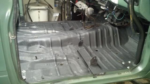

I made my own base from some 1/8"x2" flat stock. bolted the seat to the base, bolted base to the floor. Fixed position seat. Removed the rear fold bench seat while I was at it.
super comf

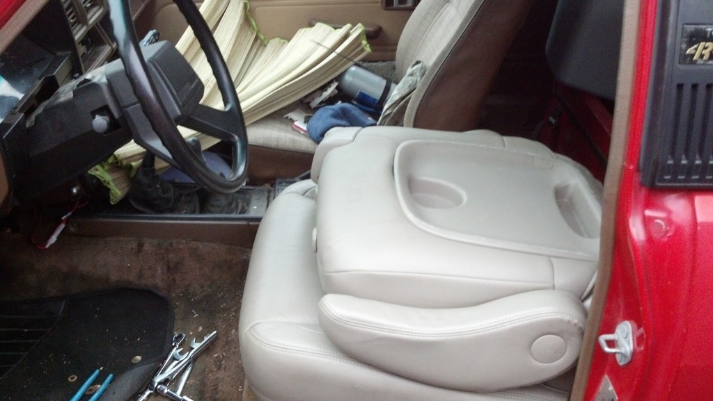

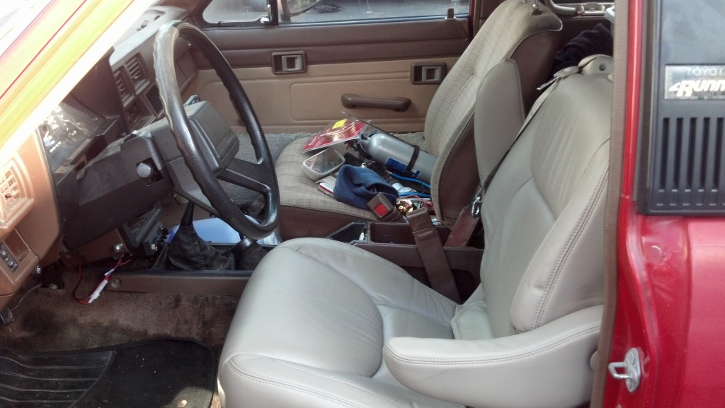

It wasn't too bad. Picked up the seats for $75 on craigslist. They had all the electric seat motors underneath that had to be removed. The dimentions of the actual seat was not that far off from the factory buckets, at least in the hieght. Once the motors were removed it lowered the hieght by 4". Then I just cut some wire channel and bolted my factory seat mounts to the aftermarket seats. If I had the motivation I could still wire up the lumbar controls, and there may be a seat heater in there too... but aint nobody got time for that.
Been riding happy ever since!

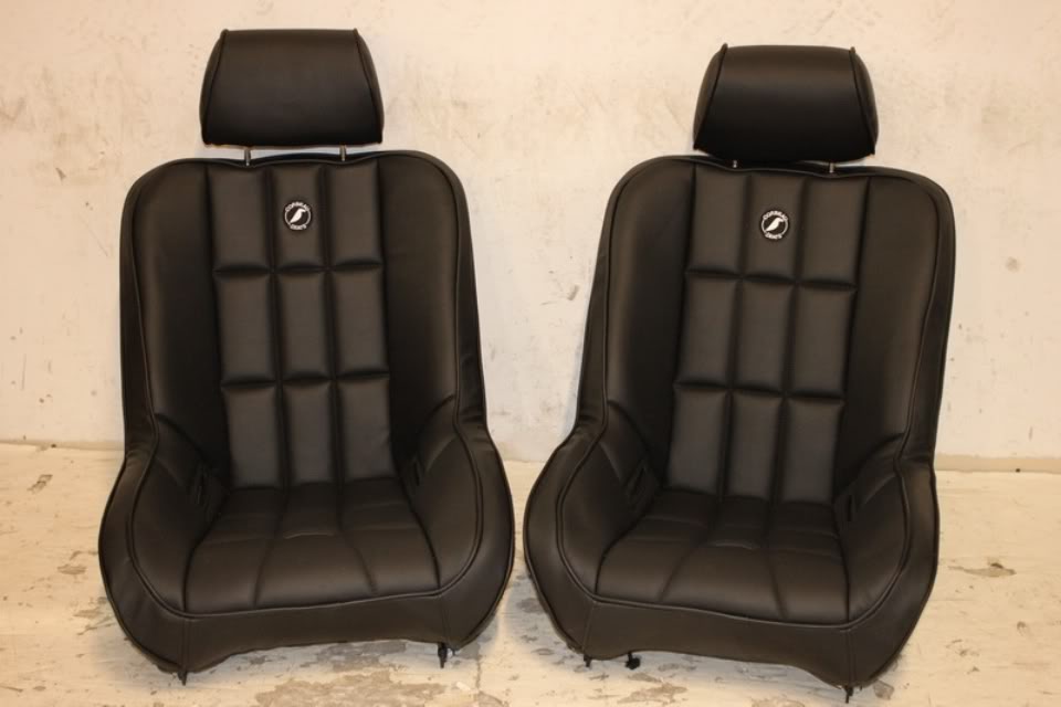

Corbeau Sport Seats.
Bought these a few months back and they feel just like stock. You gotta get the Corbeau seat brackets for them to go into your rig though. The brackets also need to be customized to fit right. I was pissed because they didnt line up but a body shop took care of that. The brackets sit too high though I need to get them cut down by about an inch or so.

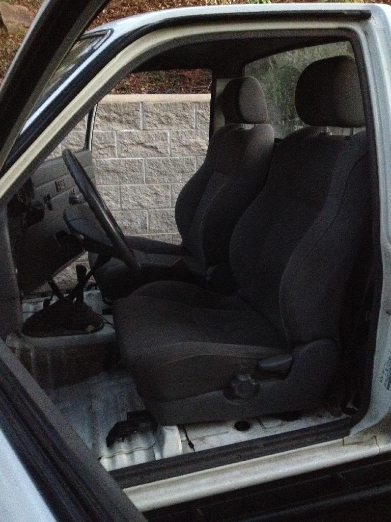

It's pure BS. C22046L and C22046R did not fit my 93 SR5 pickup. After this pic I had the brackets cut down to as low as they could go and I still sat way too high. I also gotta take back the " just like stock " statement. Not long after I was miserable again.

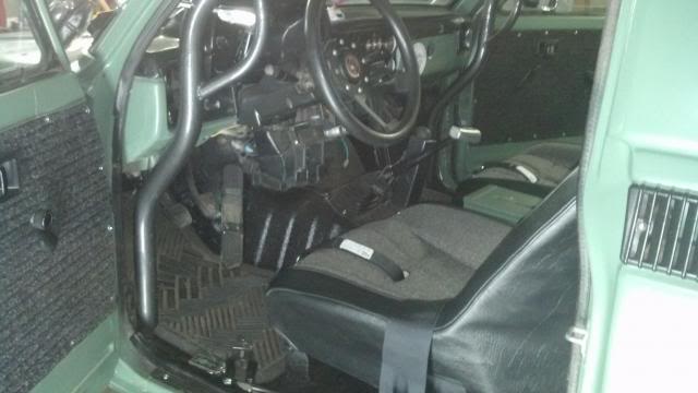

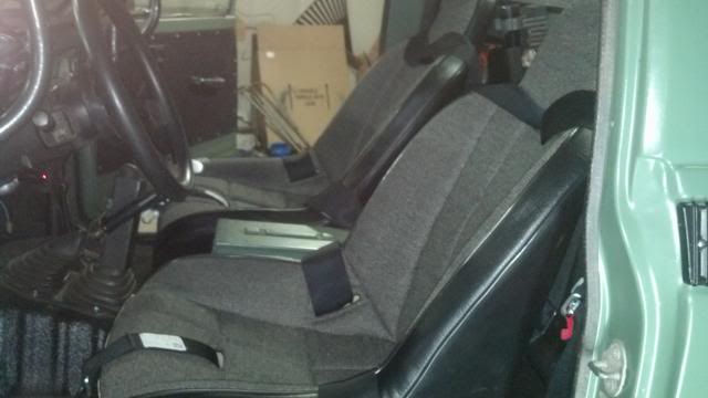

These were from a 95 Acura Integra. Swapped rear outer footings and made a spacer for rear inner. Just got integra buckles so I can use the slick little bolt on receivers as well(i'll post more on that later when I finish).
